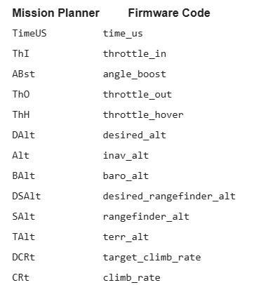

Surface track vl53l0
my setting:
RNGFND1_ADDR=41
RNGFND1_TYPE=16 //VL53L0
RNGFND1_ORIENT = 25 //DOWN
RNGFND1_MIN_CM = 20
RNGFND1_MAX_CM = 180
RNGFND1_GNDCLEAR = 10
SURFTRAK_MODE = 1 //ground
RC6_OPTION=75
SURFTRAK_TC=1
I have moved rc6 duting the flight to start surface tracking.
in my log DSAlt and DAlt were not updated or are in total different scale. do you have any explanation what do I need to do?
adding a link to my log:
