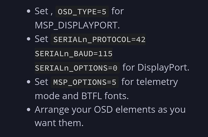

https://notes.stavros.io/ardupilot/dji-fpv-configuration/
These setting worked exactly as in the screen shot.
If after all this and it still doesn’t work make sure you are using the correct serial port . If the serial port is correct and it still doesn’t work, some of the reading says to change to a different serial because of conflicts. Try that.
