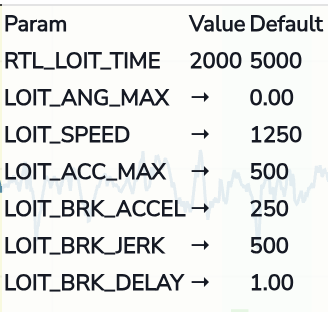

On my quadcopter, I get a sharp jerk every time I switch from AUTO mission to LOITER in flight. AUTO itself is smooth and LOITER is stable when entered from other modes, but the AUTO β†’ LOITER transition always causes a noticeable jerk to hold its position, then it hovers normally.
Could this be due to a tuning/parameter issue? Which parameters should I focus on to smooth this handover (e.g. LOIT_* / WPNAV_* / ATC_* limits)? Any log signals you recommend checking around the mode change would also help.

What you’re probably seeing is aggressive braking behavior. Have a look at the LOITER_BRK parameters.

with the loiter parameters set as:
Could you please have a look at the log and these settings and suggest what LOIT_BRK (and maybe WPNAV) values I should reduce or adjust for a smoother transition on a 2kg platform, without making LOITER too β€œsoft”?. LOIT_BRK_JERK is set at the lowest (500) according to ardupilot.
