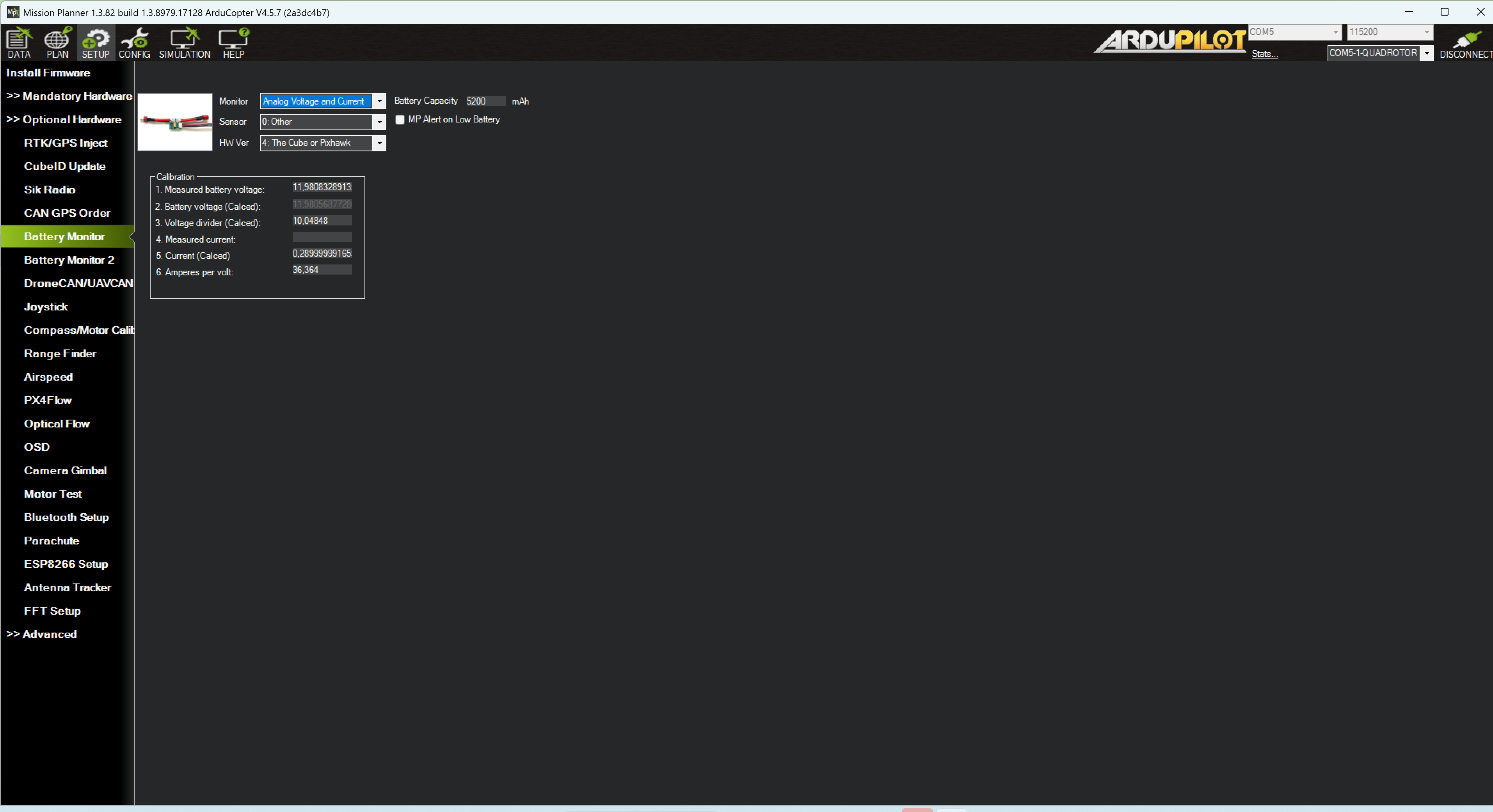

I’m not even sure I have indicated the correct data for Sensor and HW version:
  • Sensor is set to 0 for “Other” (it’s not branded) (picture below)
  • 4 for Pixhawk. I doubt this one most: there’s also 0:CUAV V5/Pixhawk4 or APM1), 3: PX4, 4: The Cube or Pixhawk and 10: 10: Pixhawk 6C/Pix32 v6.

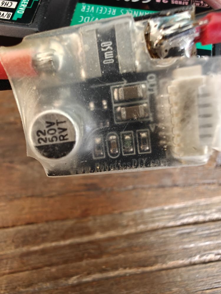

Yes, it only works if you configure it correctly. And you can only configure it correctly without trial and error if you know which components you have and how they are connected to each other.

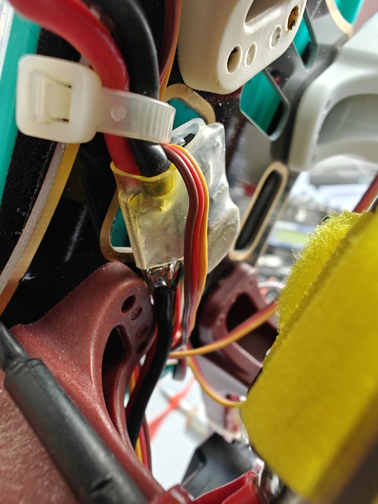

Posting pictures will help a lot.
Detailed pictures where the battery monitor board details are clearly visible.

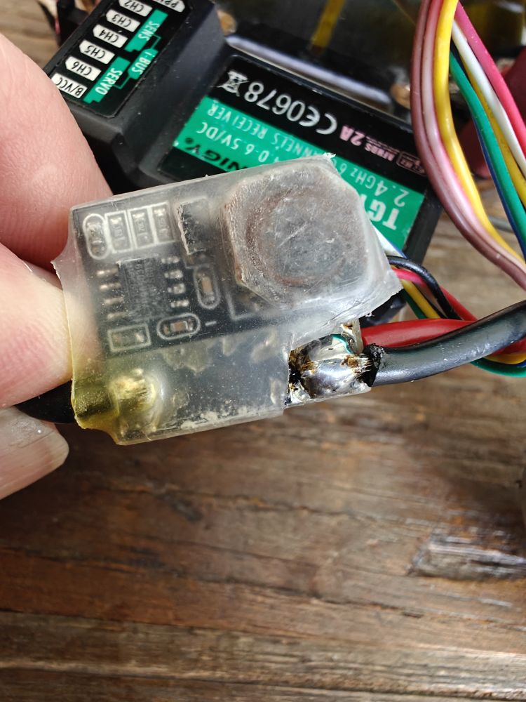

There you go (and thank you for looking into this):
If it’s of any help, I can cut the shrink wrap and take new pictures.
Kind Regards,
Stefan

That is an analog voltage and current monitor.

  • I still didn’t know what to answer for BATT_VOLT_MULT, and I now get the message that my battery would be unhealthy. There are again impossible values in that setting, so I changed it (sorry, but I see no other way to be even able to do a flight) in MP again; it now looks lik this:

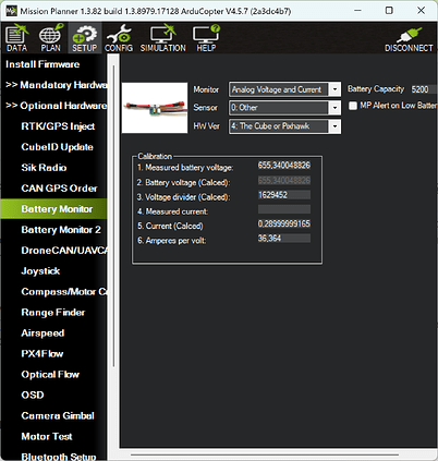

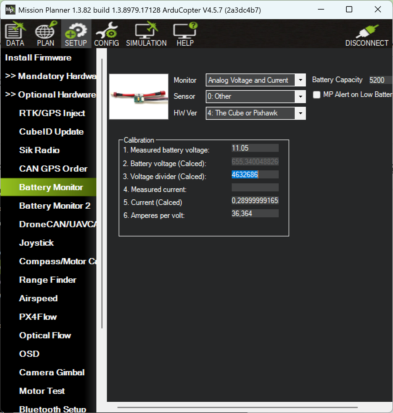

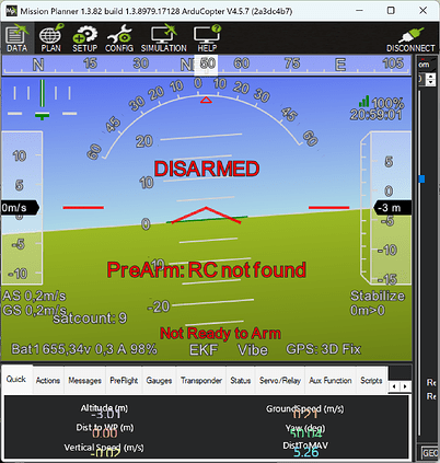

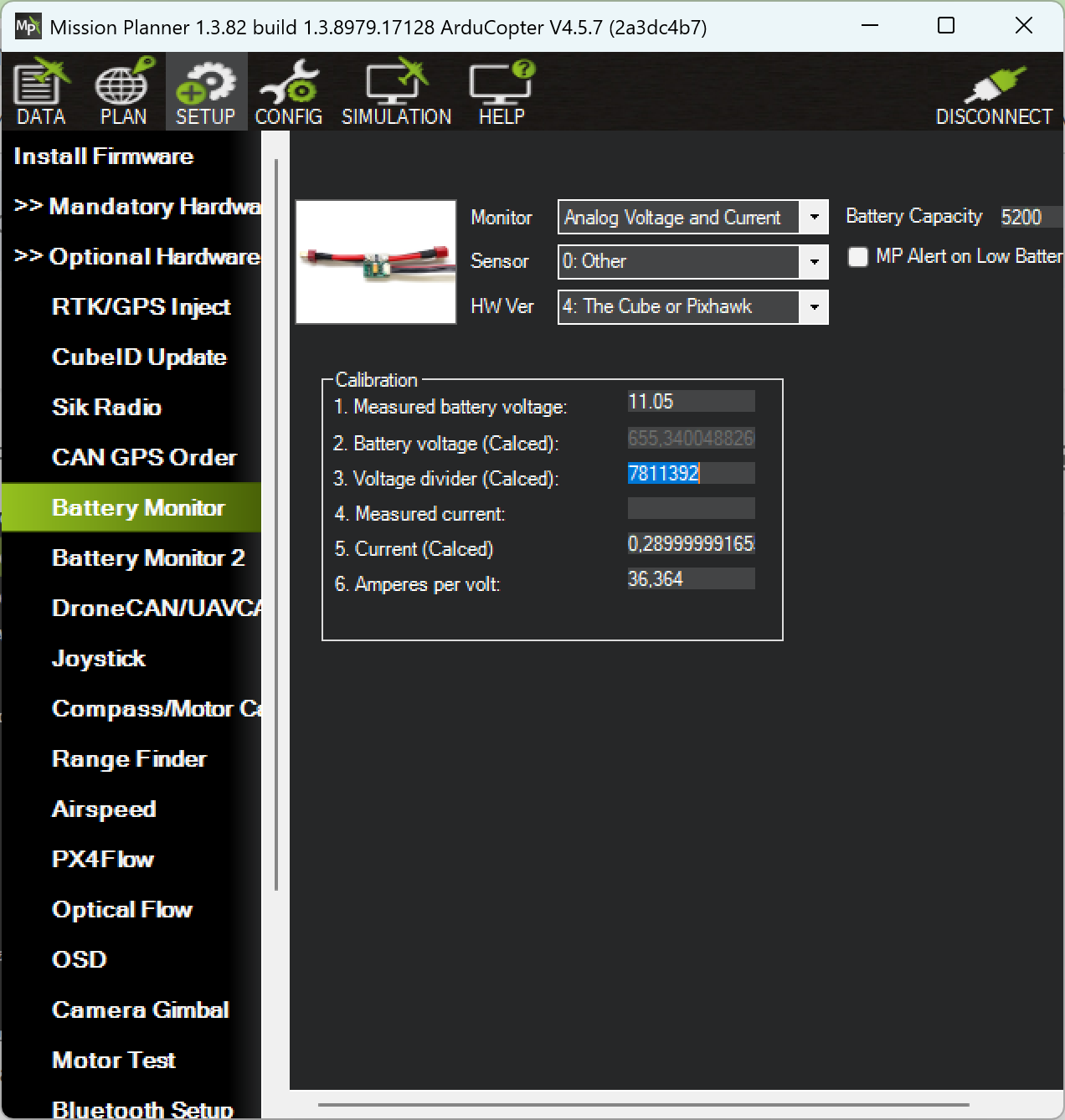

As for the battery multiplier: I measured my battery just now once more and I put the value in the correct fieldb (11.05V) at the moment of writing this. This is what I get when I go to that part: (sequence of screen prints now):
Watch field 1: where does that value come from ?? Ok: I enter 11.05 and then Tab:
Watch field 3: can that be right ?
So I go up to 1 and enter 11.05 again, ant Tab again:
Field 3 has changed to some value I don’t understand at all … What is going on ?
Once more, same sequence:

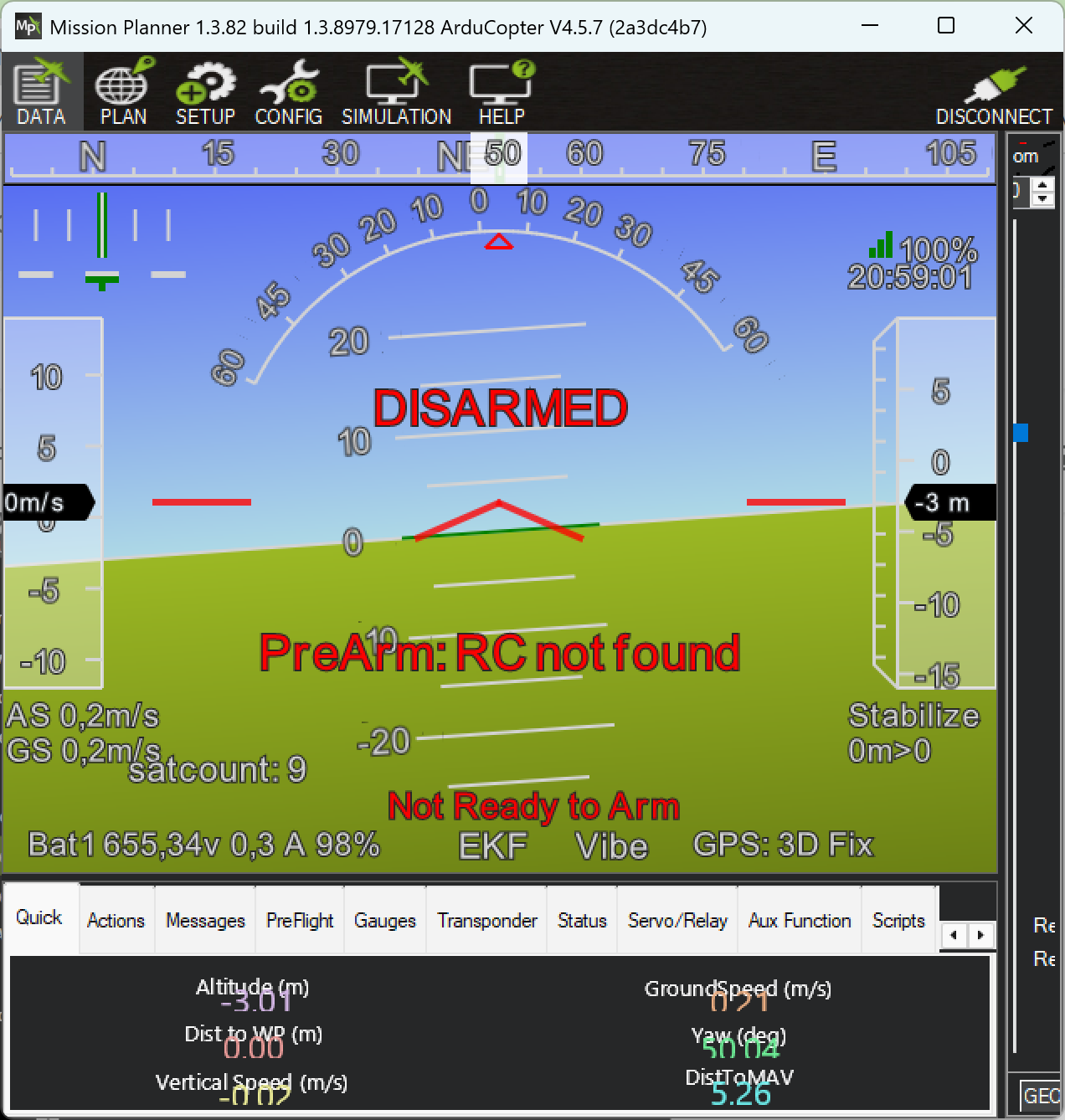

Check the DATA screen:
I really don’t understand what is going on, but my battery has no 655,34V …
What am I doing wrong ?
Thx for all suggestions and for your patience (for all of you guys).
Stefan.
Connect the battery to the craft and then connect to Mission Planner. I then measure the full battery voltage on the Balance connector (outside pins) while it’s connected.
Go to the Battery Monitor and replace whatever is in the Measured Battery Voltage with the correct value and hit ENTER. Do nothing more. You will notice the Voltage Divider change when you hit Enter. Now go to the HUD and see if the voltage displayed is correct.
If it’s not correct or you continue to have very high values for the divider then it’s probably not seeing the battery voltage and it’s just floating around.
From your photos it looks like you have built a craft from hardware to avoid so perhaps the power module is bad.

Use 10.04848 as a BATT_VOLT_MULT voltage multiplier. It seams to get the job done.

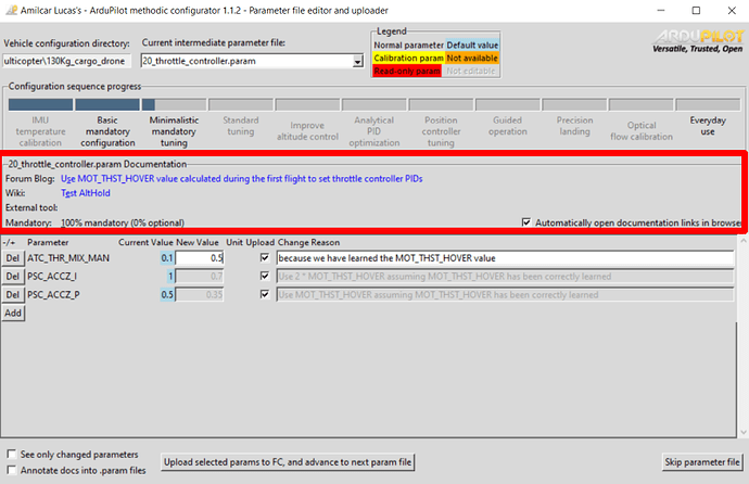

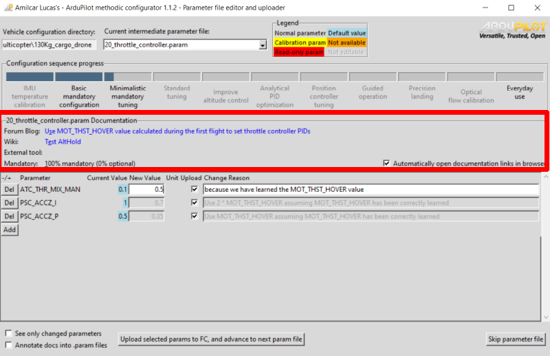

The documentation that gets presented in the AMC software explains you how that gets executed.
I marked that documentation in red below:

I gave your method a try (I’ll follow the procedure Amilcar suggested anyway, but I wanted to see what happend), and I indeed got a reasonable divider (10.something) and the HUD gives a correct value.

This time, please do read and edit the individual “parameter change reason”.
Ok, starting right now:

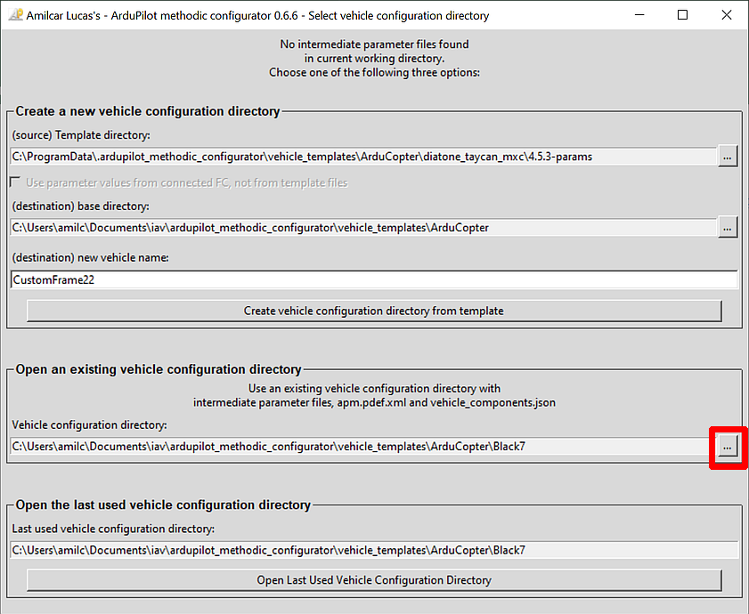

What template in AMC is closest to my drone (you know it better then me know) ? These template names in AMC don’t mean much to me …

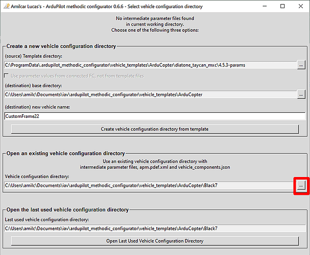

You do not need nor want to create new files from template now.
You need to open the existing vehicle configuration directory with the files that I gave you:

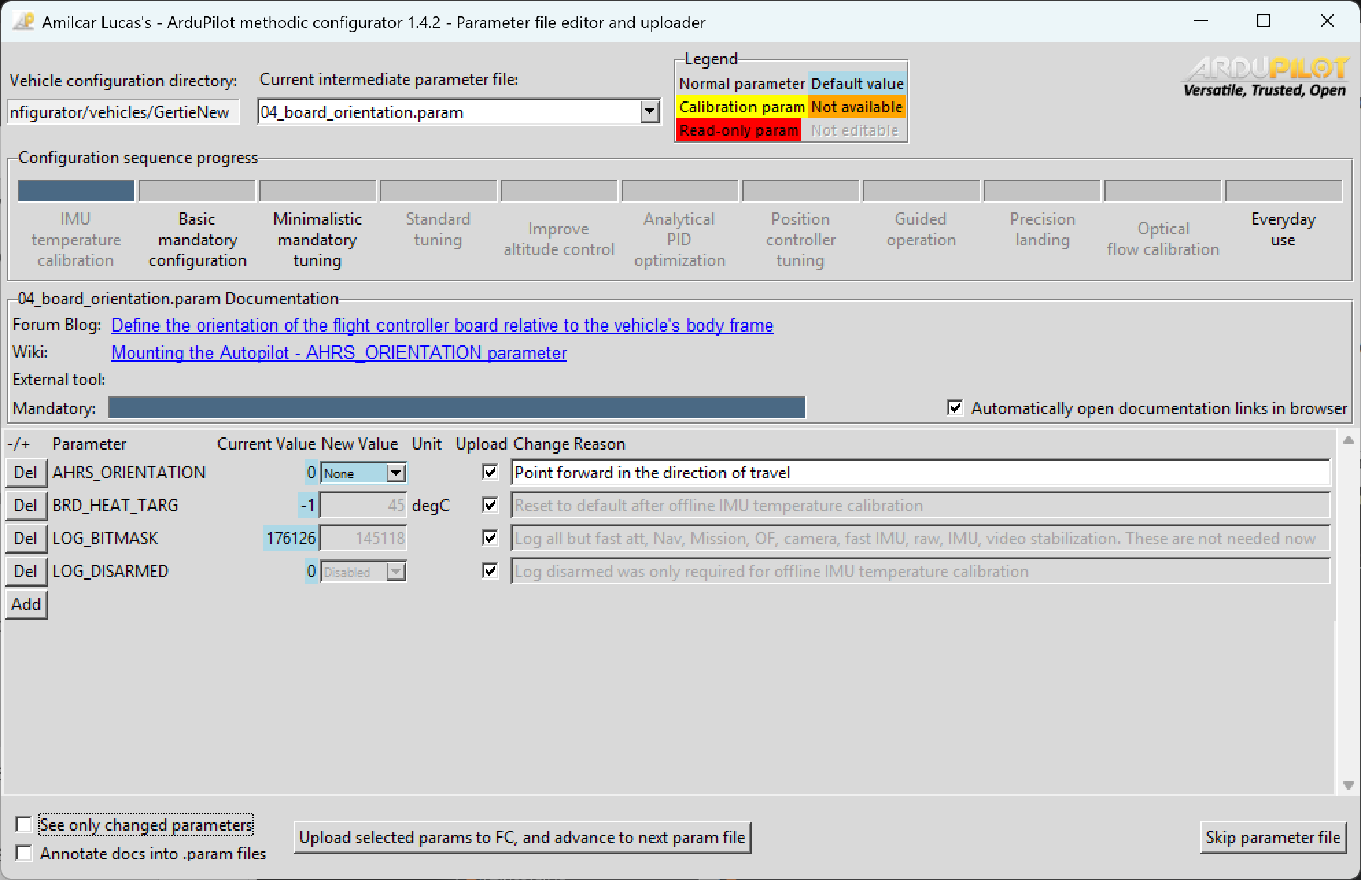

Ok, got it !
Now working my way through the screen. Just that I understand correctly:
The proposed changes ( New Value for BRD_HEAT_TARG and LOG_BITMASK) are what you put in the files I just read in the software, right ? I just accept them ?
But suppose I would have to do all this on my own, how do I know e.g. what LOG_BITMASK value to use ? How do you calculate that without using MP (since all other software has to be closed) ?

The easiest way for you is to use Mission Planner and not calculate anything. Connect to it, go to the Full Parameter List and to the LOG_BITMASK parameter. Click on the Options column and it will highlight Set Bitmask. Then you select what you want and let MP figure out the bitmask value.
This can be used for many parameters once you know the process.
