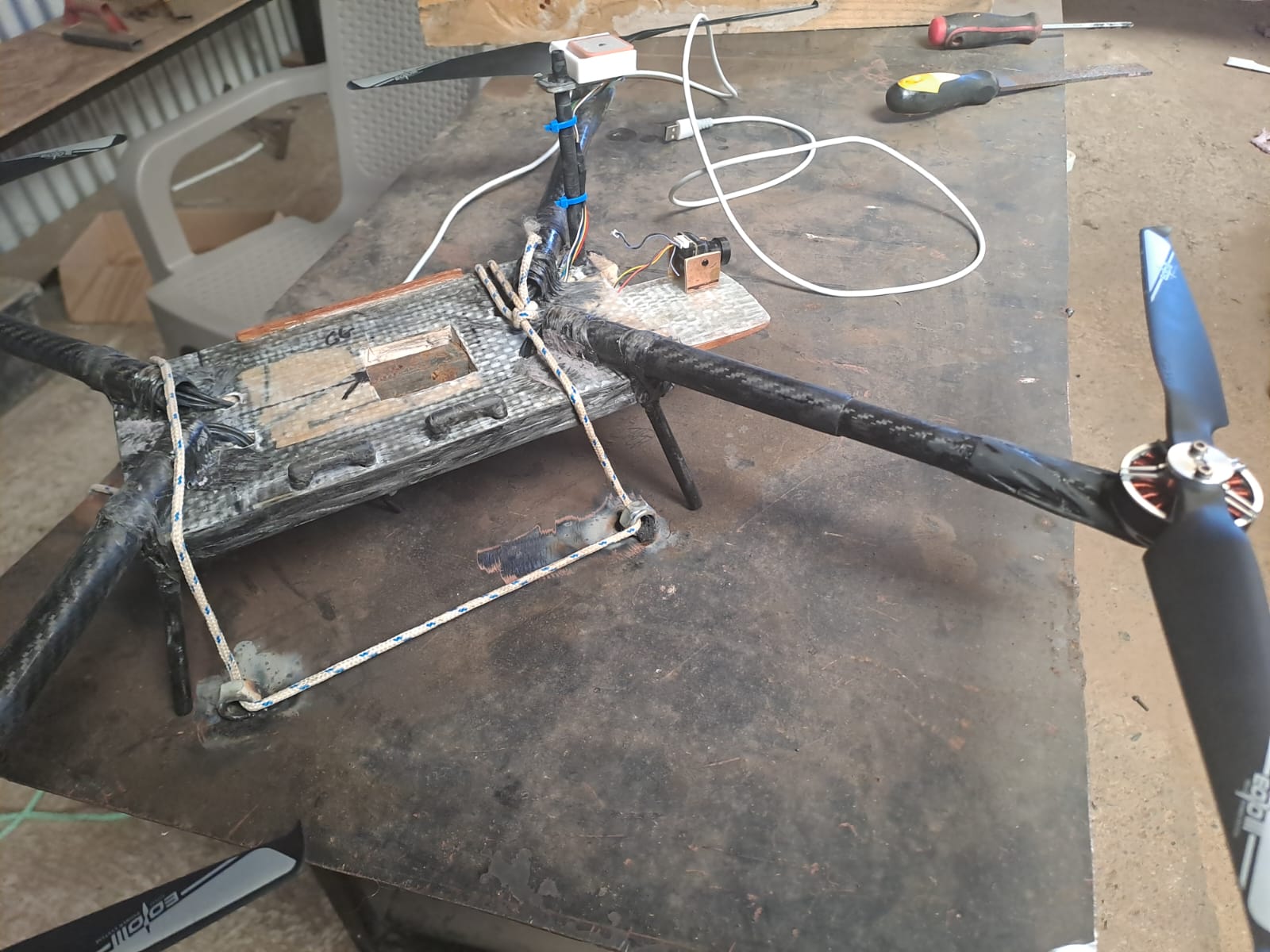

I have got strange behaviour with Z axis vibrations.
Basically, up to a certain current, all vibrations, inclusing Z, are rather low, at hover current of 20 A it is around 6…8, while XY are around 10…12, but from a certain current, around 38 A, it begins to shoot up, and with 45 A it is around 100 and with constant clipping, the other vibes, XY climb also somewhat, but stay below 50…60. I discovered it first at high speeds, above 80 km/h, but then also at fast climbs, so that I think it is not related to airframe - airflow interaction. The motor RPM output and RCOUT are also stable and without oscillations. The airframe is also very rigid, maybe too rigid (if you hit one arm with something hard, there is reverbating sound)?
My hypothesis was that the frame enters some resonance frequency.
Now, I tied down the copter and ran motor tests using the MP motor test feature and observed the Vibe. This time, unfortunately, even at 100 % power and 70 A the maximum Vibes were around 5…10, zero clipping, and the Vibe did not show any predominance of any axis. So now I am not sure if it is resonance related or not.
The frame is a DIY test build.
The vibrations during one flight were so bad that the FPV camera lens turned and got out of focus, battery shifted despite straps, and copter entered emergency EKF mode.
I am curious how do you prevent the round carbon arm tube from rolling.
How do you ensure the arm tube and the frame body maintain level.
Basically, I make complete arms with motor base plates, then using a table and small wooden blocks for getting a perfect level between the motor plates and perfect geometry, then I preglue the four arms and the main body with instant glue. After that I fiberglass the arms, takes about 48 hours to dry. The level error between the blades is less than 5 mm. Now you always can use shims to get a perfect level, but at 5 mm it is less than 0.5 degrees.
The arms are glued at the bottom using fiberglass, and also wrapped with carbon fibers. Compared to DJIs I have, Phantom, Mavic, this frame feels 3 … 4 times more solid, I can not really twist the arms at all, while in DJI there is some play
I made another test flight, and it seems that the problem stems from airflow. I was able to get 1000 W and vertical climb rate of 17 m/s without major vibrations, but with 70 km/h and some 600 W the Vibes go through the roof.
I just wonder, it is the arms or the body that generates such enormous vibration? Because the arms are also pretty solid.
Since the copter flies really well under a certain speed, I am now thinking of implementing some LUA script which would reduce power/speed when the vibes go too high

I have pretty much solved the problem temporarily using a Lua script. It measures vibrations in Z, once over a certain threshold (40), Lua checks the power, if over a certain limit (500 W), it begins to reduce the maximum power and also maximum angle.
