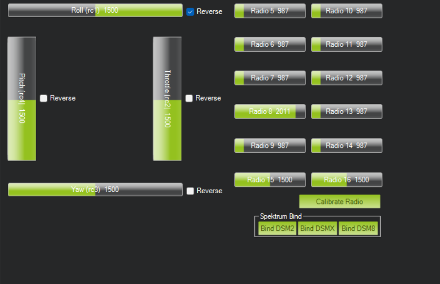

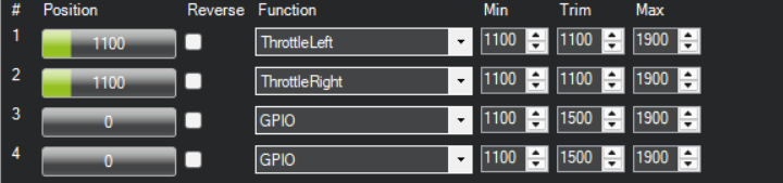

I am adding a couple of screenshot of the setting tab from Mission Planner…

So as for the settings: the 2 motor controllers are plugged on Channel One (Throttle Left) and Channel 2 (Throttle Right). The MOT_PWM_TYPE is set to brushed with Relay and each controller as the direction pin connected respectively to channel 3 and 4. The relay functions are set to 5 (Brushed motor reverse 1 throttle or throttle-left).

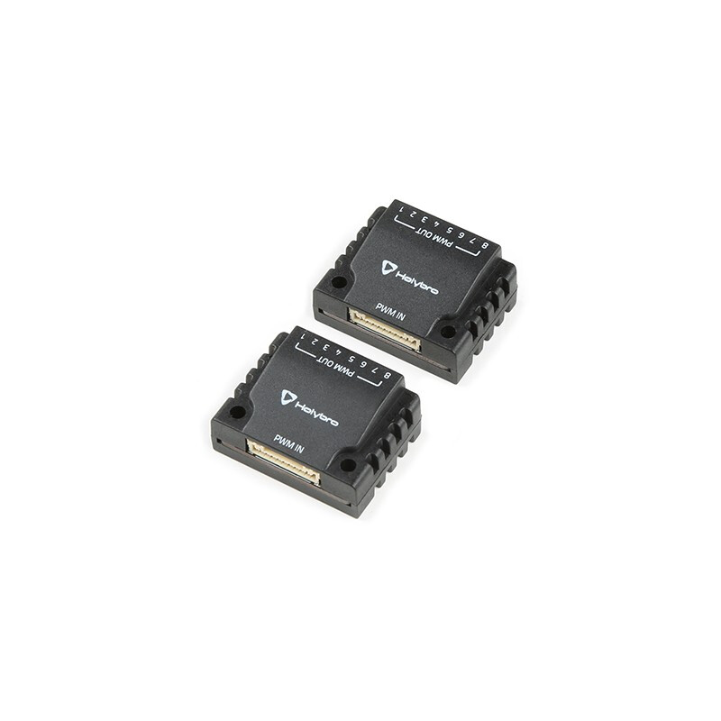

What is this PWM board? Is this only a wiring adapter or is it some electronic?
Your RCout 3 and 4 always show 0. So no switching.
You have changed the RCMAP so RCchannel 1 should be steering while RCchannel 2 should be throttle. On both channels we can notice some signals but not at the same time.
Did you run a radio calibration? For RCchannel 2 the TRIM value is not in the middle of MIN and MAX.
Is our motorcontroller using RC like PWM signals so from about 1000 to 2000 or is it using standard PWM range from 0 to MAX. I assume last one.
The PWM board is the one coming with the PixHawk 6C (see attached picture)
“Your RCout 3 and 4 always show 0. So no switching.” → ok, What I don’t understand is why the motors are changing direction then when I play with the joystick?
I will check if the RCMAP is correct.
I did run a radio calibration when I did the set up (as per the wiki recommandation)
