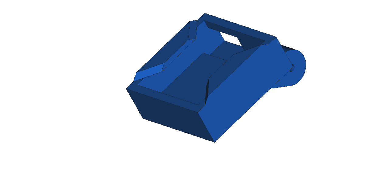

Hi all,
I know this is a strange way to mount the compass (the unit behind/to the right of the battery in the photo - Walksnail GPS/Compass), but I’m trying it for now until I potentially move it to the front of the copter. I have seen things about manually defining parameters for how the compass is oriented, but am confused by those options and repeatedly get errors like Mag(0) bad orientation: 6/36 1.0 when trying to auto-configure/calibrate the compass the typical way through Mission Planner. Should I use the COMPASS_ORIENT or CUST_ROT_ENABLE params to allow me to mount the compass this way? Are these values in reference to the front of the copter? All I’ve found so far in the wiki is a section here that seems like it might be applicable. Advanced Compass Setup — Copter documentation Am I missing something important? Thanks in advance!

Try to mount it horizontally. Onboard Mag Calibration has a problem if it does not align with the IMU. MagFit Tool can work with orientations of 45deg.
I run that M181 on a ZOHD Drift and after removing the hatch magnets it did calibrate without problems to yaw90. Couple of MagFits later error is 30-40mGaus, not sure if that’s a good value but I had no issues with it.

If you have access to a 3D printer, you could try alternative mounts
EDIT:
There is even one for the WS181
Whoa excellent - thank you @menschel !
I was dedicated to getting this working and after 3D printing a flat GPS mount, I am no longer having compass issues. I would guess that Ardupilot has issues with ~45 degree angle differences from the FC’s IMU. This seemed to be implied in the Orientation section here: Advanced Compass Setup — Copter documentation
For me the fix is to use a GPS mount with a parallel plane to the FC as @menshel suggests. Good luck.
