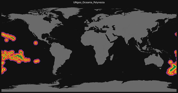

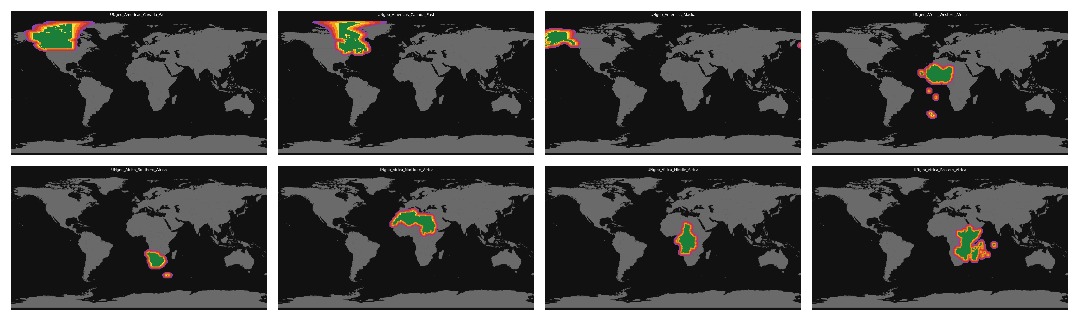

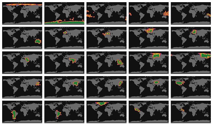

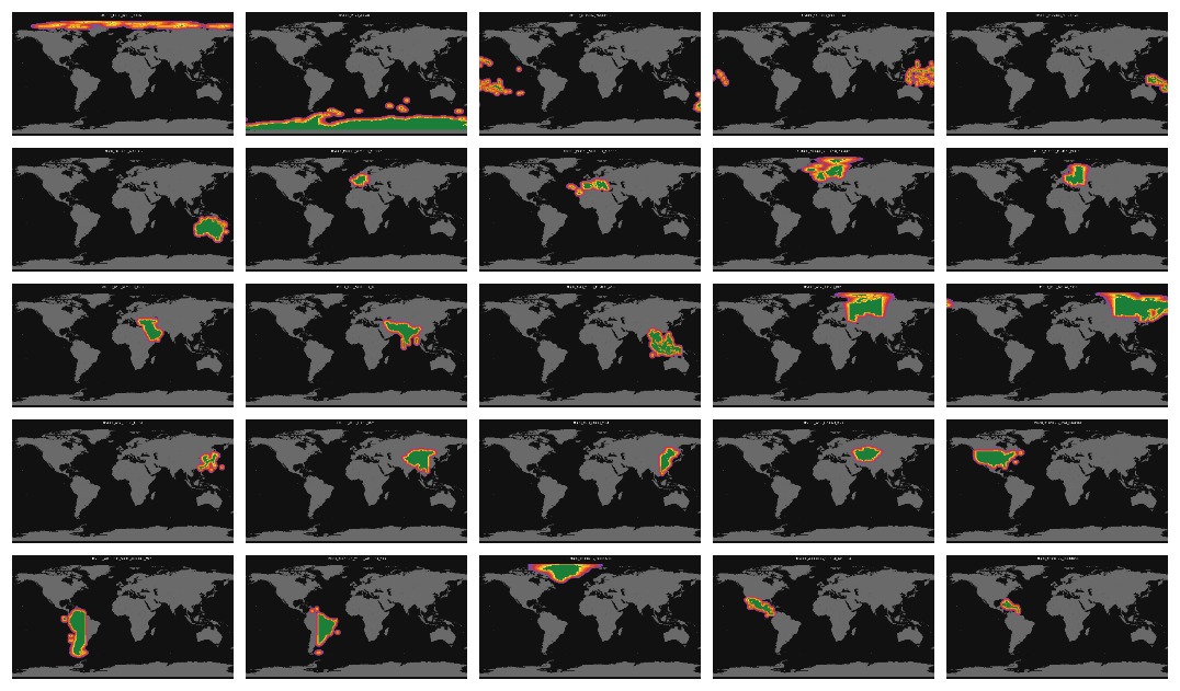

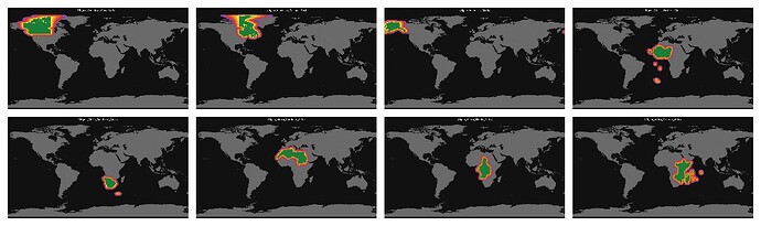

Previews attached (and in a preview/ folder next to the zips): grey world, green = land, yellow→magenta = the five halo rings.
