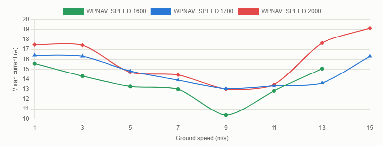

Thank you for such a detail explaination… much appricate. I checked both my quads and they have Sports mode available. I am gathering power consumption data via Auto mode as a function of speed VS current draw. But the Auto (mission) mode is balancing Alt and speed constantly which is preventing me to evalaute different wing geomatry to hone in on a best wing size (Yes, this experimental quad have wings). Based on your explaination Sport mode will do the same as Auto mode to maintaing Alt, meaning controlling the throttle. So I am left with Acro (w/o trainer) mode to test the aircraft. Only risk I see is flipping over if I am not careful :frowning:
