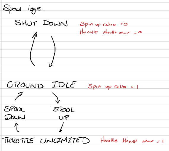

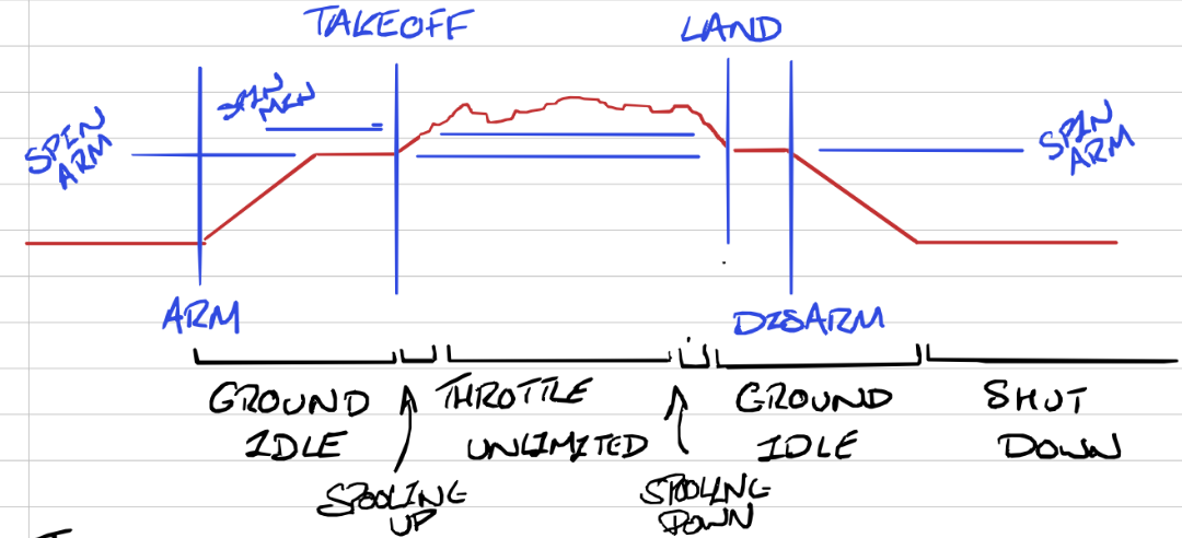

Okay I’ve spent the day studying this and I think I’m getting the hang of it.
Below is a rough state diagram. As I understand it, there are 3 desirable spool states - SHUT_DOWN, GROUND_IDLE, THROTTLE_UNLIMITED.
During the transition between SHUT_DOWN (motors off, disarmed), and GROUND_IDLE (motors at MOT_SPIN_ARM, armed), there is some logic to ramp up the _spin_up_ratio between 0 - 1 to ease the motors on.
Slightly confusingly, this isn’t treated within the SPOOLING_UP or SPOOLING_DOWN states. It’s all handled within switch cases such as the one in my OP, without being explicitly named as an intermediate case.
Then, when going between GROUND_IDLE and THROTTLE_UNLIMITED, the intermediate SPOOLING_UP and SPOOLING_DOWN states are used to smoothly transition between MOT_SPIN_ARM and MOT_SPIN_MIN.
The diagram below maybe illustrates some of this a little better. (I realised i forgot to mark the ‘SHUT DOWN’ at the very start of the plot here).

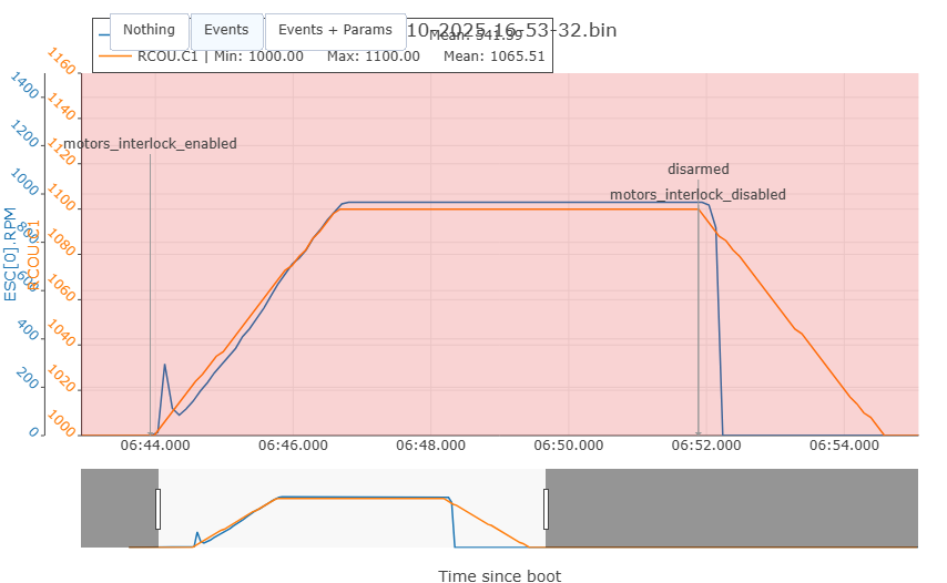

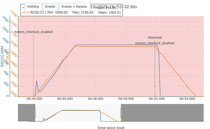

They ramp up nice and smooth, but on disarm they just stop dead, even though the code on my custom build is commanding the PWM to ramp down more slowly.
Annoyingly my bdshot has stopped working between yesterday and today so I can’t provide any more ESC rpm data until I fix that but the above image represents what also happens when I disarm with non-zero throttle.
I messed around with the AM32 config yesterday. I tried disabling ‘complimentary pwm’ which softened the stop a little but also caused the startup to become less smooth. I checked and braking isn’t enabled on them otherwise.
It’s not a huge issue for me at the moment. I was changing the code for different spool down behaviour and I can visualise that it has improved, I think the issues all now lie with my ESC config or some other silly thing like that. I’ll try it on a different platform soon and see if that behaves any different.
Behaving as expected, disarming commands immediate motor stop.
This is where I get a bit lost. As I understand it, if PWM is enabled when disarmed (MOT_SAFE_DISARM), then the motors should spool down in MOT_SPOOL_TIME (or MOT_SPOOL_TIM_DN) to a stop. This is part of the change I’ve been working on in my custom build since having the motors ramp down as opposed to step down is much more useful for one of my applications.
I would expect if MOT_SAFE_DISARM = 1 then the motors stop as soon as disarmed, or if the user commands a motor emergency stop.
Could you try waiting for disarm timeout? I think we should ask Alka to implement command to disable motor instead of stopping.
Stopping the motor ASAP when disarming makes sense if you are trying to minimize collateral damage which I think is the assumed reason for disarm commands through radio.
The image shown was not a manual disarm, it was automatically triggered after timeout.
