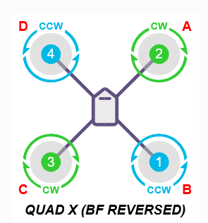

Thanks. My drone is a Quad and has an X frame (exactly like depicted in Mission Planner) with props out and if selected it I get the prearm message mentioned above. Or should i just test completly different layouts and see if they work?

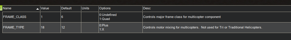

If You still get that message that point it is not set. For quad with props out I think You need to set parameter manually anyway.
FRAME_CLASS = 1
FRAME_TYPE = 18
I would use this param, but still motors layout needs to be verified by motor test to check if the assignemt is correct.
One word of advice - do not skip steps if You do not want to crash your drone.
params can be set in CONFIG → Full Parameter List in mission planner.
Perhaps, it might be better for You to go with with AMC software as AP is not the easiest to setup
FRAME_TYPE = 18 is this one I belive:
I have set it like you:

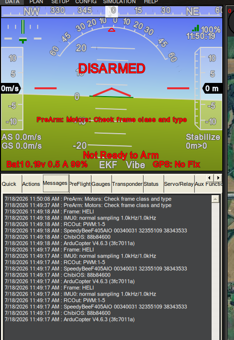

But again i get:
I dont now why it says “Frame: HELI” after each reboot, eventhough in the config it says Quad.

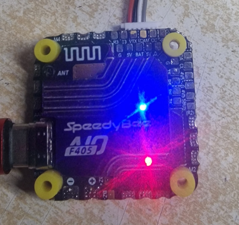

And I have the AIO v1 (purple).
I just checked and seems to be working fine on my desk.
after setting frame class/type works as expected.
What I would do, just to be sure - in stm32 cube prog. first check if there is any flash protection, then do mass erase and flash it again.
I used this one: https://firmware.ardupilot.org/Copter/stable-4.6.3/SpeedyBeeF405AIO/arducopter_with_bl.hex
Ohoh…
I accidentally used SpeedyBeeF405AIO-heli and not SpeedyBeeF405AIO.
I feel a bit stupid now, but thank you so much for your help and patience.
