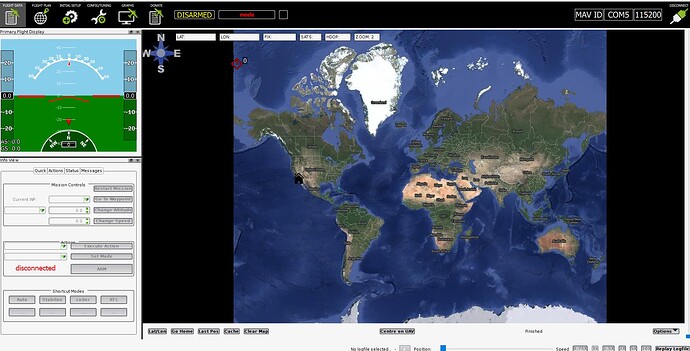

Hello everyone,
I am trying to configure a speedybee F405 Wing APP to use in a Stalion Fixed Wing VTOL. I believe I was successful flashing Arduplane to the speedybee but for some reason I have no readings on the APM Planner. I have the speedybee connected to the APM (via USB), it is recognized because i can click connect and if suddendly I remove the USB it appears disconnected and in the terminal I can see info is flowing (in a non inteligible format). One example is the artificial horizon that doesnt move.
Can someone help me of had a similar problem?
Thank you in advance
APM Planner hasn’t seen any activity in some years. Use Mission Planner.
