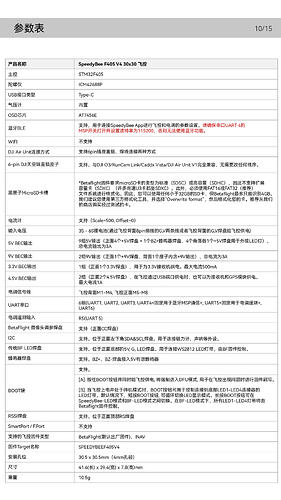

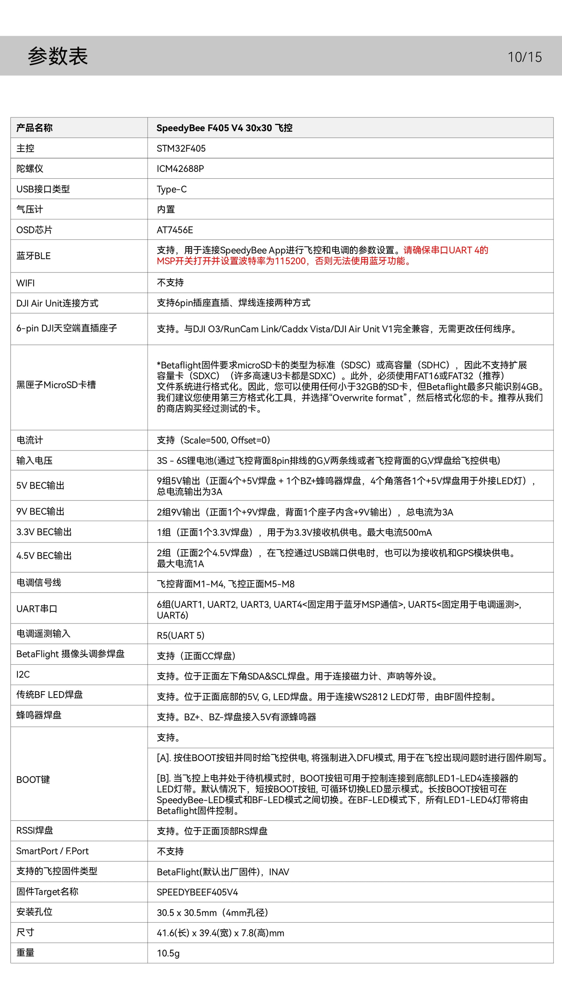

我查询了一些信息发现FC:Speedybee F405 v4并不支持APM固件,官方说明支持BetaFlight固件和INAV固件

ardupilot is often (not always a true staement) not listed on manufacturers documents. you need to referance the ardupilot ducomentation about flight controllers here. ( Choosing an Autopilot — Copter documentation ) this lists all verifed flight computers and the limits they have; if any. besides if this board was not supported then there wouldnt be a stable nor an “offical” (according to mission planner and ardupilot firmware database) ardupilot firmware build for this board. its a little confusing at times and almost got me when picking out a flight computer the first time. happens to the best of us.
