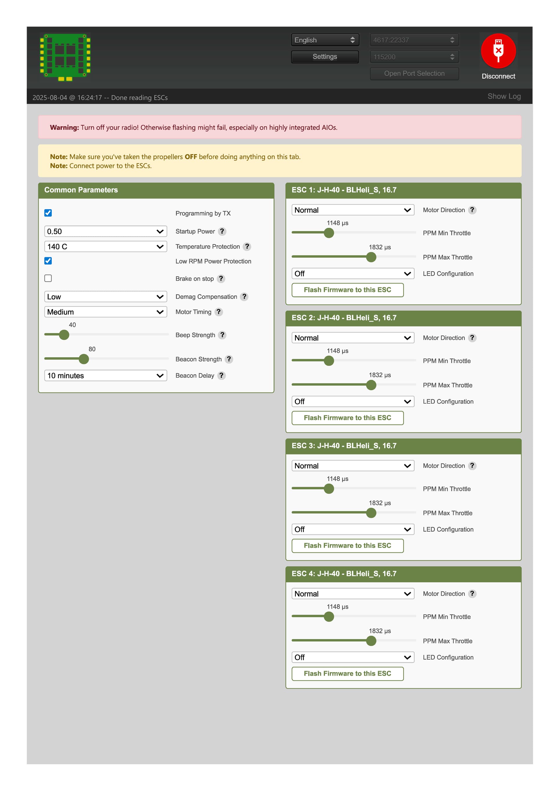

Try 4.6.1 instead. I had problems with plane 4.6.2 passthrough as well, reverting back to 4.6.1 and I can connect through esc configurator
Saw your reporting, thanks, I will try and hope 4.6.3 will resolve this issue.
@aistaca
Yes, 4.6.1 pass-through with BLHeli_S works.
@xfacta

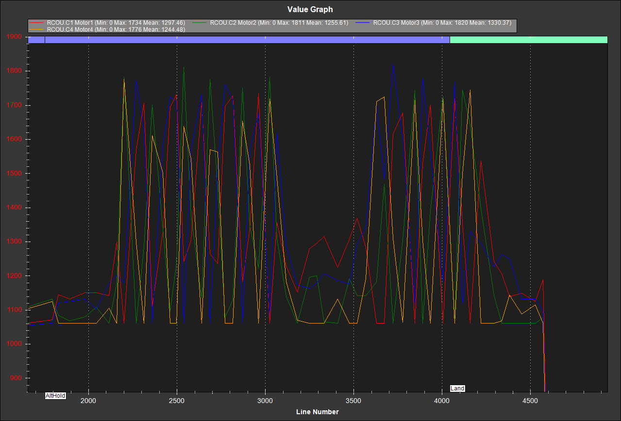

We are trying out a 250g drone using SpeedyBee F405 V4 BLS 55A 30x30 FC&ESC Stack with Arducopter 4.6.x.
Do I do the same in BLHeli_32 to disable Low RPM Power Protection and reduce Startup Power to 0.25 with BLheli_S? I am not satisfied with the Motor output graph.
