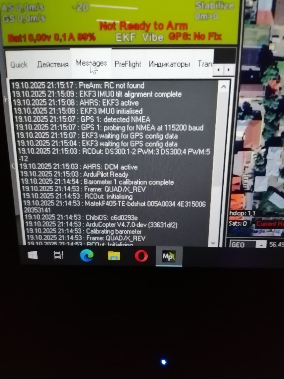

[solved] Arducopter lose GPS info after 3dfix
board - matekf405-te
arducopter 4.7.0 ver
GPS - RTK module UM980 - build17548
all options - standart for nmea modules

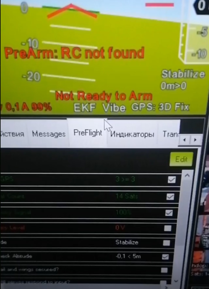

video:
solution: UM980 firmware rollbaсk to v11833
