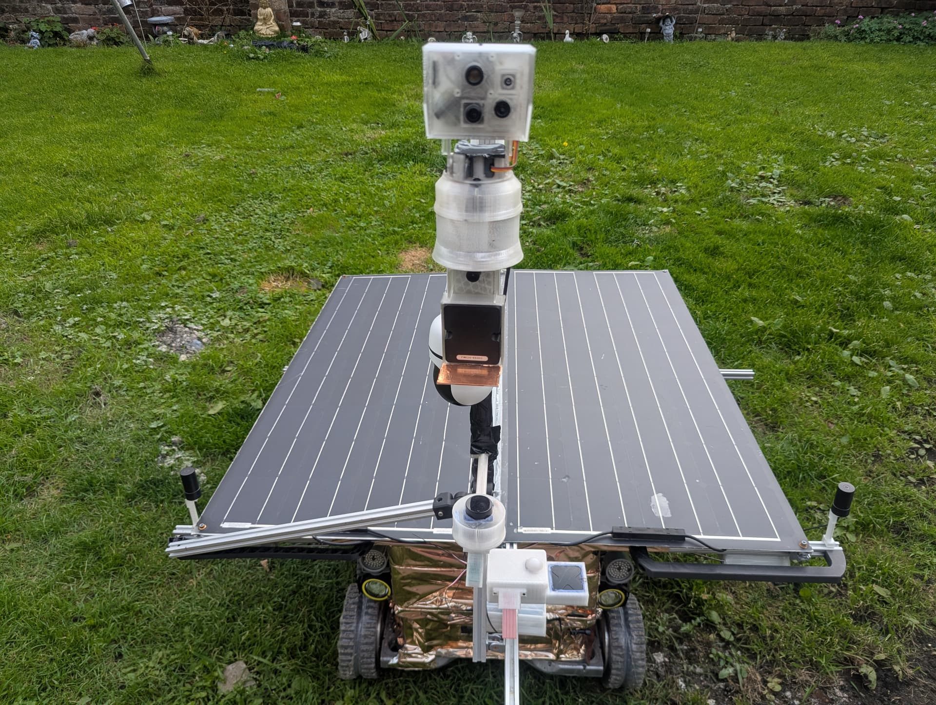

Solar Rovers - trying to run Ardupilot indefinitely
I don’t know if that helps but I figured it could fit you use case.

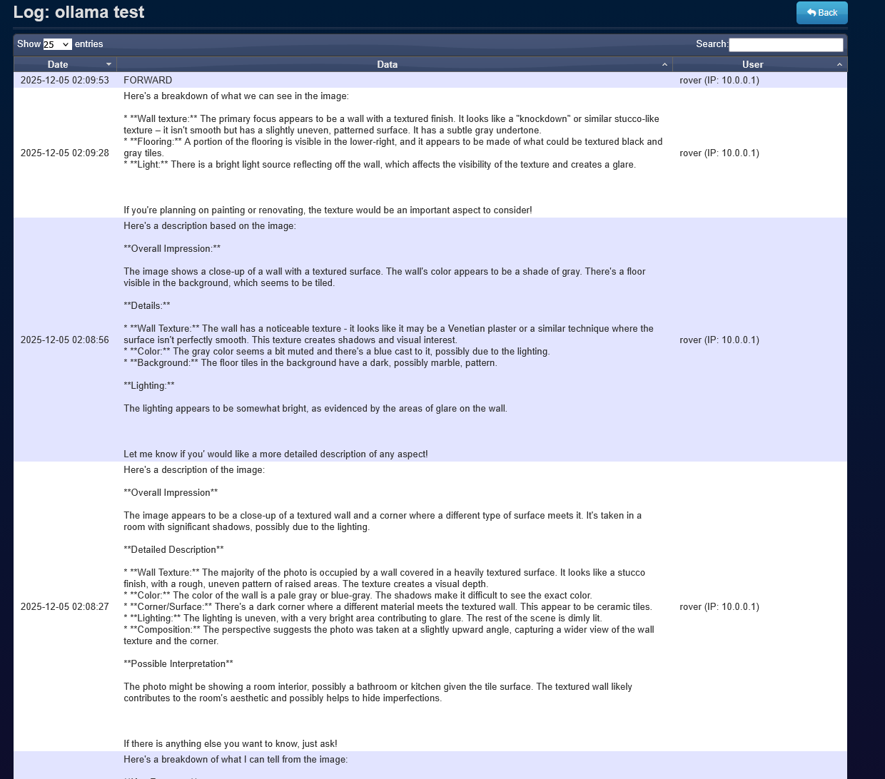

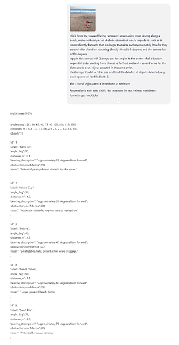

On the rover I have an AMB82 mini camera with a built in NPU that can do YOLO vision along with a radar to give it depth, The problem is that it’s very limited in what type of objects it can actually detect. You would need to train it on each object or try and find data sets with specialized objects specific to your environment. When I eventually move to a boat it will become more useful as the verity of objects is reduced dramatically to just some boats and buoys, so a marine specialized data set should work really well.
yolo E is very interesting but its a bit over my head, i have never used python before.
The LLM approach works with a much larger verity of objects, but that comes at the cost of speed. where YOLO can run several times per second, a LLM response is 5-10 seconds so my plan is to have the LLM look far ahead where the sensors like lidar and radar cannot see to try and spot obstructions far enough in advance that the rover can take avoiding actions before it gets there.
The LLM also has randomness in it where it can hallucinate and give some wacky answers, this is much more common with the smaller models as they have less data to work with, generally they are ok with basic tasks like identifying objects but when you try and ask them to estimate how far away it is then it will start telling you the ship on the horizon is 5cm away. The large models are much better at those kinds of estimations. So an approach where it uses the small models to look for obstructions then stops and waits for the larger slow models to figure out what to do about the obstructions seems to be the way to go.
getting the data out is relatively simple as its just using json, my next step is to test some different approaches, one will be just asking the LLM for a distance and angle to an object that it can then use to create a mavlink proximity message that can be sent to ardupilot for bendy ruler to deal with or i can ask the LLM to try and work out a course that i can command in guided mode.

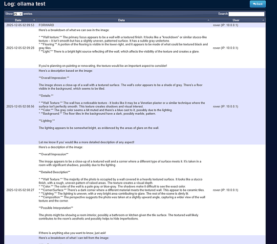

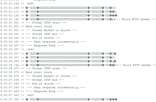

I am now able to send photos to my server for processing with an ESP32 cam module, it works but esp32 cameras aren’t very good. I’m still trying to get it to work on the amb82 mini as it has a much better camera but the http library is different so Im still having issues getting it to send and receive json data.
at the moment, to test I’m just sending this, it needs to be expanded with more rules but for first tests it’s enough. The plan is to drive using GPS with the LLM scanning ahead for things the lidar cant see, then if something is detected it can try and figure out a route around it.
“what way can I move reply left or right to rotate in that direction or forward if that would allow further progress, if you cant see a way around then replay backwards to reverse the vehicle away from the obstruction. single word answer only”
Then im checking the answer

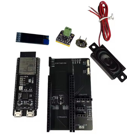

I have ordered an esp32 I2S audio kit so it has a mic and speaker that way it will be able to take audio commands and reply to people that come up to it. it can also explain what it is and then ask if they know the location of john Connor. I haven’t figured out how to do it locally yet so I will be using google TTS to make it talk
https://www.aliexpress.com/item/1005009881953806.html

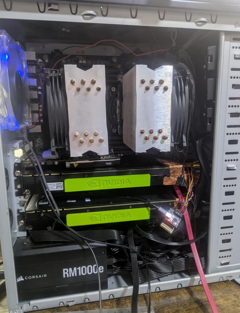

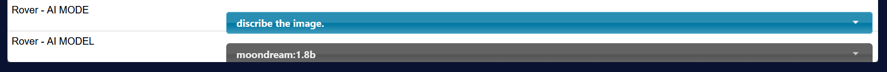

In order to test different AI models for consistency I needed to be able to run them locally and renting hardware especially GPUs for long periods of time is very expensive so have built a cheap AI server to run models on the rover using old server parts.
old gaming case and power supply
chinese dual x99 motherboard
2x 2699v3 xeon CPUs
128gb ddr4
2x tesla M40 24Gb GPUs
I was testing on my desktop pc up til now and although its a decent pc with 7950x, 64gb ram and a 24gb rtx3090 it was painfully slow to run if you ran out of VRAM and I didn’t have enough RAM for anything big on the CPU. The 2x 24b tesla m40s can run large models in GPU memory so despite being much older and about a third of the speed of the 3090 because there is double the vram it’s still faster at the large models that exceed a single 24Gb card because it doesn’t have to use the CPU.
I had a couple of issues I had to address with the AI computer, the first was that this computer essentially has the single purpose of driving the rover so I don’t want it on any longer than it has to wasting power, so i wanted to be able to remote control its power button so it could be started and stopped automatically when the rover was active. I also had the problem of the tesla cards not having fans or fan control. so I needed to be able to control the fans

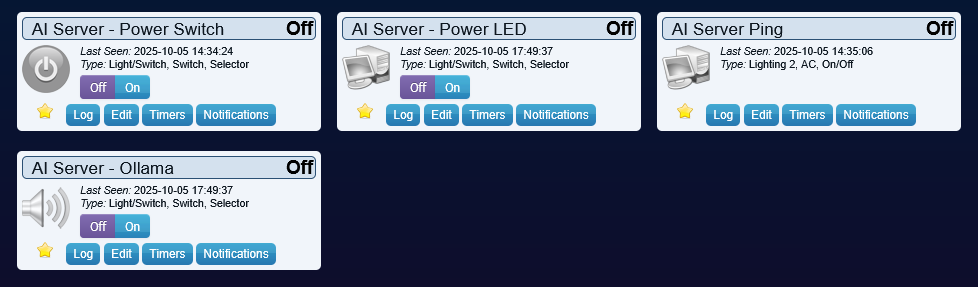

to fix all this I made a stand alone ESP32 C3 control board, It has 2 main functions,
1 is that it connects to a pair of i2c temperature sensors on the back side of each GPU core and to the RPM and TACH fan wires on both fans, it can then control the fan RPM using a PID loop to regulate the cards temperature.
2, The esp32 acts as a remote power switch, it controls the power button and also monitors the power led to verify if the computer is on or off.
With the state of the server now able to be monitored, I can script the rover to wait until ollama has started and is ready to start processing requests before it starts to move. Then when the rover goes to sleep for the night, the AI server will shut down until the rover needs to move again.

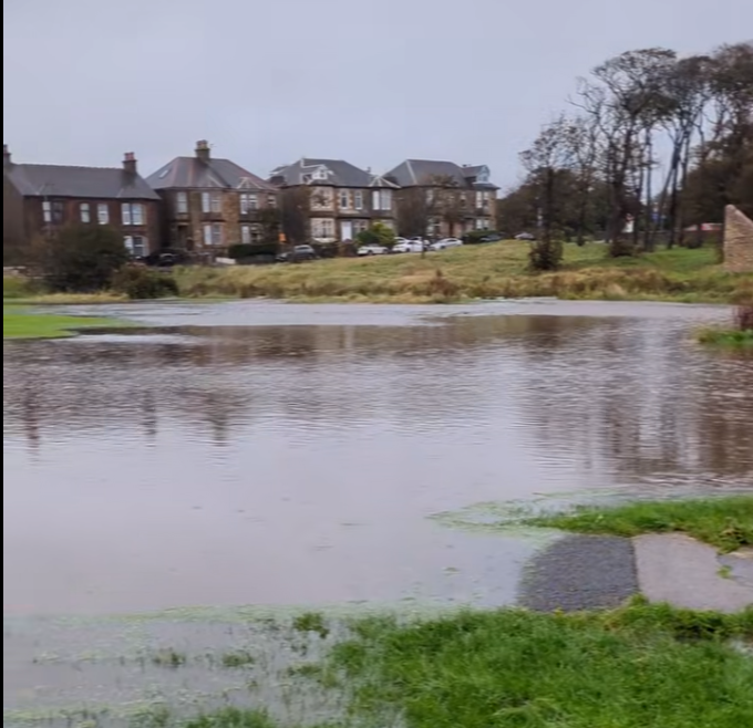

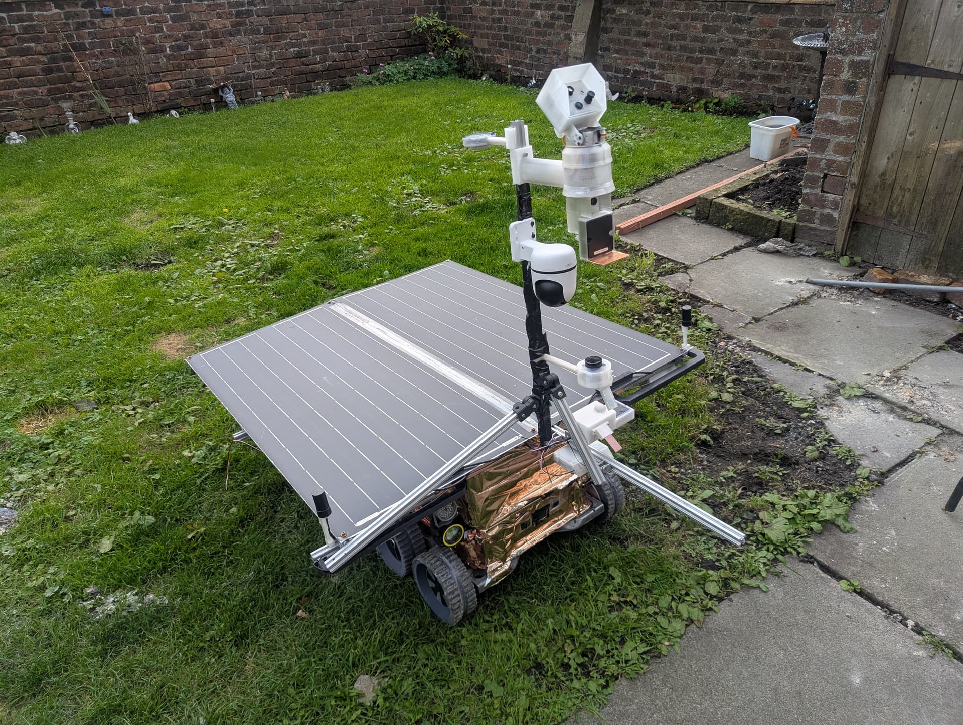

There was some flooding recently after some heavy rain and my testing park has turned into a pond, the small hill where the rover parks at night would have been above the water but the rest would have been several feet underwater, some water sensors might be worth installing and some extra instructions for the AI not to move if there are any signs of flooding.
Finally got it outside for testing again, it’s probably going to be out for a month or so while I check that it’s not going to corrupt or do anything strange.
Unfortunately that’s means it’s going to be out until November, which means barely any sunlight and freezing temperatures. It will probably have to sleep most of the day to conserve power as well as at night. There are safeties in the Battery BMS board that won’t let it charge if it gets too cold so I’m going to add some insulation to hopefully keep it above freezing so it can take a charge. A heater might be an option if I end up not being able to charge for long periods of time
Plan B is that I have a pair of batteries so I can swap the empty battery for a full one if it gets critically low.
Due to tall buildings it will get little direct sunlight in the garden as the sun gets lower due to winter so it will be going to the park if it does ok this month as it’s open space with a small hill that will let me park tilted south to face the sun.

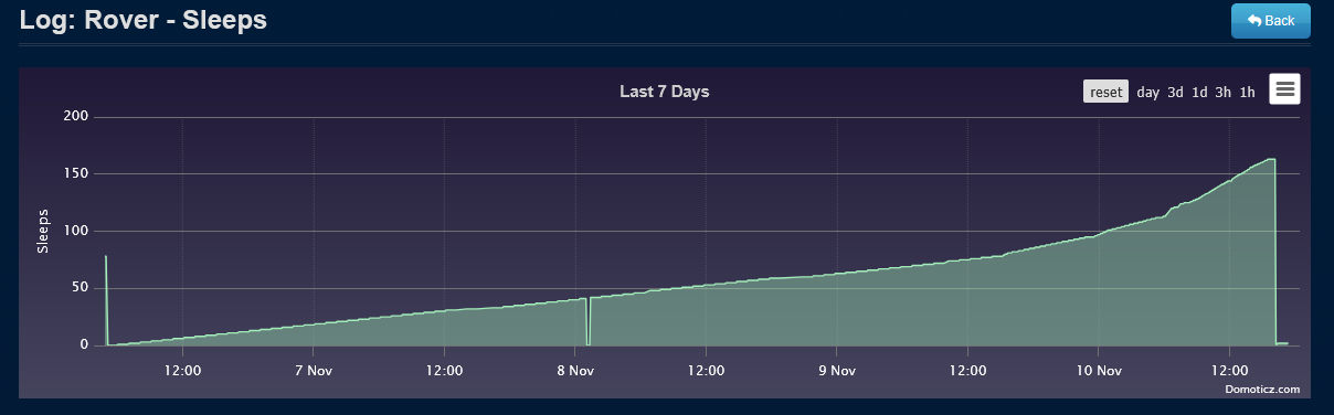

So my 2 main priorities were deep sleep, where the power consumption can be lowered to almost nothing by using the deep sleep mode on the esp32 combined with being able to shut off power to everything using relays bringing consumption to under 1mw. It also got a black start capability where it can start up from solar with all the batteries totally discharged.
My batteries have a BMS so they will disconnect the battery when it’s too low. when it first gets power from the solar inverter it all goes through a low power 48>5v regulator to the esp32 and modem to power it and charge the 5v backup so it can communicate with the server.
The first 5w will go to the esp32 and modem backup battery and the rest will go to the main battery. Only once both the backup and the main battery have enough charge, the esp32 will close the main relay supplying power to the esp32 power board that will then supply everything else on the Rover.
This has been built with absolute cheapest parts money can buy. :grinning_face_with_smiling_eyes:

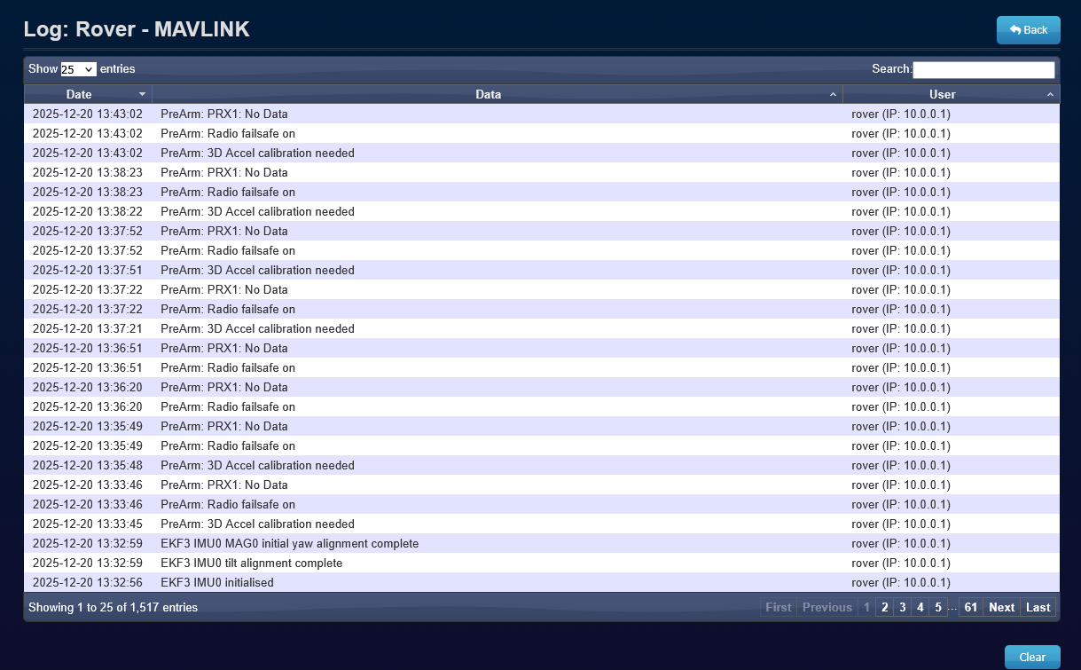

The first problem was because I don’t have a data sim in the LTE modem, it’s set to just use the Halow Wifi for now since because it’s in the garden it would be a waste of money to use LTE so close. Because I never originally designed it to operate like that when I turned off main power, it ended up draining the second ups that was powering the halow Wi-Fi adapter and the Wi-Fi camera, and when that happened I couldn’t reconnect to it.
The issue was caused by the 5v source to charge the 9v UPS coming from the output of the ESP32 main power board. The 9v UPS was originally just for the camera and temporary powering of the halow wifi adapter so it doesn’t have a direct connection to the main battery like the 5v UPS that runs the ESP32 and LTE modem as I didn’t deem it critical since LTE runs from 5v and that’s the main connection, The 9v UPS 5v power supply comes from the esp32 power board and that won’t start without server connectivity. To remedy this issue, I have added a second 48v>5v regulator connected to the output of the main relay so the 9v ups will get power from the main battery as soon as it wakes but not while it’s sleeping so the wifi will get power on startup as long as the main battery has power.

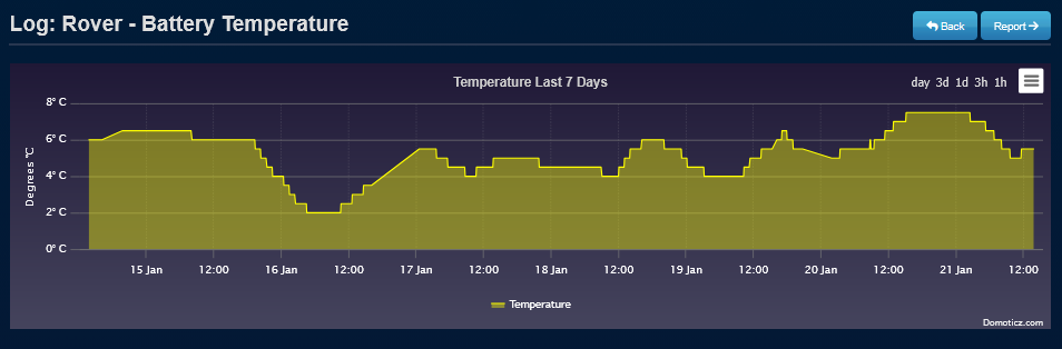

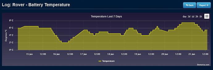

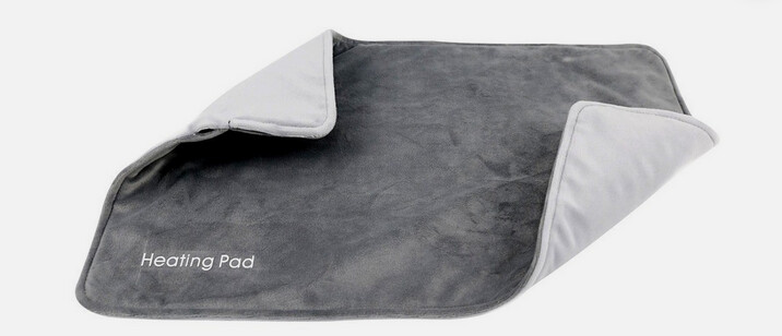

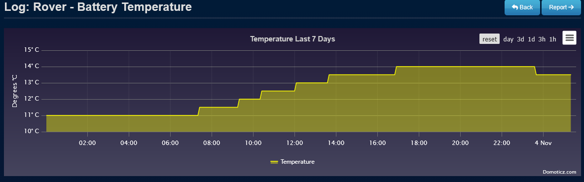

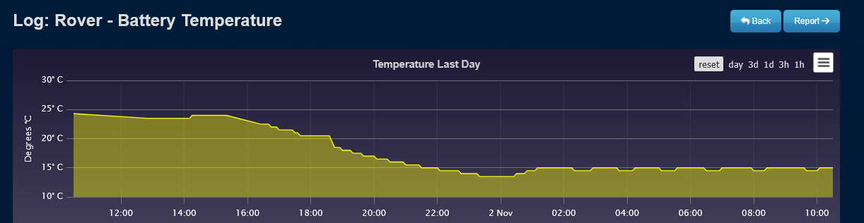

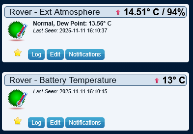

In order to thermally manage the battery I bought a cheap usb heated blanket, it uses around 5 watts to run. The plan is to wrap up he battery and use the temperature sensors from the battery BMS to manage the battery heater in order to keep the battery from freezing and getting damaged from trying to charge it when it’s too cold. I will probably add some foam insulation around it since the better it’s insulated the less energy I will need to keep it warm. at 5 watts I doesn’t get too hot even when left running so the battery should be safe even if there was a malfunction and it stayed on.
From what I can find lithium batteries have a minimum operating temperature of 0c for charging and -20c for discharging so it should be ok to let the battery get cold overnight and just warm it up in the morning to charge it as it rarely gets below -10c.
I have had the BMS working with ardupilot via mavlink but I ran into the issue of it bypassing the BMS due to the negative switching so I’m waiting on a Serial isolation board so I can connect it again.
For now I’m using a LM75 i2c thermal sensor to monitor the battery and operate the heater until I get the BMS connected.

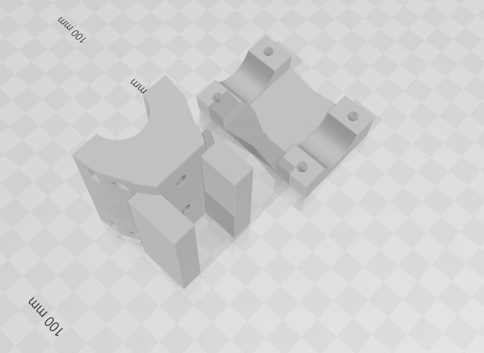

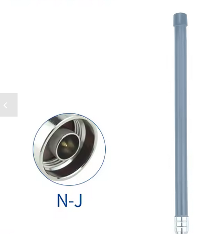

The new 868mhz Halow antenna is now mounted to the top of the rover mast with a 3d printed bracket. im hoping this will let me get a wifi signal at the park and beach that is only 250 meters away saving me a lot of LTE data.

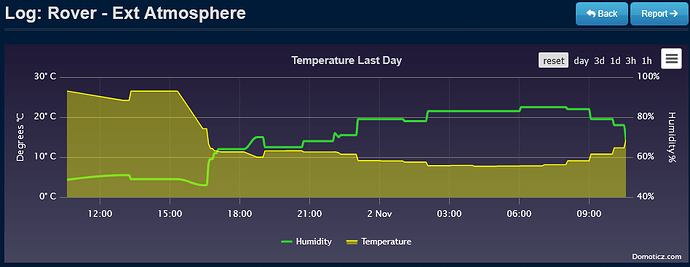

Its first night out in the cold went much better than I expected. The new battery heating system works great, when testing it was only using around 2W average at around 30% duty cycle to keep the battery at 15c when it was 7c outside. I looked at using a PID loop, but the heater is so small and the battery so big that it can keep it within 0.5c just by only turning on if it’s under the set temperature.
This setup was just for testing, the script will be modified so that it only heats the battery in the morning once the solar panels are generating power or at any point if the battery gets down to under 0c The BMS has been programmed so that it won’t allow the battery to charge under 0c so the heating script will try and keep the battery above that temperature at all times.
I now have it starting up and shutting down reliably, the power consumption is down to 5-6W when it’s idling in ECO mode with just an esp32, halow wifi and a 2.4ghz wifi router running.
I’m just switching on the second esp32 with all the weather sensors once an hour for a minute to send data then back off so its average consumption is almost zero. The camera is switched on for 5 minutes when the radar detects something, so its not using power at all times. It should be low enough that it can stay on and running continually other than the darkest days when it will have to go to sleep.

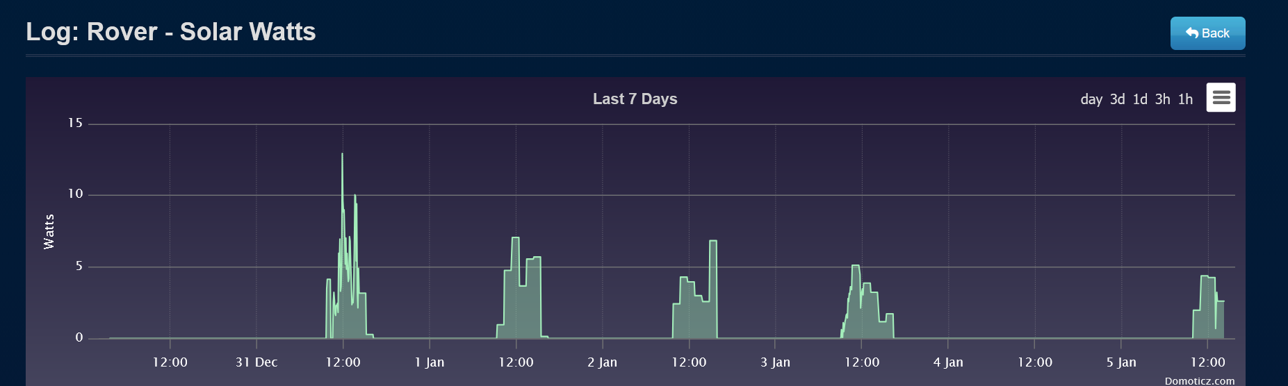

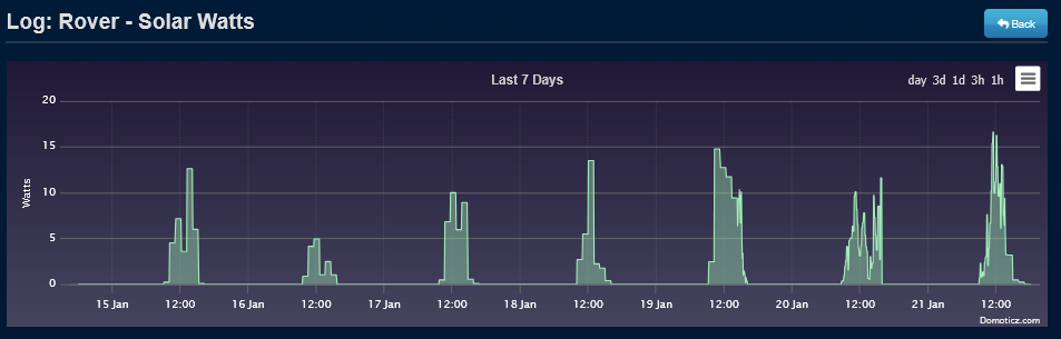

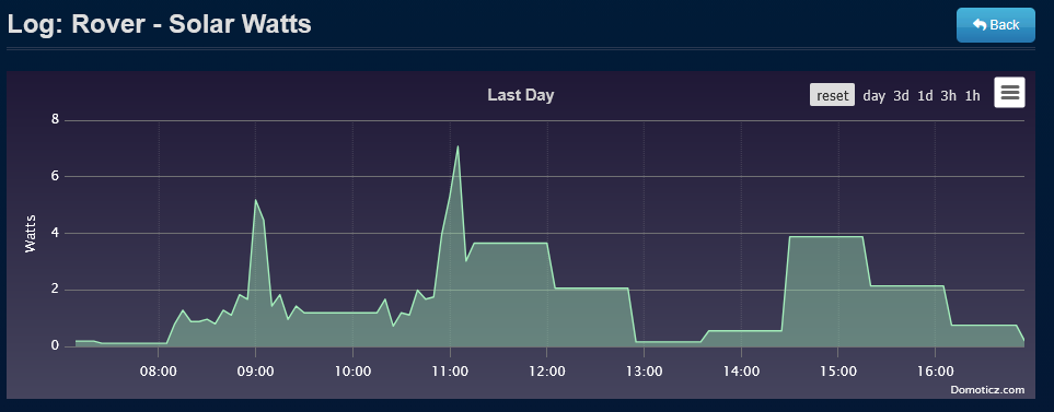

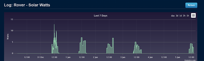

Unfortunately It’s not looking good for being able to keep it running every day. Today it was overcast with some rain, the sky was dark grey the whole time and this is the result. The 2x 100W solar panels topped out at 6 watts briefly. Even just running in its lowest power configuration, it’s not enough to keep it running continuously. Sleep is going to be absolutely essential for the rover to not run out of power.
When I realized that it was never going to generate enough power at around 11am I put the rover to sleep, so it’s been waking up every hour to report the solar panel’s output, that’s why it suddenly gets low resolution.

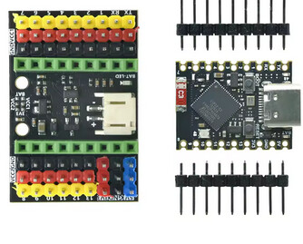

I had done some testing before i put it outside and I discovered that when it’s sleeping it’s using a lot more power than it used to, it took me a minute to work it out but its obvious when I realized. basically, It’s because I changed from the lillygo T7 S3 board to the ESP32-S3-DevKitM-1 Because the S3 Dev board doesnt have an internal battery charger I have just been using the 5v UPS, the problem is that the 5v UPS has a bunch of other things connected to it on the breakout board like LEDs and voltage sensors that all use a small amount of power. It’s not much around 1W with it all added up but that’s still 1000x more than it was before when using the internal esp32 battery. The problem I have is that I am really struggling to find a ESP32 S3 with a servo connector breakout that also has a battery connection.

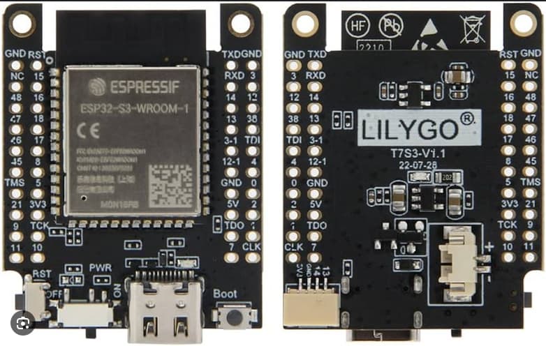

The only one I can currently find is this S3 Supermini board, it has just enough pins and will run at <1mw when asleep on the internal battery as it only runs the 3.3v rail. I’m thinking of possibly getting a pair of them and splitting off the nav code like managing the GPS receivers, AIS and BMS from all the communications and management components as I never have enough serial ports for everything I want to connect and i would rather not have to mess with software serial ports.
Currently, the sun is only getting to 19 degrees above the horizon, in a months time it’s barely going to get 10 degrees above the horizon and It’s going to get much colder, so I think realistically the rover is going to be able to do one lap per day, but even that might not be possible if its cold and overcast for more than 2 or 3 days.

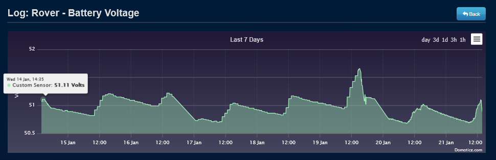

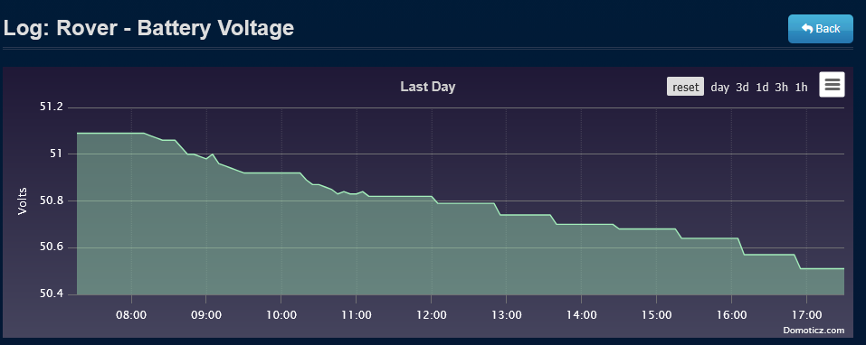

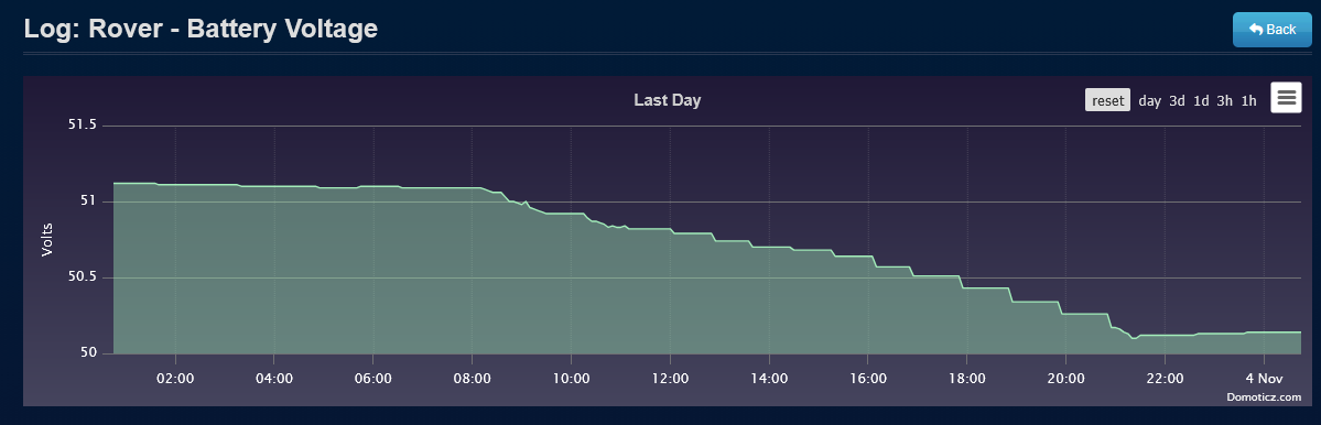

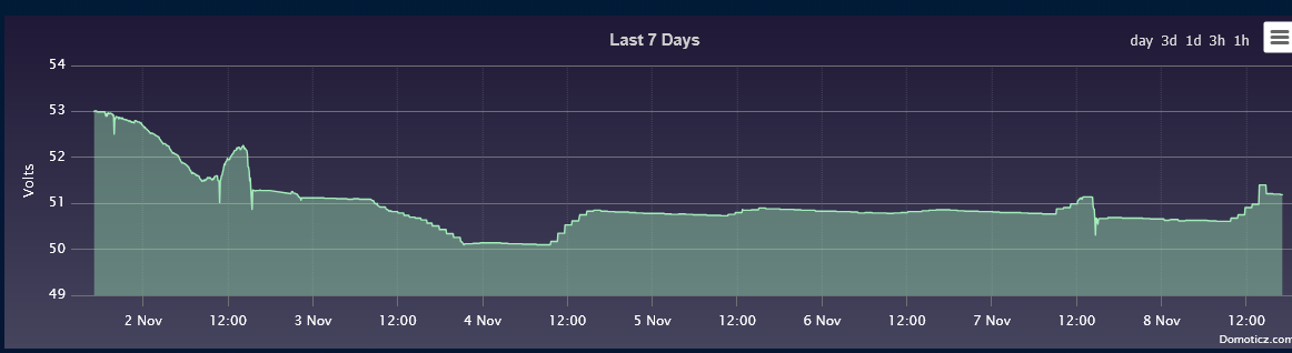

After looking again at how fast the voltage was dropping I initially thought it was just the cold but the battery was unusually warm I realized there had to be something else switched on drawing far more power than 1w, and I think what has happened is one of the motor controllers has been switched on by mistake.

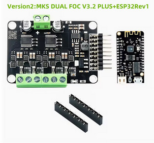

When it switches on the 5v power rail the hoverboards will power on and off a second later, I think while messing with scripts I have managed to switch the power on and off fast enough that it cut power before one of the hoverboards was shut down. I haven’t noticed it on since all the telemetry from it goes via mavlink to the hoverboard controller then to the flight controller that were both powered off so I had no way of knowing that it was on.
I had also just changed a sensor in domoticz for battery power from mA to Amps, and because of that the graphs essentially stop working so it was best to make a new sensor then change it on the rover when It’s next in. it was still giving calculated consumption that is basically power from the battery - power from the solar but that wasn’t sent when in sleep mode as I didn’t think it was critical information, but that has also been rectified for its next update.
When I realized what was happening I have done a power cycle of the hoverboard auxiliary 5v rail that powers the Mavlink Serial splitter and hoverboard controller and when it went to sleep again the voltage stopped dropping.

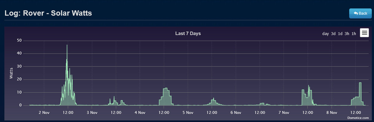

It’s been outside for a week now and things are looking ok so far, its just been asleep most of the time to save power, but I have done a lap of the garden just to make sure everything was working. some minor issues like the camera switcher and gimbal pitch not working, but I think that’s just a loose connector in the gimbal.
It has been overcast and raining for almost a week now. It’s able to sleep and keep charging the battery, but it’s only just bringing the voltage up.
The battery is 48v 20Ah or 960Wh, at its current rate it will take around a month to fully charge, compared to the summertime where it can fully charge in a day. the weather was so bad on friday that the solar inverter never got above 2W a barely 1% of my panels capability.

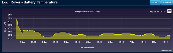

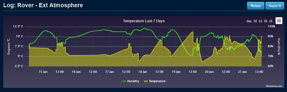

On the bright side the temperatures have been mild, so the battery has stayed above 10c keeping the heater off and saving power.

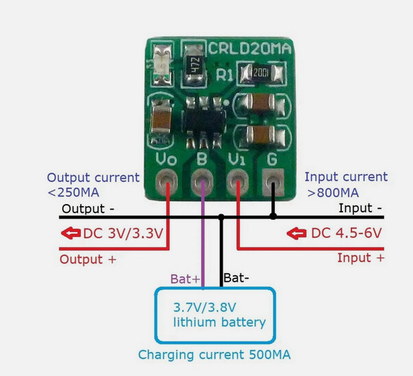

I had a look and found this little 3.3v battery module that should work as a sleep battery power source, I should be able to just attach it between the 5v and 3.3v rail along with a protected lithium cell.
I have already ordered the s3 supermini boards so im going to test them but if that’s problematic this is going to be plan B, it should stop that slow voltage drop through the night by reducing its sleep consumption from a 1w down to 1mw.

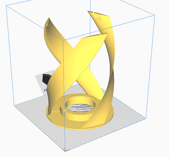

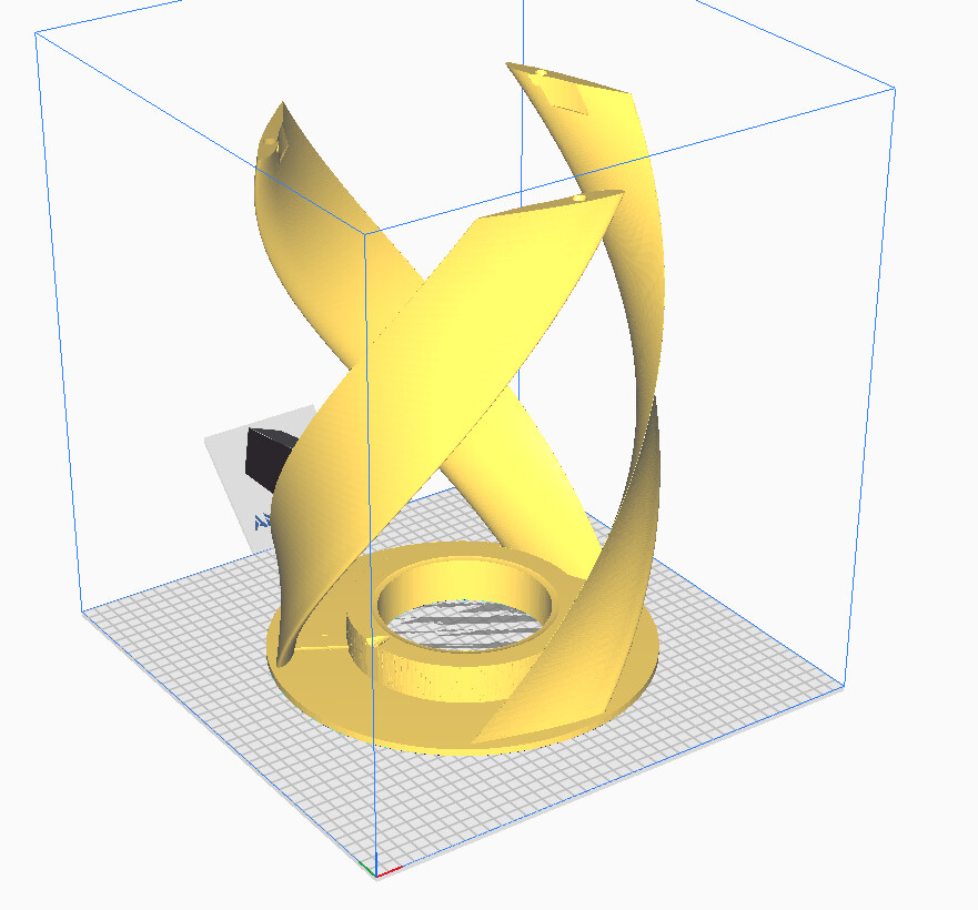

After looking at all the wind turbine options, I decided to just try and build one, as even the cheapest generator that might work is going to be a decent amount of money, and it still might not actually be useful. So after some googling I found some hoverboard turbines, I have a box of hoverboard wheels I saved up when they were going cheap so this looks like the best option for something to test. I couldn’t find anything ready to print that I liked. So I basically just took a vertical wind turbine and a hoverboard tyre off of thingverse then joined them with a flat plate. I can add more sections to make it taller, but hopefully two is enough to make a couple of watts. The hoverboard axle and bearing is very strong so i dont have to worry about the loads on it. its going to be a 3 day print for the first section.

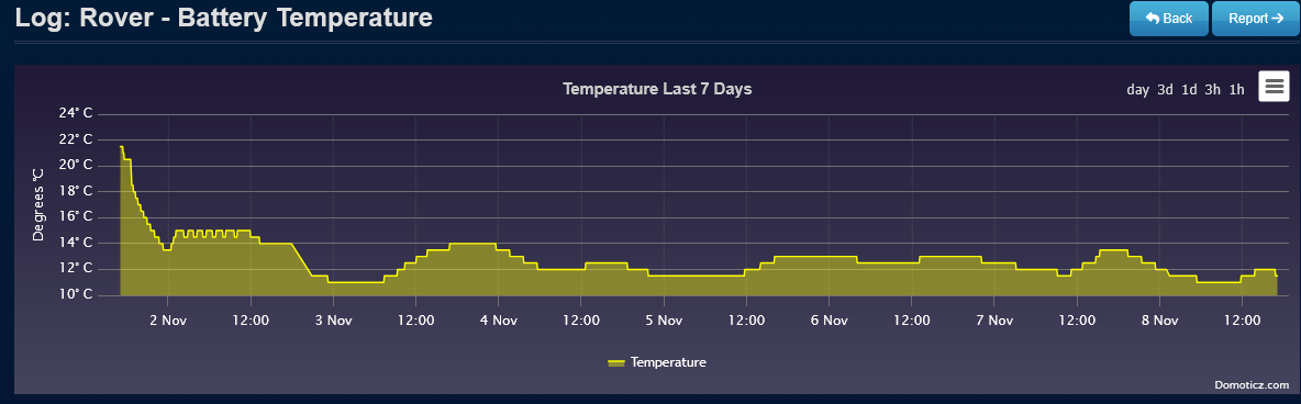

I have extended the functionality of my battery heater, it occurs to me that after a cold night there is a huge amount of condensation on the grass around the rover in the form of dew, and after checking the sensors I could see that because my battery was so big and well insulated it could stay well under the dew point for many hours risking water condensation forming on it. So I am testing if I have enough power to keep the battery temperature above the dew point of the air around the rover. it should also keep all the electronics at either side of it above the dew point also.

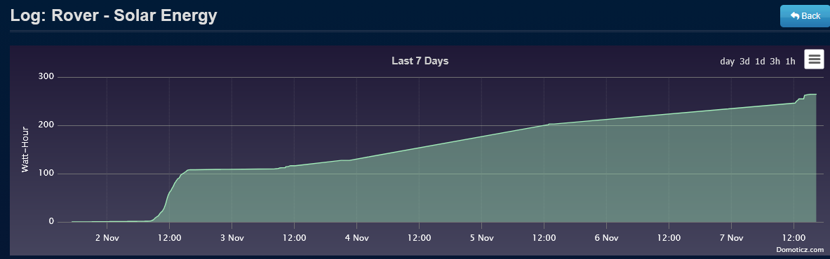

It was outside for around a month, with its more sophisticated power management it can sleep most of the time while still waking up every hour to give weather and sensor readings before going back to sleep, because its consumption is so low it can still charge the battery with only a few watts of power.
What I thought was its controller crashing was actually a programming error where it ended up going to sleep for 3600 minutes rather than seconds, so if I had waited for 60 hours, it would have eventually woken up itself.
It was then put outside again but now its below freezing, and it eventually ran out of power. Due to the cold weather and high humidity there is a thick layer of frost on the solar panels that takes a long time to melt so it’s only making a few watts for a few hours It’s not enough to run the heater and keep the battery warm. Once the battery gets too cold the BMS low temperature protection will cut it off meaning it cannot charge until it warms up and there isn’t enough power to do that. The backup batteries still have power, but it’s immobile without the main battery and reduced to just reporting voltages and temperature once an hour until the ground defrosts and it goes back above 0c where it can start to charge.
Keeping the battery warm enough to charge during the day clearly is not possible when it’s too cold and dark as it can’t generate enough power to keep it above the 0c minimum charging temperature. so it might be a better idea to just keep it asleep and just skip charging altogether, since it’s using more power to heat up the battery than I’m getting from the solar panel. The batteries should be ok down to -20c for discharging, that isn’t a problem since it never gets below -10c here.

My plan of printing a wind turbine got derailed due to a broken wire in my 3d printer causing the print to fail after a few hours. Even if it can only generate 2 watts, that would be enough to keep the battery above freezing so that will be getting printed as soon as the new wiring harness arrives.

I have made a lot of progress with the Realtek amb82 mini AI camera board, I finally got multi-threading to work, this controller was essentially useless without it since the whole loop would just stop when it started communicating with any servers. Unfortunately there are no examples on how to make this work but I found in the OTA update sketch that they have implemented threading but no documentation exists about it. So just deleted code until all I was left with was the threading code then I could use that as the base for everything else. I managed to get the LLM example they provide for ChatGPT example to work with ollama on my server, this means i don’t need to pay for an expensive cloud service as it just runs on an nvidia GPU. For just asking “what do you see” even the smallest vision models work It’s when you want specific answers then you need to use the large models and running that every few seconds on a paid service gets very expensive.
my ollama and threading examples have now been added to the official repository.
Since I have JSON working on it now I can now send and receive data to my automation server like the esp32 does, now I can control what model it uses, the prompt and what to do with the data without re-flashing it. it also logs all the replies so it can now keep a log of what is happening. I will add a few prompts to log like “describe the weather” or “if there any obstructions ,what way should I turn to go around them” then an option for what it should do with the information, hold, rc override, guided mode or proximity. and probably something for what it should do after the action is over like return to auto mode or stay in guided.
With multi-threading now working I can move the LLM stuff onto its own thread freeing up the amb82 mini, Its a 500mhz cpu and 128mb of ddr2 so its got an insane amount of memory for an arduino
board so it should have plenty of power to run the lidar, gimbal and RGB LEDs, that gets rid of about 3 other micro controllers from the rover and it simplifies the wiring significantly.
I want to get the Rover talking again so when people come up to it can do things like read out the weather or other basic data like waypoints and flight modes without having to generate it each time on the sever and use power. I have recycled most of the talkie code I was using before but instead of synthesizing the audio it’s just playing a series of mp3 files on the amb82mini. This took some time as I needed to convert and find files for the talkie words. For the numbers and a lot of ardupilot related words I just reused the EDGETX voice pack, but there were a few non RC words like weather and ardupilot modes that needed custom words from a voice generator. It can do AI generated speech via googles TTS server for things like status messages and alerts but I’m working on getting that moved to either one of the onboard pi boards or my server.
mavlink messages are now logged on my server so i don’t have to dig through flight controller logs.
I finally got around to getting another LTE simcard for it so it will be able to go further than the garden. The current logic is that when it starts up it will attempt to use the Halow wifi connection and if that fails then it will switch to the 4G LTE connection, if that fails it will switch back to the wifi, this will repeat a few times then it will go back to sleep for 10 minutes then repeat until something connects.
I have still to get the BMS wired in properly with isolation so that power doesn’t go over the data lines when the battery negative cuts off.

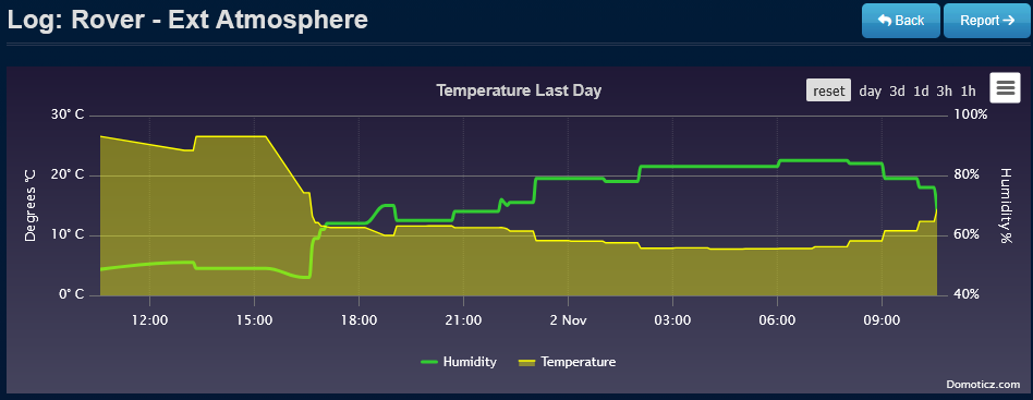

still got a few weather sensors to get fitted, including wind and lighting.
still to make it chat, I have an esp32 doing chat with voice transcription and TTS but I want it to do it from its onboard pi or locally from my server rather than having to use online services.
I need to finish its control scripts for things like when to move, when to sleep, what to do when moving, I have separate scripts for each action but I need to add them all together into a useful series of steps that it can use to figure out what mode it should be in and its next move.

It’s been outside for around 2 weeks and it’s been working ok, with it waking up every hour with all the sensors, sending readings then going to sleep it can just generate more power than its using. driving it just isnt viable with such a low amount of power.
Luckily temperatures have been mild so the battery heater hasn’t been needed, its well insulated now so its temperature is much more stable than outdoors.
Unfortunately I went to drive it today and its not starting, I’m not getting heartbeats from the hoverboard manager, This is the RP2040 that switches the hoverboard relays and converts the hoverboard telemetry to mavlink. It’s probably just a bad connection somewhere, but I have been looking to replace the hoverboard motor controllers for a while, they are cheap, but they are very inefficient, hot, unreliable and need a lot of supporting hardware to manage them like a bank of relays just to turn them all off and on.
Tthe best low-cost controllers I have found so far are the esp32 SimpleFOC boards. I wrote some code for them back in may to work like the hoverboard controller using mavlink Servo input but I never tested past making a wheel turn on a bench using open loop velocity mode, This was just sensorless mode as I couldn’t get the hall sensors to work properly as the motor would just jitter whenever they were connected, so I just sat the controllers to the side and worked on other problems.
I wasn’t in a great hurry to use them as I had managed to burn 2 controllers at that point, since you are controlling everything, if something switches wrong it will just short a motor and fry instantly, and due to the hall sensors glitching that would happen almost instantly and smoke the board. After the second one I realised that testing with a current limited power supply was essential to stop it self-destructing, The libraries were also very out dated and needed old versions of the esp-if to make them work. after getting nowhere with the hall sensors I just sat them to the side. The problem was sensorless mode used a lot of power and would slip so it just wasn’t practical to use on a rover that needed to be efficient. And there was almost no documentation on how to use hall sensors with simplefoc or documentation on the controllers on even simple things like what pins to use so it took a lot of time and effort to just get a wheel to turn.
With the recent glitches and overheating of the hoverboard controllers it made me go back and have a look at them to see if i could fix the hall sensor issue as its something that had been annoying me as a little unsolved mystery. So with a hoverboard wheel clamped to a desk and the controller hooked up to the PC and a power supply I started testing…
First thing was to just verify that the hall sensors were connected and changing properly when the wheel turned. so i made this very simple program to check if they were doing what they were supposed to be doing and everything looked fine.

With the never ending quest for efficiency I have been looking at the pi boards I’m currently using, at the moment I’m using 2, one for my cameras and one just for telemetry, it’s not ideal. They only use a few watts but with 2 of them that adds up to more than I would like. I have been looking to find a low power alternative like esp32 but I haven’t found many viable solutions. The idea I looked into a while ago was to try and use a ESP32 as a VPN client to connect the rover to my local network over the internet. There are a few esp32 VPN repositories out there but most are unsupported and extremely out of date and required almost all the CPU flash and ram on the micro controller making it of limited use.
Since it was about a year ago since I had a look again to see what was out there and came across Husarnet, it’s an IOT VPN service its peer to peer so you don’t need a server but most importantly they have an up to date esp32 library. So combined with some code that converts TCP to serial and back again I now have a way of controlling ardupilot across the internet with just an esp32. It’s still really heavy for a micro controller and I have struggled to get the library running with the rest of my code without it running out of ram or memory. so i will probably just have it as a separate esp32 device connected to the flight controller rather than doing it on the main esp32 controller. its not ideal but it’s still less power than a pi. Husarnet is free for up to 5 devices at a time.
By replacing the motor controllers and the pi boards I think I can cut its driving power consumption by over half.
It also works for ESP32-Camera boards for integrated video and telemetry but its got a lot of latency on the video.
