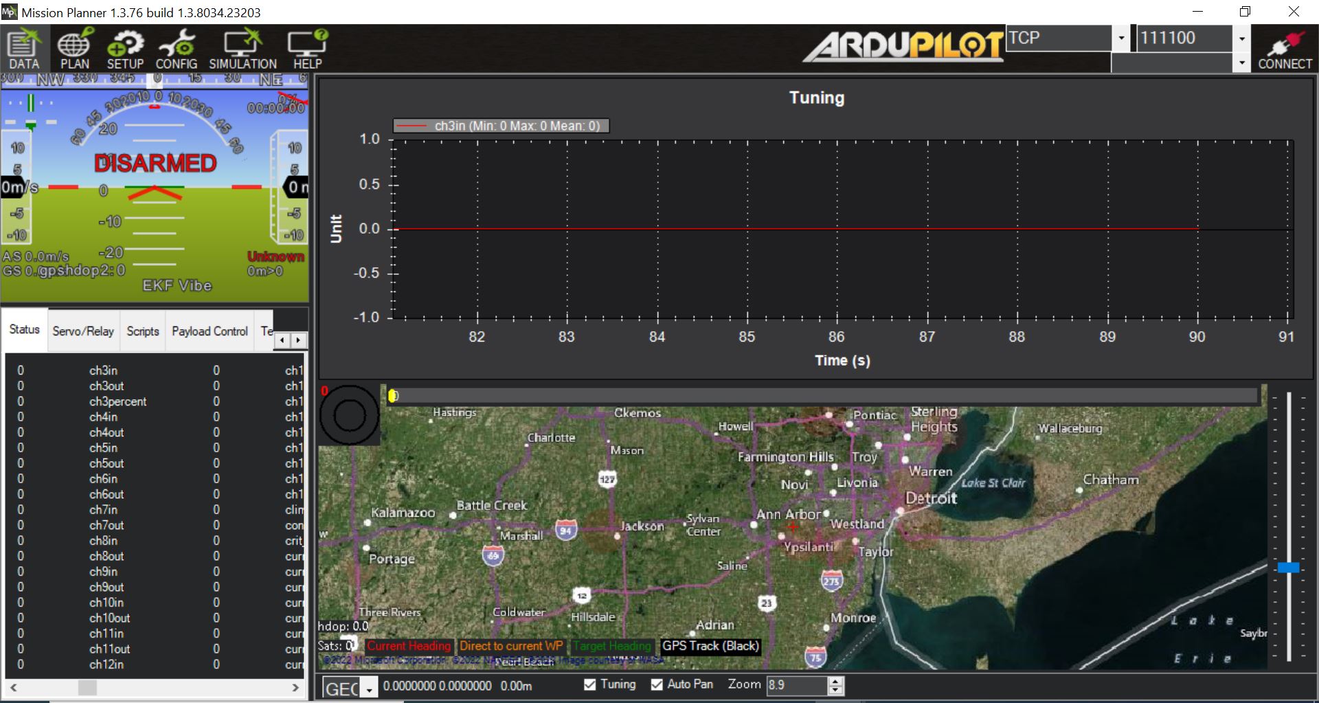

Is it possible to see in real time the RCIN3 (throttle) in mission planner?
Sure with telemetry. The Status screen and the Tuning graph will show it. Both seen here:
