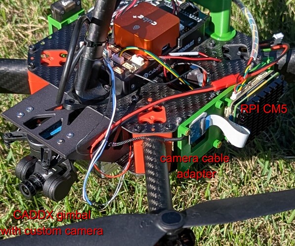

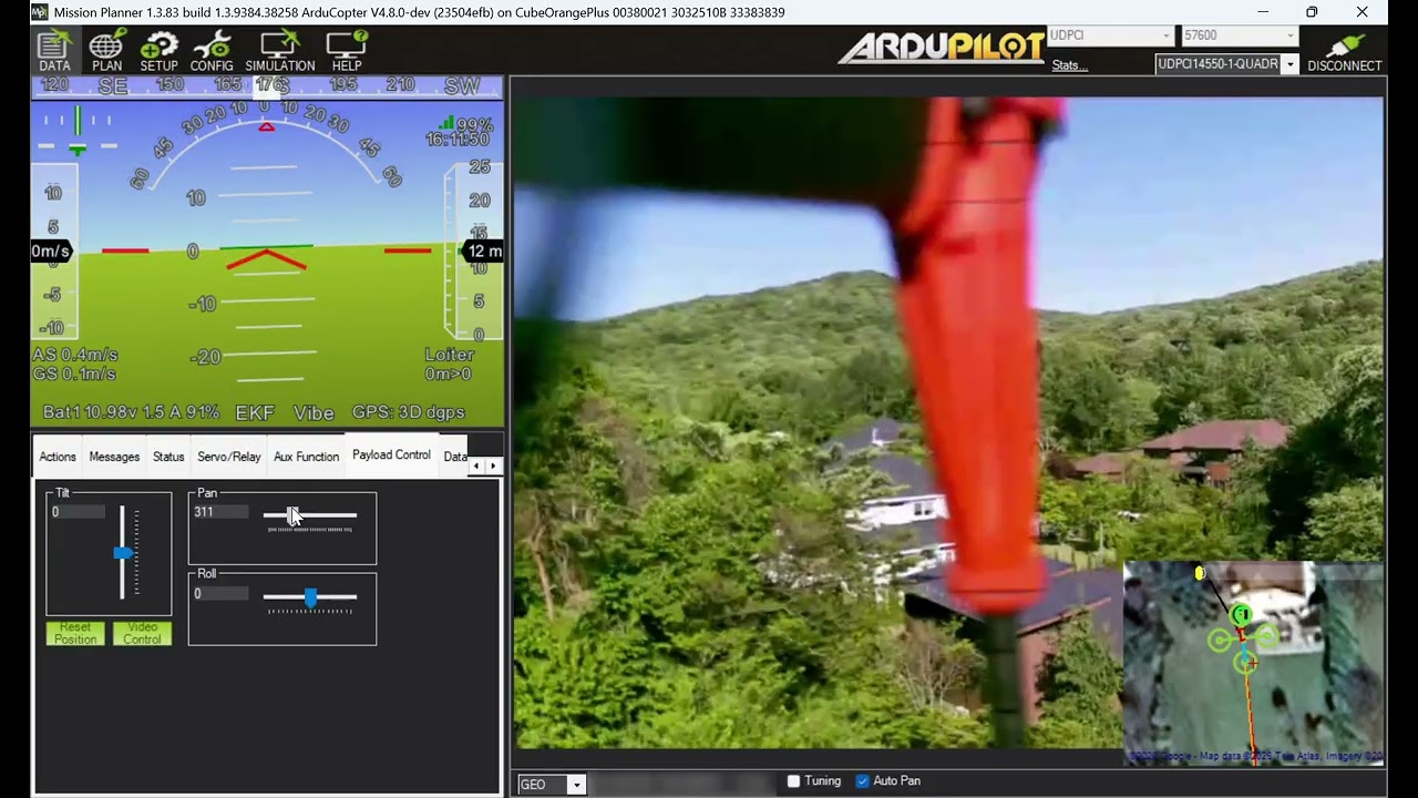

Small RPI compatible camera gimbal
The video above demonstrates a small custom Sony IMX415 CSI/MIPI camera (a bit like this) mounted in an CADDX camera gimbal and directly connected to an RPI CM4 running Rpanion which allows the camera to be used for live streaming to the GCS, taking pictures and recording video. In the above video Wifi is used but it could have been LTE just as easily.
As far as I know this is the smallest brushless gimbal-mounted camera that can be directly connected to an RPI companion computer (please tell me if I’m wrong!).
The hardware setup is shown on my development copter below (sorry for the messy wiring) but in short the camera, like all other cameras that fit within a CADDX GM3 or XFRobot C20-T camera gimbal, has a Hirose DF56 connector but instead of these pins providing analog or digital video, they provide CSI/MIPI. Then there is a small adapter board that maps the Hirose pins back to the standard RPI ribbon cable, which can then be connected to the RPI CM4/CM5 (in this case mounted on an OchinV2 Carrier Board). With a modified RPI custom carrier board it should be possible to remove the need for the adapter board.
In case you’re wondering why I’ve done this, it is part of my Aerial photography copter, which requires a small camera gimbal that supports:
  • Real-time video over Herelink or LTE
  • Records in 4K
  • Picture and video uploads to the cloud
The first prototype shown at last year’s dev conference used the XF Robot Z-1 mini which was fine but it did not give us full control of the camera’s image quality and frame rate, which is important for getting the best quality live video over LTE
A Taiwanese company developed the camera for me and I suspect they will sell them directly eventually but in any case I will also sell them through JapanDrones. This is not a promotional post to increase sales – I’ve primarily done this for my aerial photography copter but I’m happy to make them available to those who would like them. It may also work with an Nvidia companion computer but I haven’t tested that yet.
BTW, if you are interested in the camera, here’s the Hirose DF56 to Ribbon Cable to RPI pin mapping. I’m also planning on having a Sony IMX 477 version made which should have better image quality.
DF56 Pin DF56 Desc Ribbon Pin # Ribbon Desc CM4/CM5 Desc CM4/CM5 Pin # Notes

nice work !
At that point, any small ip camera will do the job and prevent to carry an RPI+CSI cable which are very fragile. I guess it depends what the camera spec you need.
Hi @khancyr,
Thanks! Ah yes, this reminds me that I forgot to mention that I’m planning to have a Sony IMX477 version created as well which should provide slightly better image quality than the IMX415 in the current camera.
The IP camera is an interesting idea but I’m not aware of any small enough to fit within a brushless camera gimbal.
There are those kind of camera poe ip that should fit probably (I haven’t check)
It looks to have a fairly big SoC board.
I would consider OpenIPC boards, while they use an extension wire (I guess MIPI/CSI) it is supposed to be standardized with the onboard Arm SOC it should be possible to connect one to an LTE modem (likely by replacing included WiFi one.
Hi @khancyr, @LupusTheCanine,
Thanks for the comments and links!
The linked camera poe ip is much larger at 53mm x 45mm compared to mine which is only 19mm x 19mm. The IP camera alone is almost the same size as the whole package I’m using including the gimbal.
For the OpenIPC boards, from a quick search this is the closest but it uses a standard ribbon cable that can’t easily be threaded through a 3-axis gimbal.
The XFRobot C20-T (or CADDX GM3) is only 46g and the camera is only 10g so 56g total. Its dimensions are 46.8mm x 46.4mm x 53.4mm.
It’s still unclear but I think this is more evidence that what I’ve demonstrated is the smallest brushless gimbal-mounted camera that is compatible with an RPI (and perhaps NVidia) companion computer. It’s not perfect but technically I think it’s the smallest. I’d love to be wrong of course.
Thanks!
haa, yes with the dimension … you build is indeed smaller ! From the picture, I was seeing bigger. Anyways that is great to have multiple choice !
This one has 14mm camera, the board is 30x30 and comes with a WiFi module soldered directly to the USB port but replacing it with LTE one should be possible if there are drivers.
Hi @LupusTheCanine,
Thanks for that. It looks OK.. but of course the camera is not mounted on a brushless gimbal right? With or without a gimbal is a large difference I think.
I wish I had gimbal this small, IIRC it would have to weigh less than 15g to meet my takeoff weight goal :sweat_smile: of 250g. My point was that the camera has a gimbal compatible cable.
