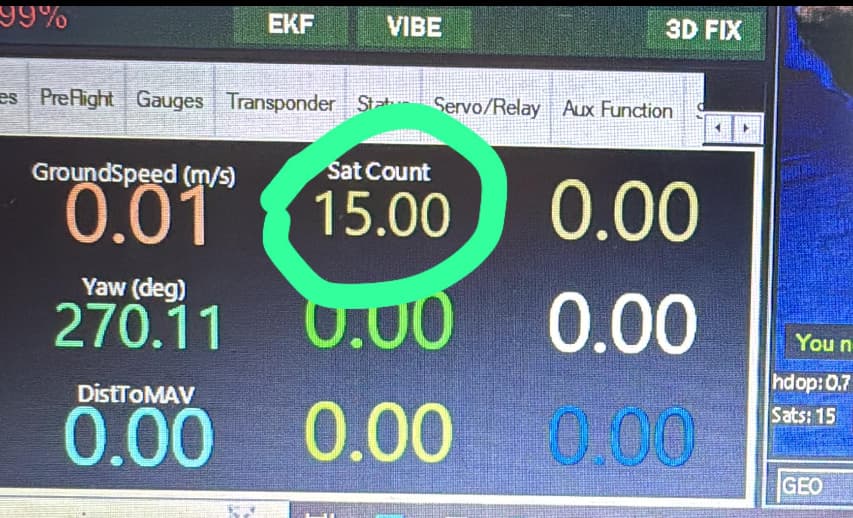

Tested and Successfully the receiver was the problem as I just remove the 5V wire we got immediately 3d fix with 15 sats indoor, many thanks to bring this idea… :+1:
This one make heavy interference :sob:

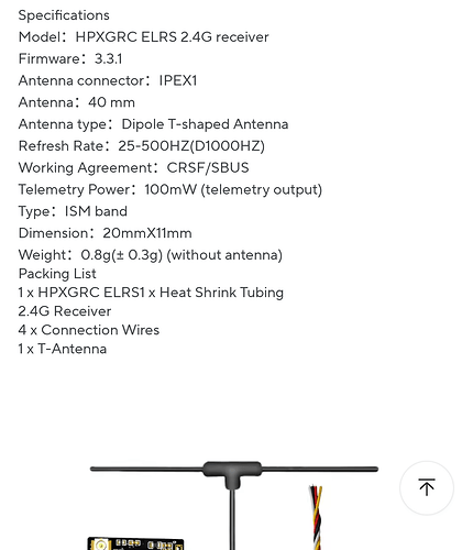

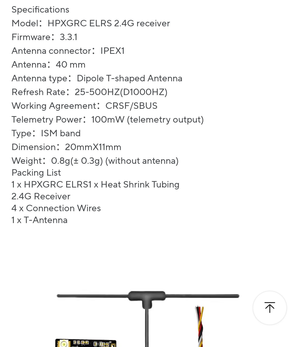

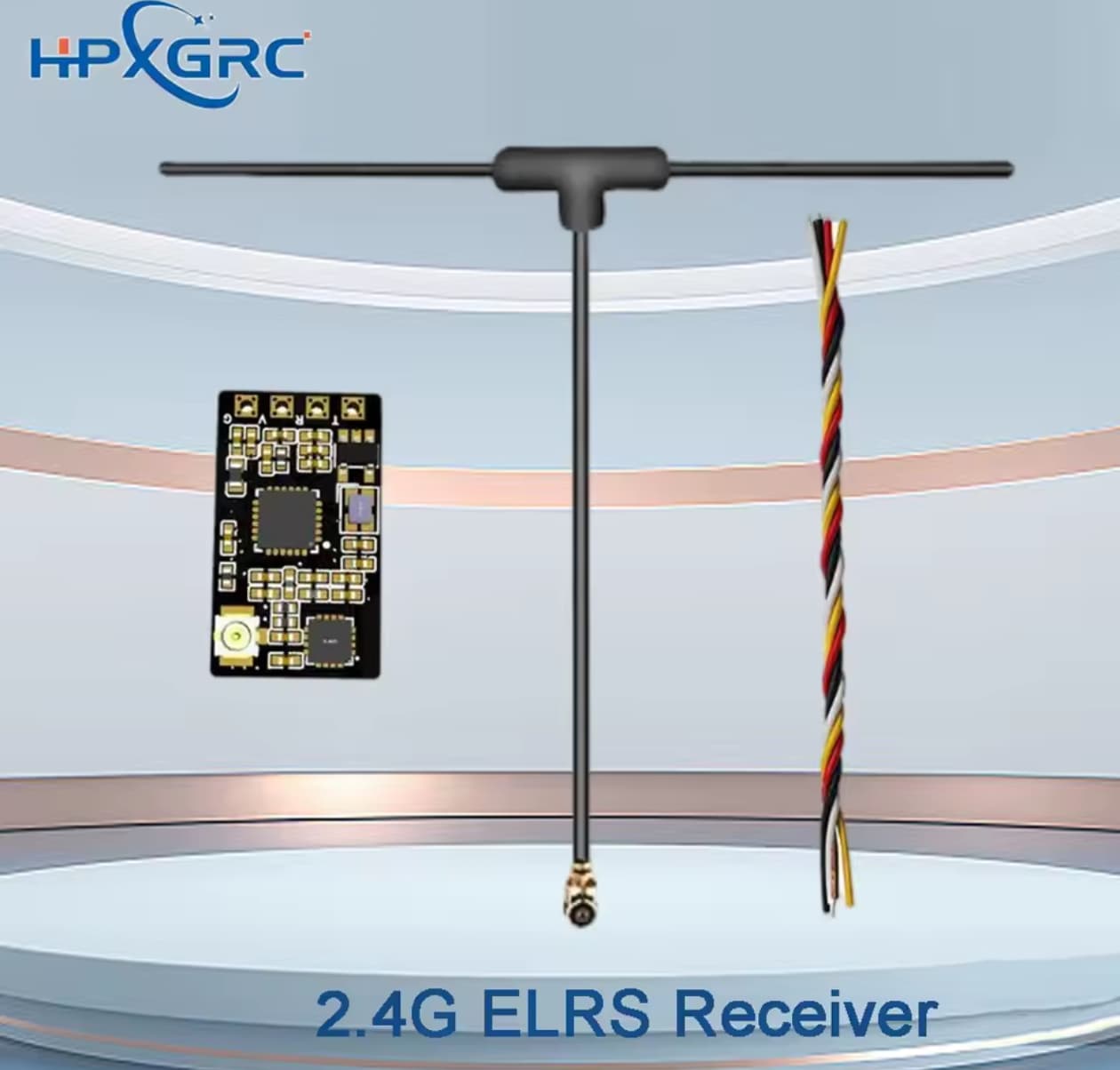

Which ELRS receiver is that?
What packet rate are you using?
You can try different packet rates and see if it makes a difference.
Also I suggest in ELRS lua go to Other devices, select your receiver, and tell us what the Tlm Power is set to.
I suggest setting it to MatchTX so it automatically stays at lowest power unless it needs to increase, this will lower amount of interference for GPS. For this to work you have to have dynamic TX power enabled as well.
I already desolder and wiil replace with betafpv diversity old one I have and will test.
