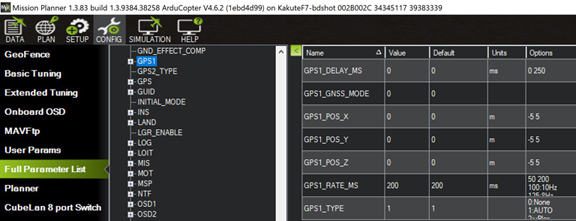

GPS take very long time to get enough sats for 3d fix currently using iflight blitz m10 gps with speedbee f405 v4 and it’s very slow getting 3d fix in addition previously I used in GPS_TYPE to be set to ublox and it was helping but with latest firmware this parameter doesn’t appear!!
What do you mean it doesn’t appear?
Ok it now GPS1_TYPE instead of GPS_TYPE as my old build.. Thanks
Any other steps that can Improve GPS signal reception.
What do you have for GNSS Mode?
The parameters is GPS1_GNSS_MODE =0
Try enabling a couple of constellations that work where you are. 0 means it whatever the module is internally set to.

Your table is a bitmask so the line “0 GPS” mean bit number 0 hast to be set for GPS.
If you want only to use GPS you have to set bits 0000 0001 which is “1” for the GPS1_GNSS_MODE setting.

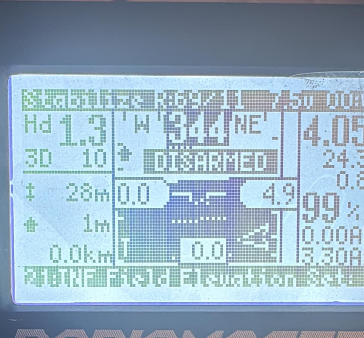

What happened today after change GPS1_GNSS_MODE =1 it get immediately 10 sats but again start to decrease to 7 sat then no lock for long period I will test again tomorrow in another location.
Ok many thanks I will change and test it tomorrow.
