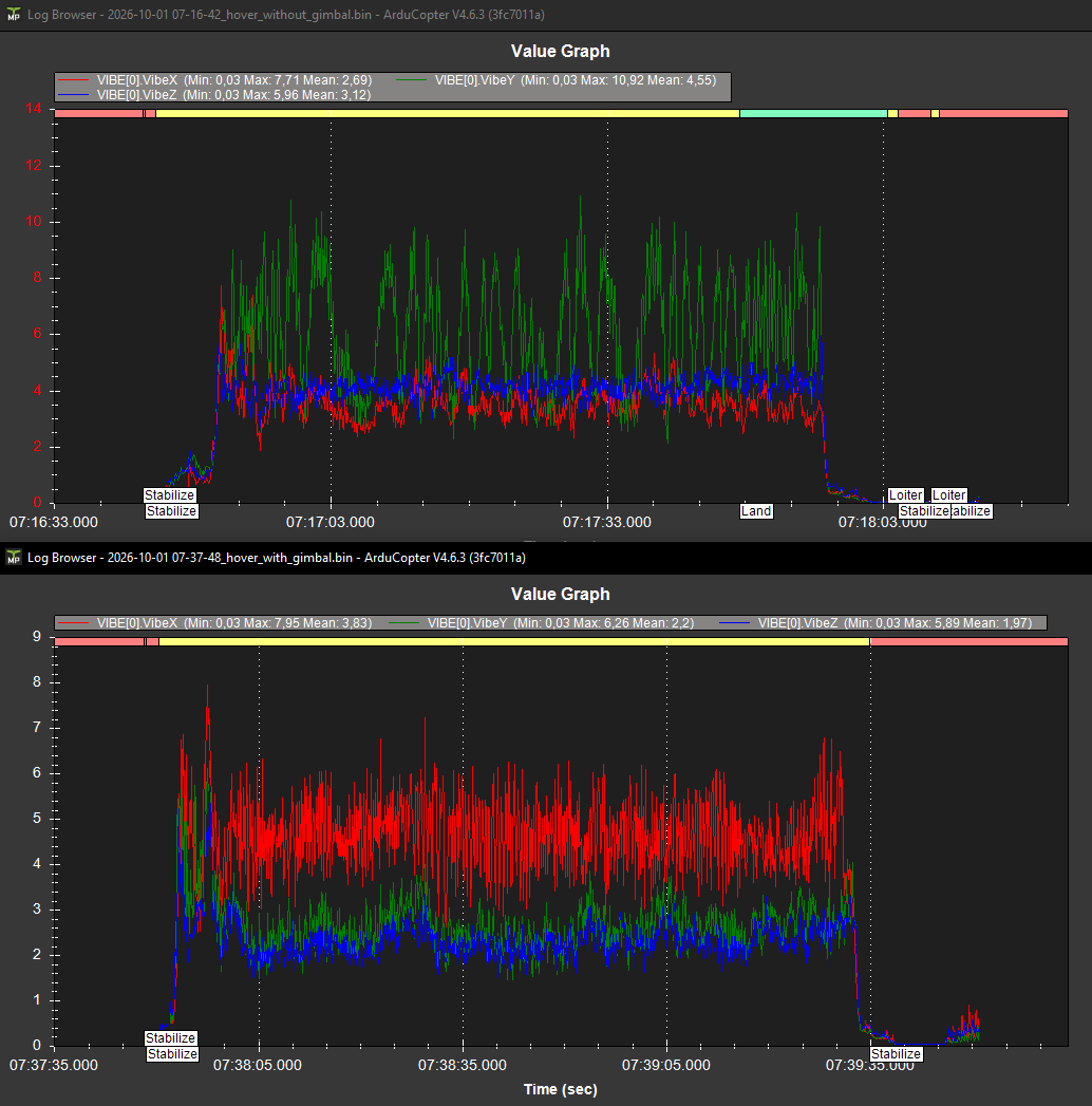

Slight shake of drone
Hi!
I have a quadcopter that was tuned with AMC some time ago. The drone carries a MILC camera for aerial photography. The drone flies good, except one thing: in the air it shakes a little bit. At fast shutter speeds it can be tolerated but in lower light with slower shutter speeds this is an issue.
The camera is mounted on a gimbal, the gimbal controller is Storm32BGC. This is also configured and tuned.
Drone parameters:

Whithout gimbal there is a small vibration on Y axis, with gimbal this vibration reduces and the vibration on X axis increases. However, the vibration on the mentionex axes is also acceptable, according to Ardupilot documentation: well below 30m/s/s
Can you please point me some direction, where to move forward to reduce (the best would be to eliminate :slight_smile: ) this shaking behaviour?

First, on vibration objectives. If you want to have a smooth crisp clear footage, you have to become stricter on vibrations. Vibes of “below 30” is a requirement for the flight controller to still see the gravity vector. For video, you want them much lower than “below 30”, I would say that “at most 5 in hover” is a better objective, especially because they typically get somewhat higher when not hovering.
Your vibrations are not extremely bad, though the vibe profiles with and without the gimbal are remarkably different, and the “without” profile is worse. Which indicates to me that it’s not the gimbal which adds more vibrations, but that the machine was tuned with the gimbal present, and it feels unhappy without it. In which exactly configuration did you AMC your machine?
There is at least one indicator that the machine is tuned suboptimally. The value of ATC_RAT_YAW_FLTE is 1.0, which is its minimum, which means autotune of YawE essentially failed. One of the possible causes is poor yaw authority. From my observations, in such cases the result of autotune really depends on the initial values (a term “attractor” is not totally inappropriate for this process), and this is something one has to perform some guesswork about.
Related to that, in the flight with the gimbal, P and D contributions in pitch and roll are very low (the I contribution frequently outdoes them), which on its own is not yet too bad - but again in my experience with reasonably well-built machines this is an indicator that you are filtering too much, and the controller does not care about high-frequency noise - which may be reaching your gimbal, and which may have been compensated by reducing the amount of filtering applied and achieving tighter control.
In the flight without the gimbal, the contributions are still not extreme, but unlike the gimbal case, there is much more D-term than the P-term. This is what made me think you were tuning with the gimbal attached. Removing mass from a tightly tuned machine typically makes it unhappy about that. If you need both operation modes, either tune for the lightest one, or for both separately and switch tunings.

One such detail can be seen clearly in the noise plots. There is something in roll, which is seen as an uncompensated red-and-blue peak spanning 25-40 Hz here:
As not too much of different flight regimes were tested, I cannot say it with 100% confidence, but most likely it is a physical resonance. Before trying to fix this in software (with FILT1_* and ATC_RAT_RLL_NEF), you should try to eliminate the mechanical source, which will give better results. (By the way, it is not in the gimbal, because on the gimbal-less flight it is still present).

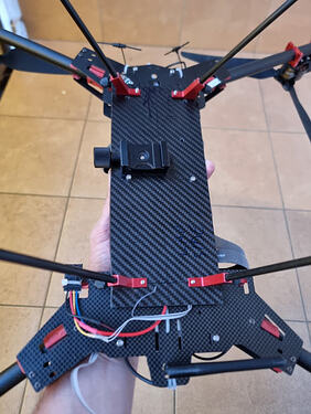

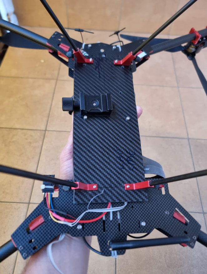

The frame is from Aliexpress, and as I assembled it, noticed that it’s not very rigid. I haven’t flown in this state of the frame.
I added a 100x250x3mm carbon fiber plate to the bottom of the copter to improve frame rigidity. It helped a lot!

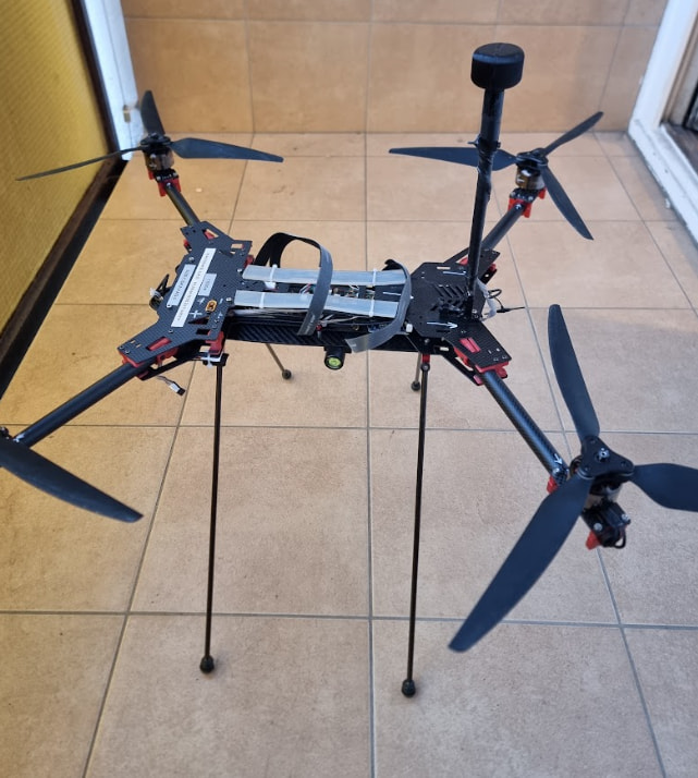

There are two protruding parts from the frame (besides the gimbal) :
  • GPS holder rod, on the top of the quadcopter
  • Four legs, at the bottom of the drone
I can make test flights without the legs and I try to fix the GPS holder with some adhesive tape to see the effect.

These flimsy legs with some weight at the end can indeed contribute to the performance in a negative way, you would surely benefit from using something else. For the GPS holder, I have no idea how impactful this one in particular is - my gut feeling is “not so much”.

If you want to increase torsional rigidity of the center section, you should add side walls instead.

  1. Replace those legs with something sensible, and perform a flight with existing settings to confirm the roll peak goes away (if not, continue searching for where that comes from). This would also be a baseline for the following step.

In my experience those frames are known for flex. You can buy another frame kit and double up the top and bottom plate, I do this and add a bit of glue between the plates and this has made massive differences with frame vibrations and rigidity.

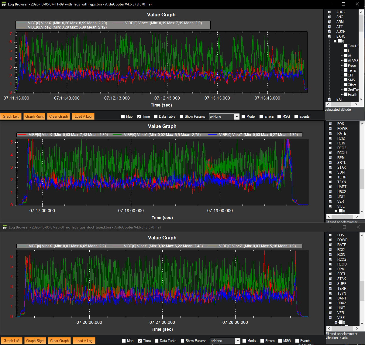

Hi @MaxBuzz
I had a little time out on the field.

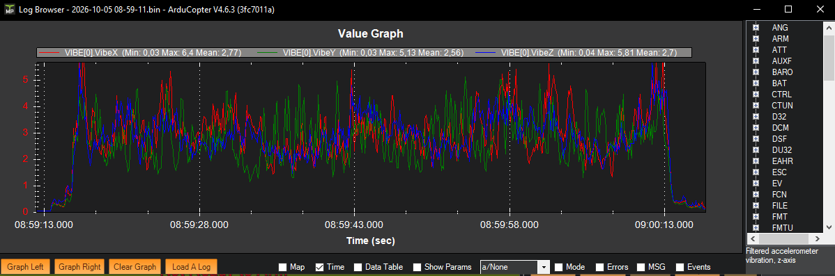

  • Gimbal was never on the drone.
  • I started with removing/fixing components on the drone.
The top chart is with landinggear and with GPS holder
Second chart is without legs, with GPS holder
Third one, the bottom: without legs with duct-taped GPS holder.
It was a little bit surprise, that fixing the GPS holder did not made it better.
Removing the long wobbly legs was slight improvement - so I let the drone in this state when I started to change parameters.

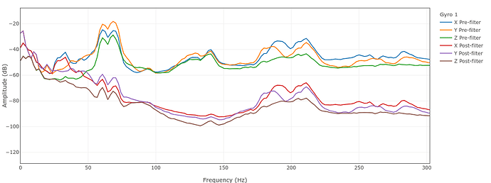

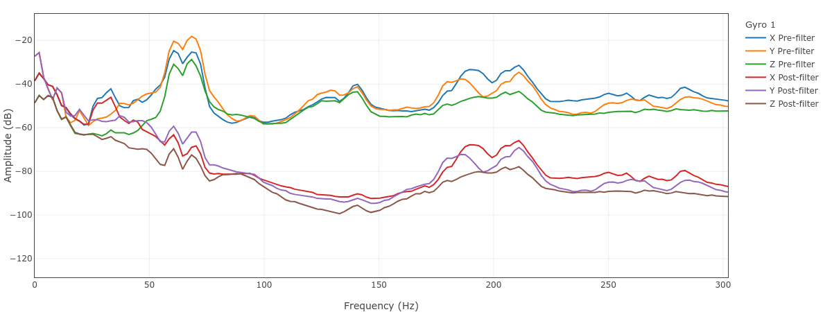

Next I started to change parameters and arrived to this state:
  • INS_GYRO_FILTER,120
    Actually, this parameter change shifted the filtered signals in Filter Review close to -50dB.
  • ATC_RAT_YAW_FLTE,2
  • ATC_RAT_YAW_D, 0,031851
Flight log: https://drive.google.com/file/d/1voV0rllS60GTm0joxB7Mlp4NT_IYd9YJ/view?usp=sharing
As mentioned above, the GPS holder was not fixed with duct-tape, when the drone started to slightly oscillate, the movement of GPS holder was a good indicator.

@LupusTheCanine thanks for the hint! I can solder a strip of FR4 PCB to the standoffs between the two plates. I’ll definitely give it a try!
