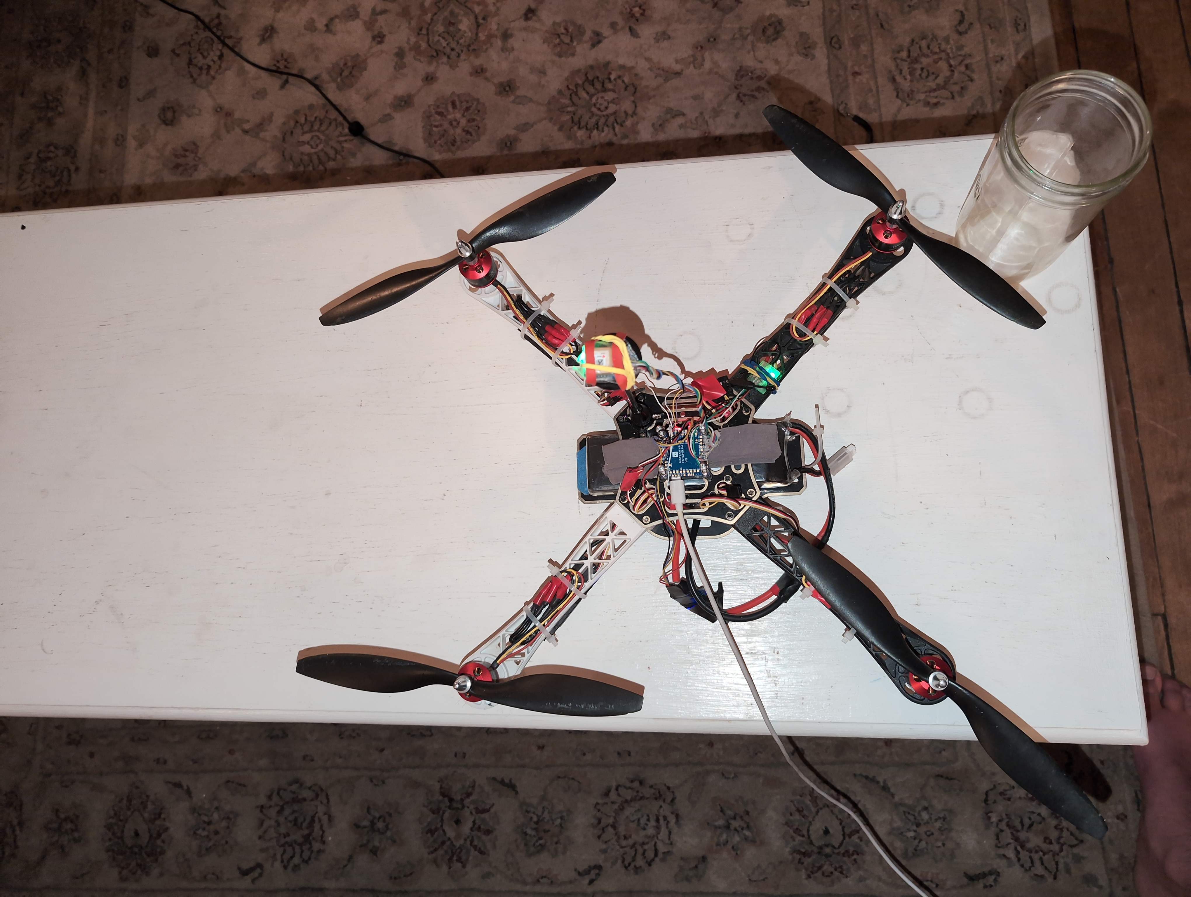

As for the imbalance in the frame, I cannot find a major source of imbalance, the only potential imbalanced I see are the GPS mount or the loose power wire.
Photo of the drone

What arms are those? Years ago when I had one of those junk frames I tried different arms. Some were twisted out of the box.
I’ve also flown one of those. An S500 with those plastic arms. They suffered from lots of vibration issues. If vibrations are not too high on this build, one could assume the mechanical vibration dampening is quite good, maybe too good. @Bloxxer, how is the FC mounted. If it’s mounted too softly, it could cause the FC itself to move around which in turn could cause all sorts of issues.
It’s an aliexpress knock off f450, the arms came like that with two different colors. I can’t remember the material but it was something like nylon fiberglass? The aliexpress listing is down now. Also I apologize for not being able to actively diagnose the drone, I am away for a week. Do you think I should try a different frame or arms?
The vibes are acceptable on this drone, usually below 30 and often below 20. I use a 40x40 => 30.5x30.5 mounting adapter with silicone grommets in the fc’s screw holes. I don’t think the fc is moving that much, though, pressing against it only moves ~2cm.
Yes. But putting other arms on those frames is like lipstick on a pig. I had some solid G10 arms at one point which were very rigid but that just chased the compliance back to the frame. Hardware To Avoid
You really mean 2cm? That seems lite lots of play in the mounting. Sure you don’t mean (mm)?
It’s also worth mentioning, if you can’t change the arms, you could still get the thing to fly decent. But you most likely won’t be able to use autotune or any other automated tuning script. Flex in the frame or arms can really throw it off.
I have been there, with flex in the center-hub of the frame. It flew quite great but autotune couldn’t get anything right.
Vibrations between 20-30 should generally be looked at, depending on what you’re going to use the drone for.
yeah mm sorry. about the same mobility as any m4->m3 silicone grommets give

A more ridged frame would improve your experience of ardupilot. But you cold try to tune it some first to see if you get any good results. Shawn, (xfacta) is really great at tuning. Try his parameters before jumping the gun on a new frame.
The great thing about trying to tune out a hardware issue is that you’ll probably learn lots about tuning, rather than having a perfect frame, running autotune and all done after that.
Read the documentation regarding tuning. There’s some good youtube videos out three as well and search for posts on the forum regarding tuning issues!
I agree the issue here is frame rigidity. The original DJI “Flamewheel” design was so bad, even DJI discontinued it themselves. What you have is the knockoff which are even more flexible.
