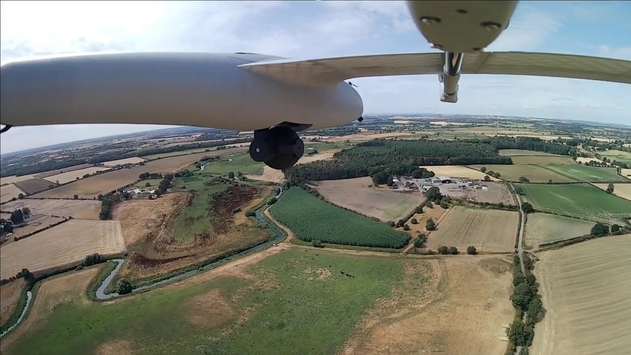

I’m integrating the ZR10 into a retractable payload bay on a fixed-wing/VTOL platform (currently flying on a Kite3). I’ve already built and flight-tested the mechanical side — a 3D-printed, weighted dummy ZR10 stowing and extending in flight — and it works well mechanically.

The problem: The ZR10 is mounted in a bay, retracted 90° from its normal reference orientation. On power-up it needs to complete its self-check/centering sweep before it’s usable, which assumes a roughly normal mounting orientation. Once active, it holds its commanded attitude with continuous motor torque, so it can’t simply be mechanically forced into the stowed position without fighting itself.
