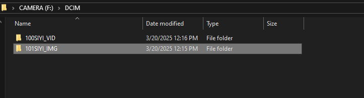

I was trying to download files via this script on GitHub by utilizing the ethernet connection to the camera: ardupilot/Tools/cameras_gimbals/siyi-download/siyi-download.py at master · ArduPilot/ardupilot · GitHub
When I do this, the directory is properly captured (e.g., 101SIYI_IMG) as it matches what I see on my SD Card when I utilize file explorer.
The script eventually runs into a failure “failed to get list of files” (Line 96) indicating the request failed. I assume the URL is not getting constructed properly?
File Explorer:
Here is the URL that gets denied:
http://192.168.144.25:82/cgi-bin/media.cgi/api/v1/getmedialist?media_type=0&path=101SIYI_IMG&start=0&count=999
It is important to note that a previous request to the camera worked fine to capture available directories so the obvious (IP Address miss-match I dont believe is in play here)
A bit more information to add here. I have tried specifying the full path in the URL as well to no success /DCIM/101SIYI_IMG
@rmackay9 any ideas here? I see you contributed to that script at one point.
