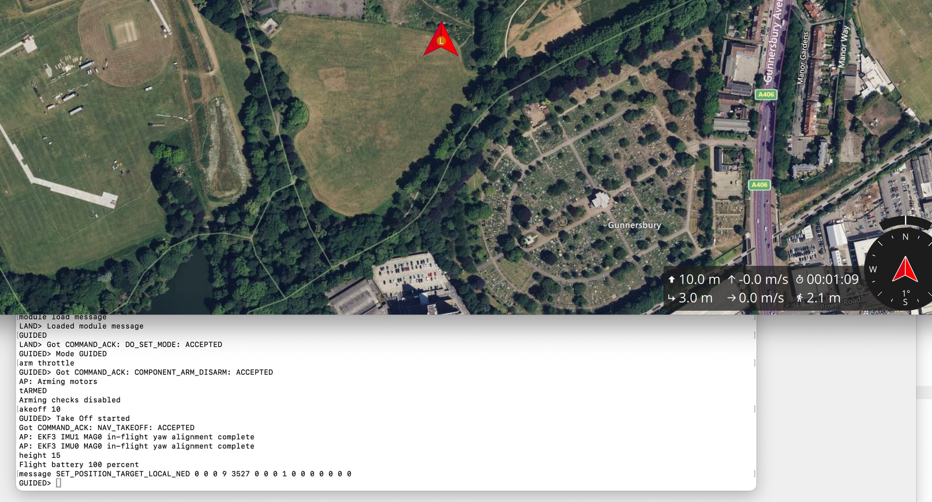

When using SET_POSITION_TARGET_LOCAL_NED with MAV_FRAME_BODY_OFFSET_NED the copter always tracks North irrespective of the vehicle heading.
Directly using the MAVProxy command to fly forward at 1m/s listed here: Copter Commands in Guided Mode — Dev documentation has the same effect. By also ignoring yaw I can maintain the heading but despite a BODY frame an x velocity never tracks the vehicles’ current heading and always tracks North.
Is the body frame reference supported in Ardupilot or am I missing something here?

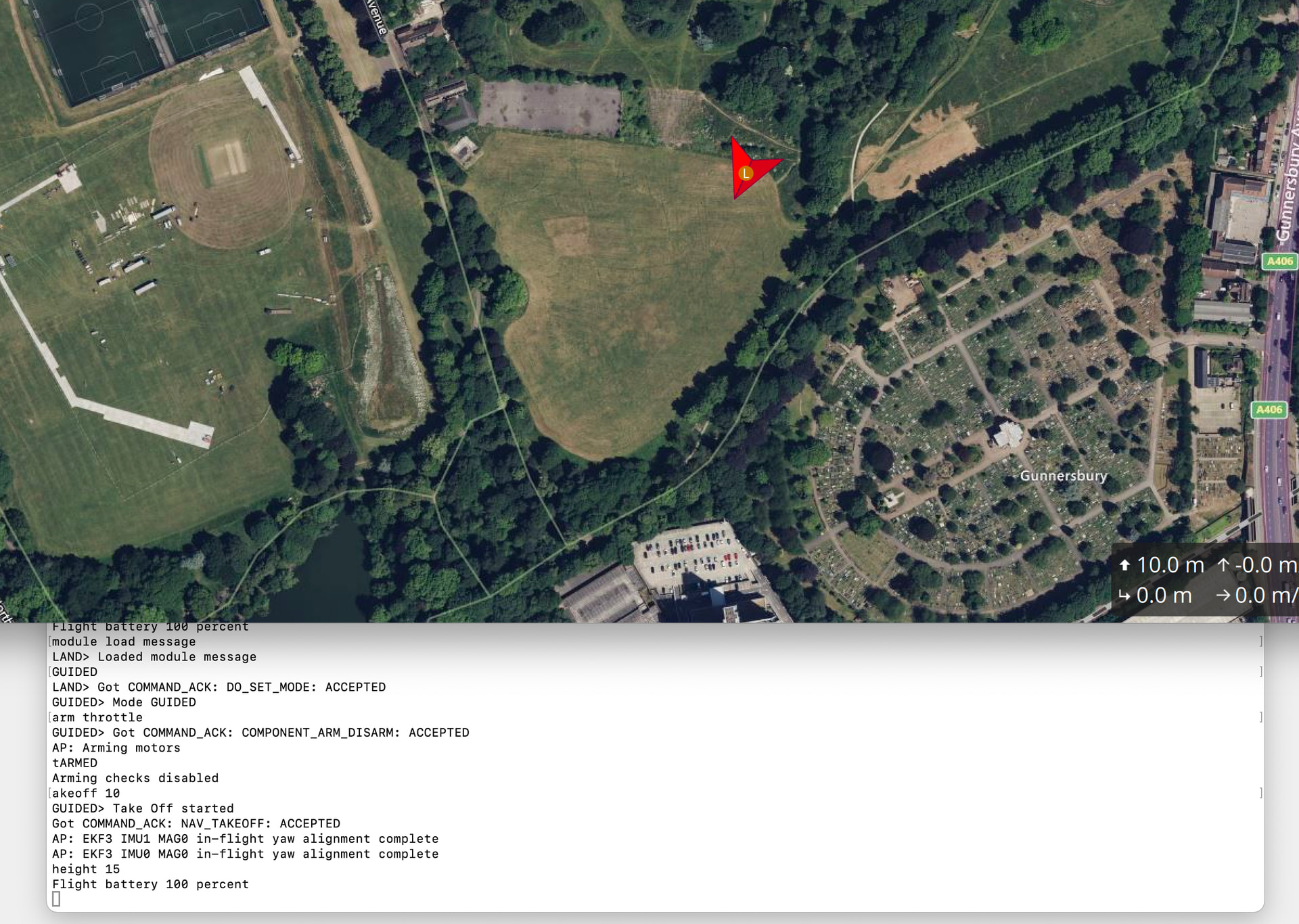

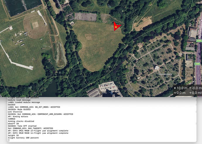

I couble checked this again, same commands as you, Starting at a heading of 205, I definitely change my heading to North and track North.
I’ve reached the maximum image size limits of this thread so can’t post more images, but I definitely see the same behaviour as I posted above.
Is there param that I could have set that could cause this behaviour? I did wonder if this was a bug in QGC, but the sim clearly shows me yawing nearly 180.
