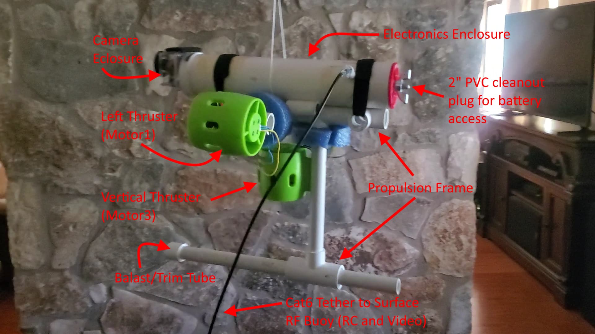

The structure has two sections: a propulsion frame for the thrusters and an electronics section for the battery,autopilot, ESCs, and FPV camera. The intent is to allow future variations on the electronics section. Material is common PVC piping with 1/2inch pipe used for the propulsion frame, and a 2-inch PVC pipe for the electronics section.
The simplest configuration for bi-directional thrusters is used: Simple3ROV, with two horizontal thrusters for forward/back-right/left yaw, and one for the vertical axis (depth control). Roll and Pitch stability is obtained by having the keel-like ballast to put CG below the center of buoyancy, and making its fore/aft placement adjustable.

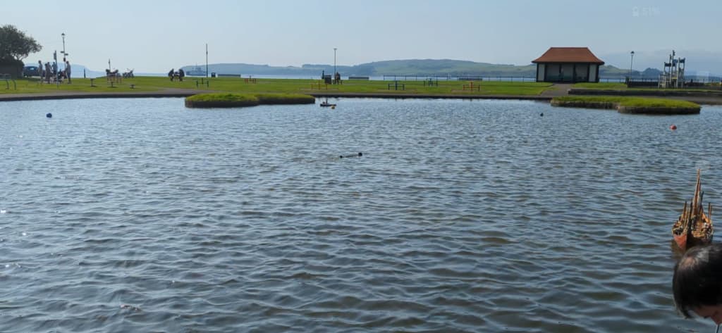

Since un-tethered control and video were desired, a tethered RF buoy is used for the radio control link and 5.8GHz video link back to the pilot.

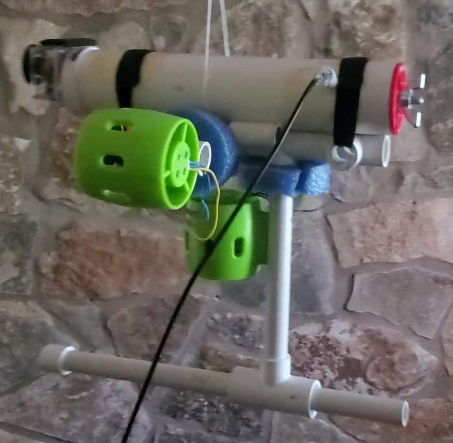

Nothing is very critical. However, making sure that the horizontal thrusters are equidistant from the frame center is necessary to avoid yaw with forward/back thrust and the vertical thruster should be just that, vertical. Adequate sealing of the wiring exits in the Electronics tube to prevent leaks is obviously important (ie dont spare the RTV!)
Propulsion Frame
  • Mount horizontal thrusters on 3 way tee by drilling mounting holes through both sides and enlarging one side to let the tightening tool pass. Add a bolt (self-threaded in PVC) to allow the tee to rotate to adjust trim but be secure with light tightening.
  • Similarly, with the vertical thruster mounted directly on the vertical PVC riser
  • I used bullet connectors on the thruster leads to allow easy change of the Electronics Tube in the future, but this is problematic for saltwater use. Better to solder and insulate the connections for that use.
  • I used lead shot in a forward compartment of the ballast tube (3d printed a little plug that I slid in), but anything like fishing or tire weights could be used. The ballast can be attached in any manner; water dynamic shape is not a consideration since this moves slowly in the water. Since the Electronics Tube is air-filled, the structure is normally buoyant and needs ballast. You want it to be neutral to just a little bit buoyant.
  • I used small sections of 10mm PVC to exit the motor wires and the tether; these were waterproofed with generous amounts of RTV silicone glue.

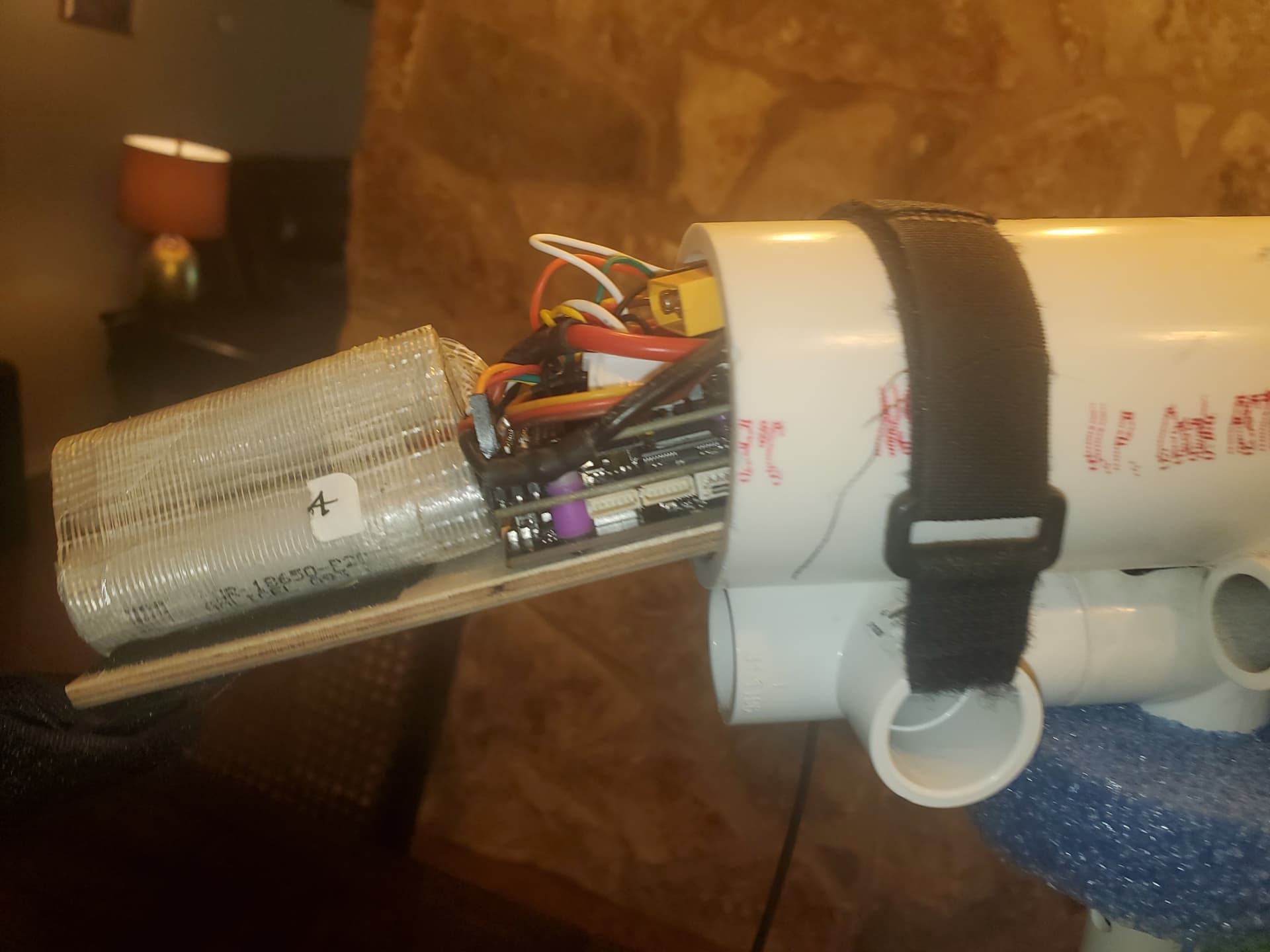

Electronics Tube
I used a 3S1P Li-ion battery. I mounted it on the end of a piece of wood,
followed by the autopilot, which slides into the tube, allowing access to the battery connector to power up and down the system, and to the autopilot USB for GCS connection to make setup changes.
2" tubing makes for a fairly tight fit for the ESCs, autopilot, and battery, but it worked. Next, I am going to make a 3" tube since I will be adding peripheral sensors next, and it will allow more room. 3" removable compression end plugs are also available.
I initially just used the removable plug and glued just a PVC end test cap without the FPV case for initial experiments.
Wiring exits were via 30mm long 10mm PVC tubes to allow the generous application of RTV for waterproofing.
I then added an unused action cam underwater case i had ( available on Amazon for ~$13 if you don’t have one already)for the analog FPV camera by sanding the PVC and the case lightly and using a copious amount of E6000 to glue it to the tube. Then I drilled a hole for the camera wire and hot-glued in the camera.
I glued some short 1/2" PVC segments to it to prevent rotation on the propulsion frame since the velcro straps alone still allow rotation. Rotation is not an issue in the water, but when carrying it to the water.

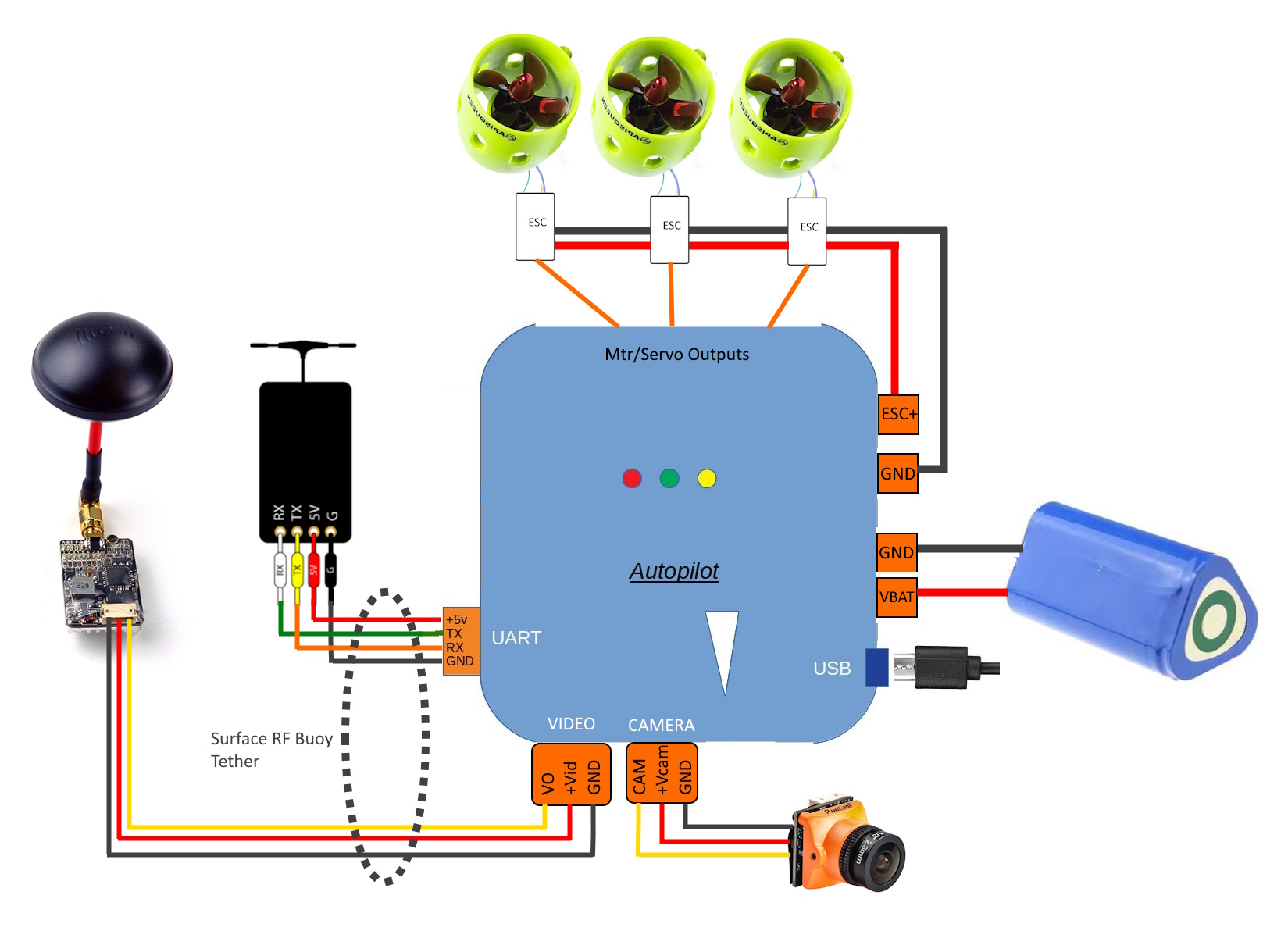

The thin CAT-6 cable has 4 twisted pairs. I used one for ELRS RC TX and RX, one for RC power (4.5V pad/gnd), one pair shorted for video, and one pair for 9V/Gnd VTX power.

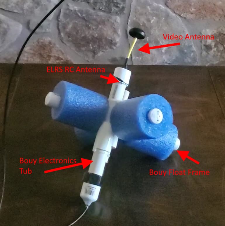

Buoy
The surface buoy design is not critical, and many variations are possible. All that is required is to terminate the tether and attach the RC receiver and Video transmitter to the tether in a waterproof fashion. I did not glue the top cap or waterproof it, since the design is “un-tippable” and it will allow easy future access. I tie-wrapped the 3/4" buoy tube to the flotation cross frame. The cap with the tether exit was loaded with RTV before gluing as well as externally.
Wiring diagram
