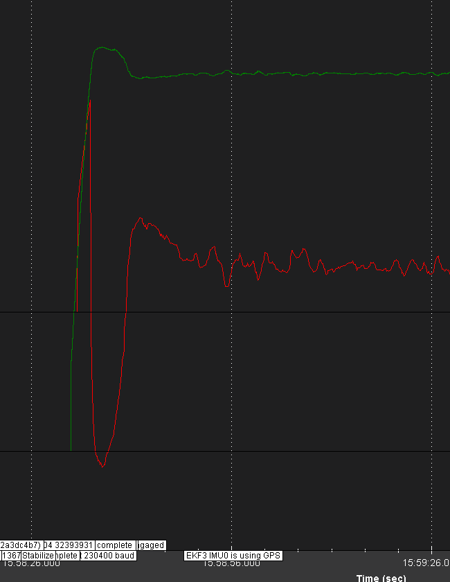

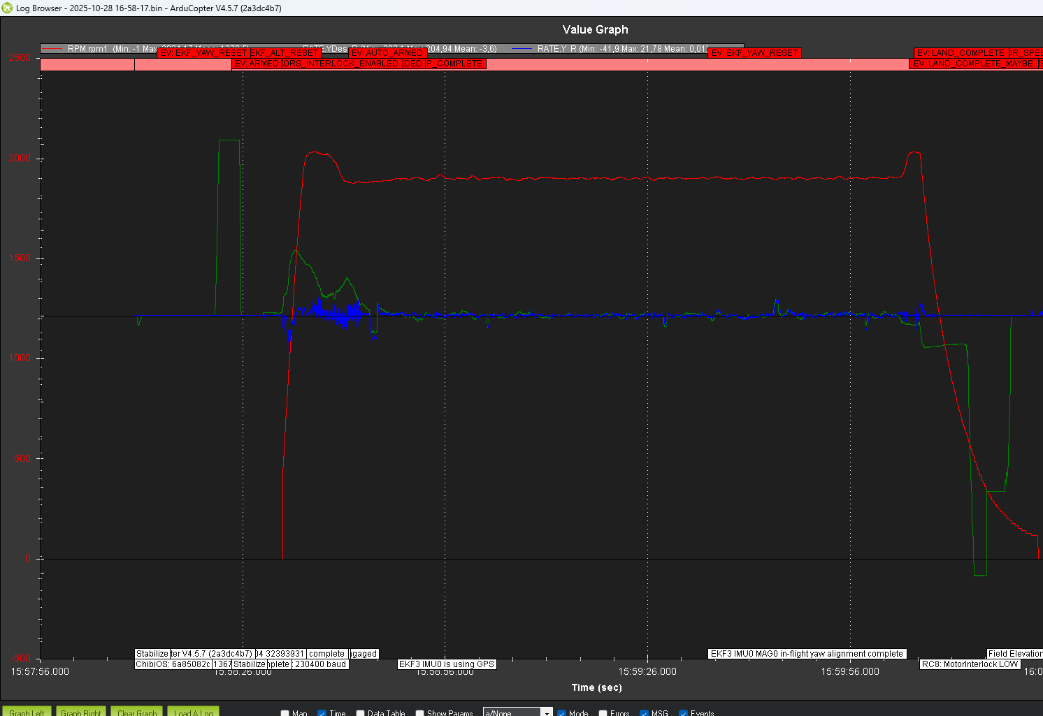

tail response look much better once in the air. I believe the initial shaking is due to a large over rpm while on the ground with the collective bottomed:
Remember each tune is valid only for the specific rpm setpoint you tuned at.
The governor is trying to compensate for this over-rpm, but it would help lowering H_RSC_THRCRV_0 , here you can see the governor output in relation to rpm:

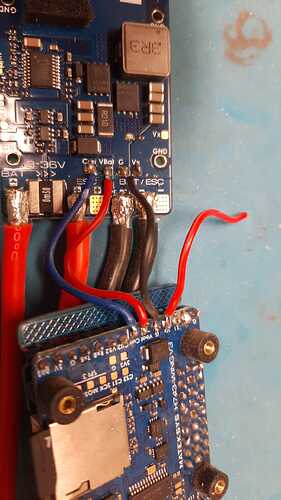

Thanks to another symptom, fortunately during startup: the servos not working, @Ferrosan has presumably identified the problem. A false contact that resulted in a power failure to the servos.
We’re now restoring the connection and checking all the soldering, and then we’ll perform another flight test. Thank you.
