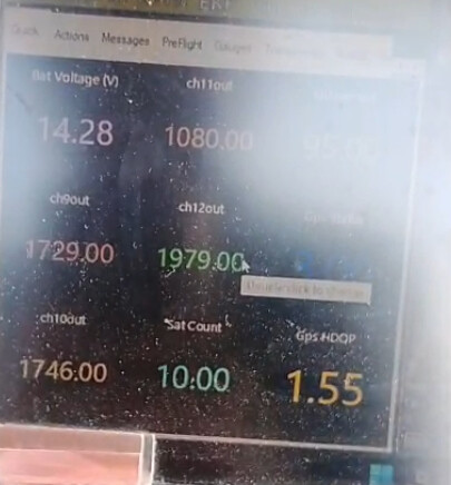

The issue im facing is incorrect logging during arming.

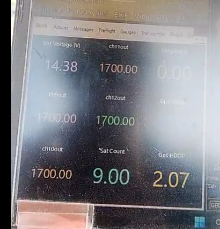

When I was using motor test and have given 70% throttle, at that time RCou is logging properly as u can see in the video below and at that time drone has also took take off.
All motors RCOU is same here.

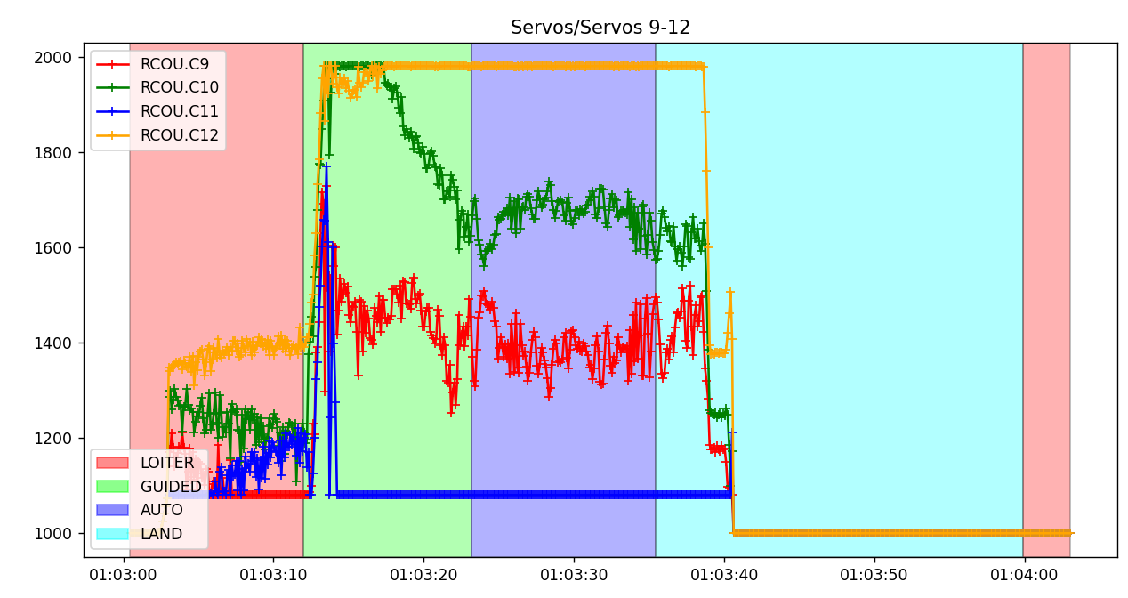

but While arming im seeing that ch11 is not logging correct RCOU even if drone has taken Takeoff.
in the picture below.
what is actually happening is while im giving take off, all channels are increasing there RCOU values accordingly but after 5-8 secs ch11 is setting to 1080, all the time.
Please help me to resolve this issue.

If you are using the motor test function in MP the outputs will be the same. The motor test function does not involve the PID loop at all.
Am I correct to assume this was done with the props removed? (Flat line I-term values suggest so) If so, it’s an invalid test of anything. The PID loop is trying to make corrections (even subtle ones) and because nothing is happening it just winds up and takes values to extreme. Might be fun to do, but it doesn’t tell anything useful.

If the test is done with the drone secured it’s just as useless as doing it without the propellers. The PID loop will try to make corrections but the drone does not move or does not move as expected, so the controller will make unusual outputs.
So if this log is also done with the drone secured there’s no reason for me to look at it.

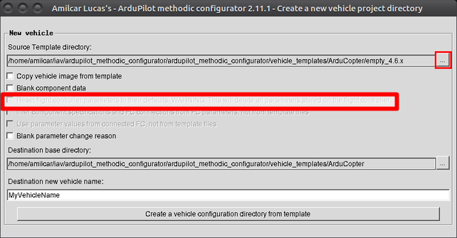

You can start here: Correctly configure ArduPilot for your vehicles on your first attempt | MethodicConfigurator
And this is how you reset the parameters:
