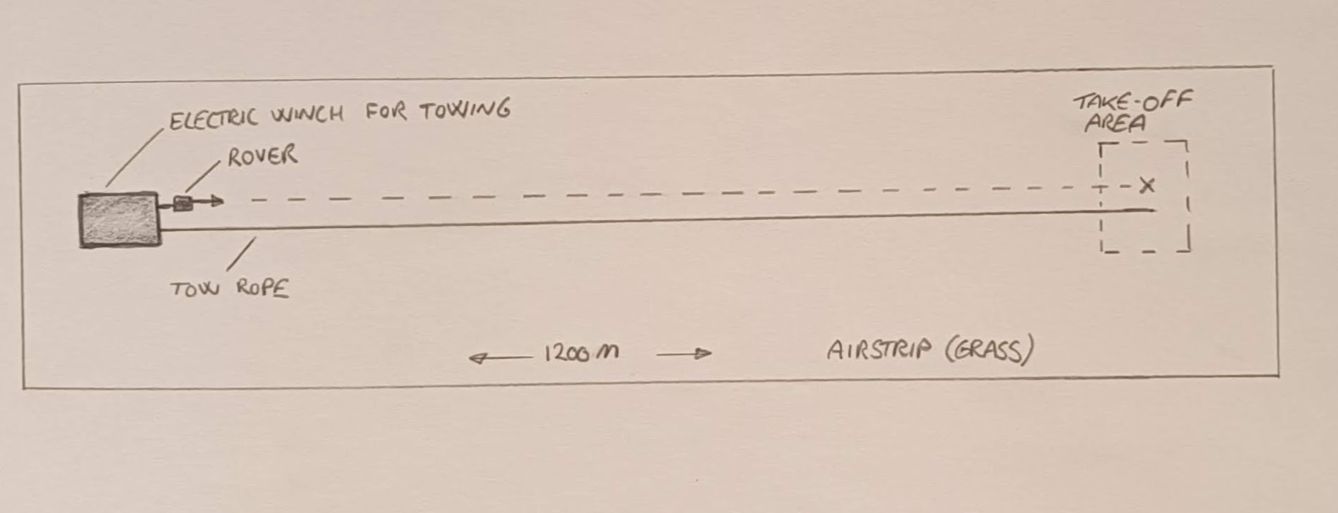

We’re a hang gliding + paragliding club and we operate an electric towing winch on a 1200 m grass airstrip. The winch has two drums and is remote-controlled, so no one is standing at the winch during operation.
After two tows, we need to retrieve the tow ropes using a car. To reduce downtime between tows, we’d like to build an autonomous rover that can:
  1. Drive from the winch/start area to the far end of the strip (take-off area)
  2. Pick up the tow ropes there (mechanical gripping solution will be developed later)
  3. Return and drop off the ropes at the winch/start area again
I’ve attached a simple sketch of the layout (winch at one end, rover route along the strip).

  1. Not too complex. Getting that vehicle up and running with ArduRover is straight forward.
  2. See Dock Mode which answers the 2nd point.
  3. The kit components sound good. Others may comment on the choices for RTK.
If you’re intending to use optical markers for final guidance, and the area is otherwise an open airfield, RTK GPS may not be necessary at all.
Yea, I suppose that with a big enough April tag it will be well within standard GPS precision.
Here’s another cheap way to set up an RTK base:
It integrates directly into mission planner for the NTRIP data. This might not give you exactly the same precision as the ardusimple gear, but we’re still talking about cm.
You’d still need an RTK receiver on the car. A here4 (or 3) will do that.
Thanks for the feedback. Regarding DOCK mode:
Can DOCK mode be entered automatically as part of a mission in Mission Planner, or does the mode change need to be triggered by e.i. the companion computer / OpenMV device? This could complicate things for us.
Someone else asked that on the forum and didn’t get an answer. There is a DO_AUX_FUNCTION mission command which includes many functions and most Modes but not Dock. Which was the question asked. So within a Mission I think not.
I bet you could use a Lua script to monitor for Mission Complete and then switch to Dock Mode.
