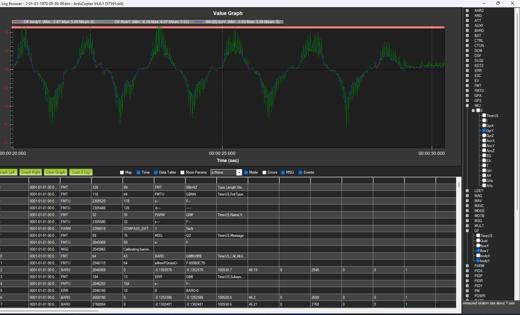

I have connected OF to UART 3 and set up the parameters as per the wiki and could see non zero values in opt_m_x, opt_m_y and opt_qua . since it was raining heavily outside i decided to use logs for calibrating the OF. i am attaching screen shots of the log as well as my .bin file .
2 01-01-1970 05-30-00.bin (1006.8 KB)

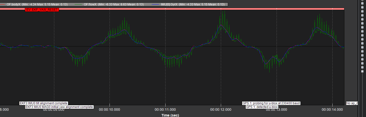

I can see that OF.flowx, OF.bodyx and IMU.gyrX are alligned with each other but there are a lot of small spikes on the OF.flowX graph. same is the case with Y axis graph.
it looks different from the graphs shown in the calibration wiki page where there are no sharp spikes like mine. has anyone experienced this ? my MTF01 is installed in correct orientation and is stuck to the bottom CF frame of my quad with a double sided tape. Range finder seems to be working correctly.
