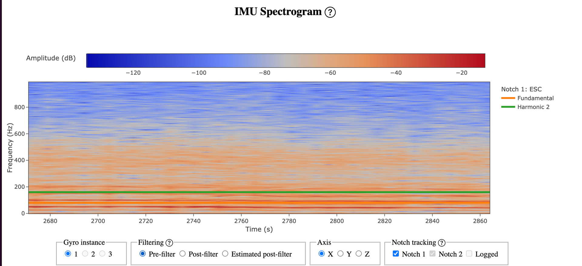

This is what I see when I set both of those and press the recalculate button.
I thought the notches are supposed to track the RPM and change throughout the flight.

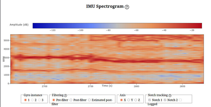

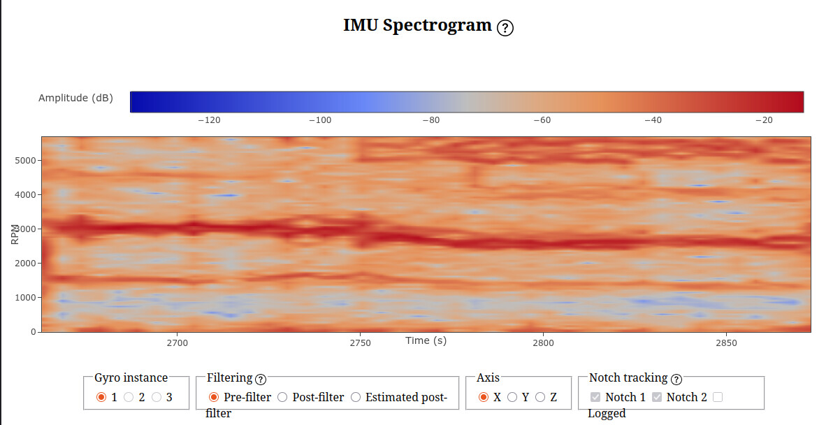

The RPM on this quad is sitting around 1500 based on ESC data, and the initial peak vibration.
If set to RPM the spectrogram will show the RPM track (the faint red line around 1500) the ESC data I posted above. However I would say that the real noise you need to track is at 3000 RPM/51 Hz. By using the ESC telem the filter will automatically track that.
I guess what I was confused about is I have seen screenshots of people using ESC telem for HNTCH and the notch tracker in the IMU spectrogram seems to actually follow the ESC telem vs in my example it stays at a constant 80Hz or whatever I set the frequency to. Do I actually need to do a test flight with the notch setup correctly to enable this feature?

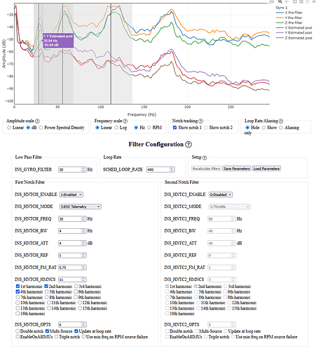

Try to configure notch like this

@mike_tk I would increase the BW to 6 Hz and disable “Update at loop rate” .
My issue was that I has INS_HNTCH_REF set to 0 and it’s supposed to be 1.
@mike_tk I’d also be tempted to turn off the extra harmonics. Those peaks are still below -50 when I tried it so it’s probably not worth the potential CPU load and lag.
