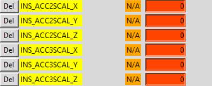

Hello everyone I am using the ardupilot methodic configurator for a smooth process but i encounter this problem .The values which are list above is still zero and its copying its respective value from the mission planner app.

Your flight controller does not have a ACC2 nor a ACC3.
You must manually delete those parameters using the “Del” button on the left of each parameter.
All parameters have been correctly imported from Mission Planner.
