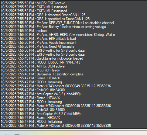

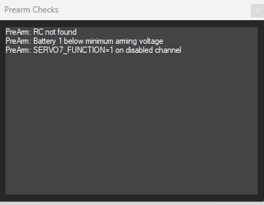

I am trying to enable servo 7 on my matek v3 board and I keep getting this message.
SERVO7_FUNCTION=1 on disabled channel
My rc 7 is set to 0, Servo 7 is set to 1.
I want it to passthru.
What am I doing wrong?

RC not found says it all.
I was just showing the error, even with my rc connected i get the same error.

So show that. Messages Screen in Mission Planner after connecting. Before all those error messages.
Or post the parameter file to show your misconfiguration.
I put a low voltage battery on so I could calibrate the RC in case that was the issue, thats why it has the battery below min arming

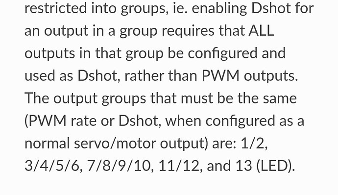

Nope. You are only using timer groups 1 and 2 for DSHOT. But you still haven’t answered the questions asked of you above.

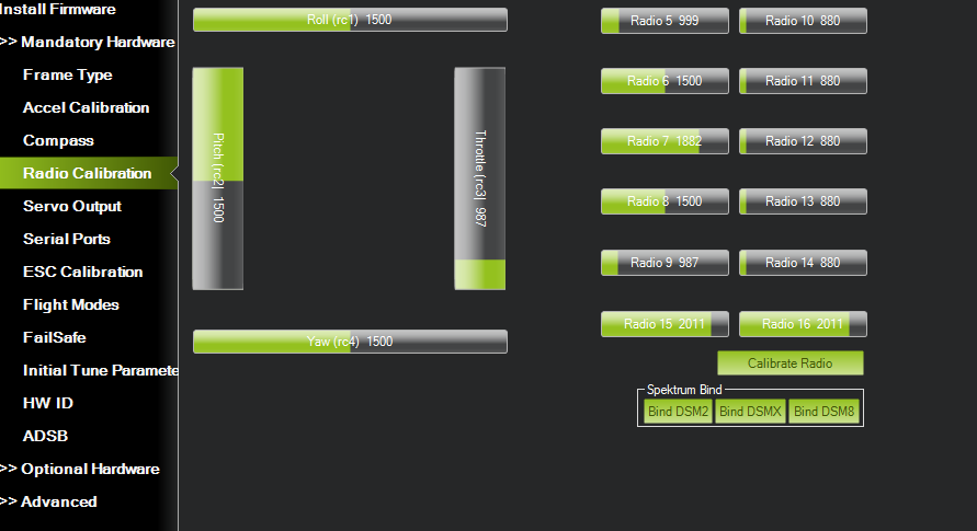

Yes I am using an 8+ channel RC system.
Show a screenshot of the RC calibration screen while you have the RC transmitter bound.
And again, answer @Juergen-Fahlbusch 's question about which specific system it is.
I think I see the issue - you are using SERVO9 for NeoPixel, which is on the same timer group. So you were on the right track regarding timer groups, just not quite a complete picture.
Put the LEDs on SERVO13, and you’ll be able to use the rest of the pins as desired.
Awesome thanks @Yuri_Rage, I appreciate your time.
You nailed it!! Thanks again!!
