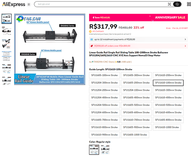

I’ve had good luck with these:
https://www.aliexpress.us/item/3256802112874001.html
Does anyone have any examples of steering using these linear actuators?

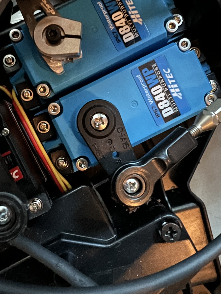

May I suggest the Hitec D845WP? I use two of them in my 1/5 scale rally car. The servos are attached to an AP_Periph hanging on the car’s DroneCAN bus.
These are the prior versions of the servo; the D840WP.
Is it possible to take more pictures and vĂ­deos of this system you are using?
I loved the possibility of making a servo motor based steering system?
If you can, I would be very grateful.
This should give you an idea.
