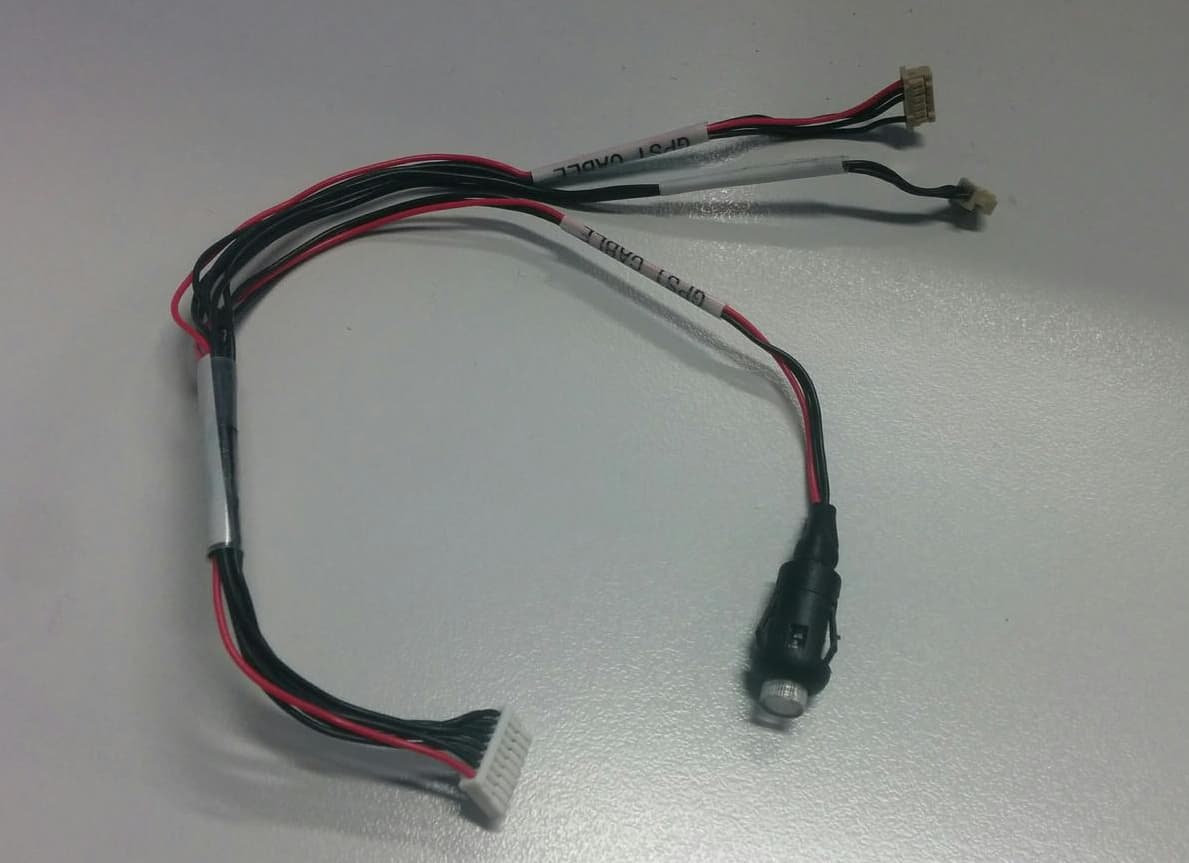

do you have the safety switch connected or enabled?
where is it. sorry but i am the new one in this cubepilot. i do not know what is the safety switch
PixHawk4
does not have it.
And there is a plane - and not copter
the cube does have it, its part of the GPS module normally
you should have got a standalone switch with it also i think
on the GPS it is connected HolyBro and no any safety switch connected

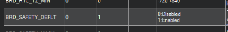

then check that its disabled in parameters.
Yes. You saved my life :slight_smile: Plus to your carma :slight_smile:
Now it is working
When you succeeded, was the SG90 in a state of being externally supplied with 5V voltage?
5V not enough, Used external battery with 7,4V
