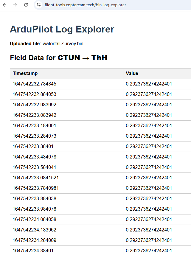

I’ve been doing a little python work and exploring .bin log files.
I’ve only written a few scripts so far, and most of the reports are available through other apps.
I put one up on-line today that is a little different. This script allows you to pick a message type that exists in a log file, and then pick a field from that type - and get a table back of all the values for that record-type/field pair. Of course Mission Planner will plot this information, but my script give the actual values.
Here’s an example:
Online access to this script is at: https://flight-tools.coptercam.tech/bin-log-explorer

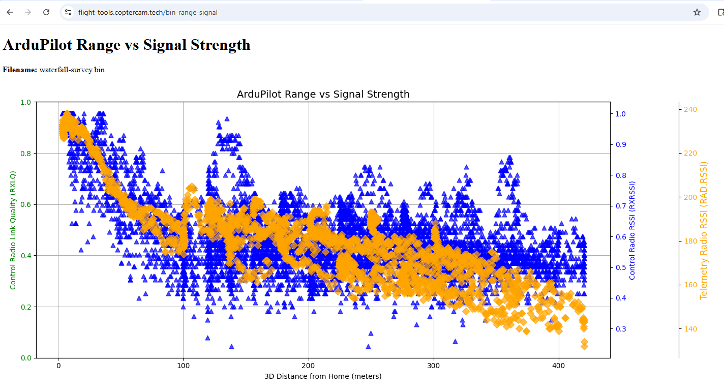

Some of the scripts generate charts - like this:
