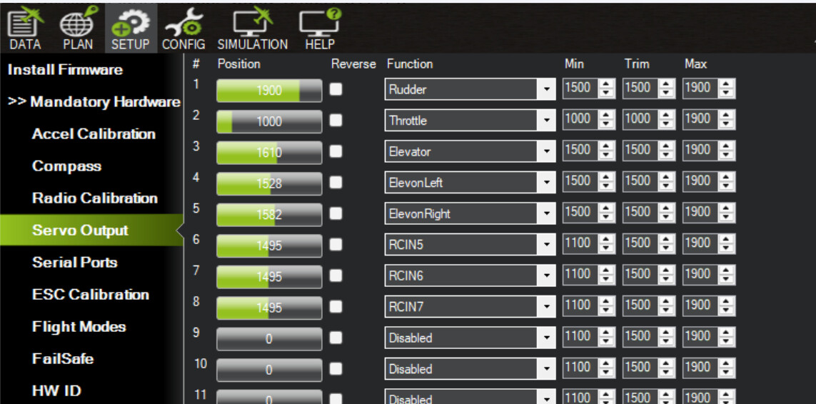

Rudder, Elevator and ElevonLeft and ElevonRight - not correct
In the manual mode, even after arming the Ruddler, Elevator , ElevonLeft and ElevonRight are getting just the values more then 1500 and when i push sticks in other directions they are not making any changes.
Help please fix it.
changed the in values to the 1100 and now it is working

Share a picture. What you’re describing so far is a conventional aileron, elevator, rudder configuration. Wingspan would not change that.
right now, i have the problem with turn to right and left, it should work like the turn left or right should activate the left, right elevons and the rudler, but the turn from the transmitter work just with elevons, maybe someone could help how to set configuration for the right way?
Share a picture. No one knows how to configure what you’ve described.
