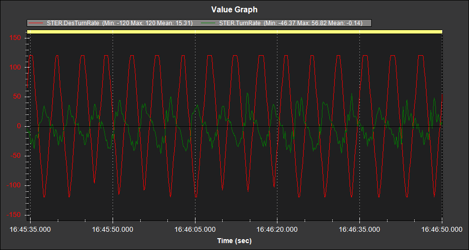

OK, I have made some progress and am now on tuning of steering in ACRO mode. The issue I am having is that the PID Desired and PID Achieved are going in opposite directions. The boat turns in the direction commanded by the stick movement and is drivable in ACRO. If I tweak ATT_STR_RAT_FF/p/I, I can get the curves to go in equal amounts simultaneously, but only in opposite directions. I’m not sure if this is fundamentally wrong (and I don’t know how to fix it) or if perhaps this just has something to do with the axis setup that I’m missing. Please advise.

Need a log to diagnose further. Sounds like things are still all reversed and crossed up. Manual mode (in terms of tuning) does nothing other than confirm that signals are sent - not that they are in proper direction/orientation.
Does this link work for you and is this the file you need (dataflash log)? 2025-09-15 14-27-30.bin
Looks like you have fixed any steering reversal issues that were present before.
ARMING_CHECK is disabled. Enable it and then work to correct whatever arming checks are failing. Do not leave it disabled, as that is a poor crutch to force a poor configuration to work.
Your vehicle simply isn’t physically capable of the steering rate/acceleration demanded by the current configuration.
Suggest the following:
ATC_STR_RAT_MAX,45 (via observed steering rate)
ATC_STR_ACC_MAX,45 (via observed Z gyro acceleration)
Speed tuning is poor. Suggest (based on graph below):
CRUISE_SPEED,0.92
CRUISE_THROTTLE,56
I did not dig much farther, as you have a long way to go, and it’s probably not worth much more analysis at this stage. Set the parameters I gave and then re-examine steering performance and continue to tune the ATC_SPEED and ATC_STR_RAT FF, P, I, and D terms according to already linked documentation.
