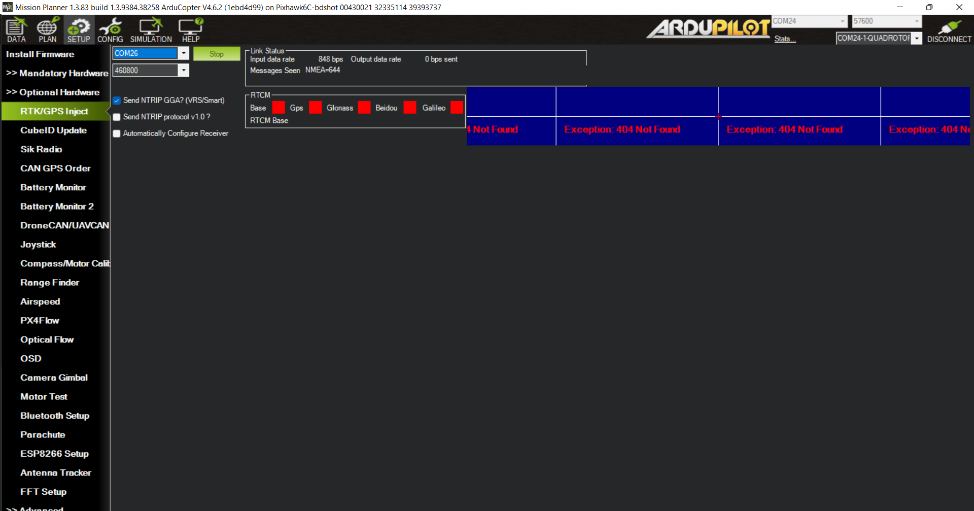

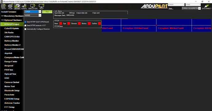

Hi, I have two LC29H-EA, one on the drone and one on the base. I set both with yuri .ini file. I set the base as a base. I can see 3d fix on ardupilot. I see “gps sps” on qgnss when I connect the base (I don’t know if it’s correct). When I try to do rtk inject on ardupilot connecting the base, I can see the nmea data flow but nothing else. All the constellations are red and rover remains in 3d fix. Anyone as an idea of what’s going wrong?
Thank for the help
It receives NMEA data but shows nothing else

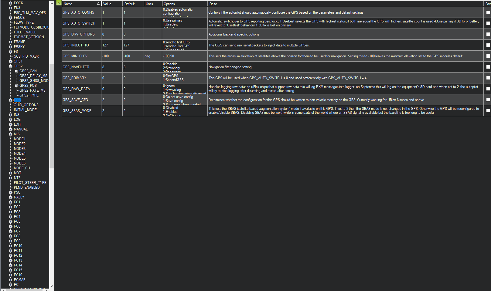

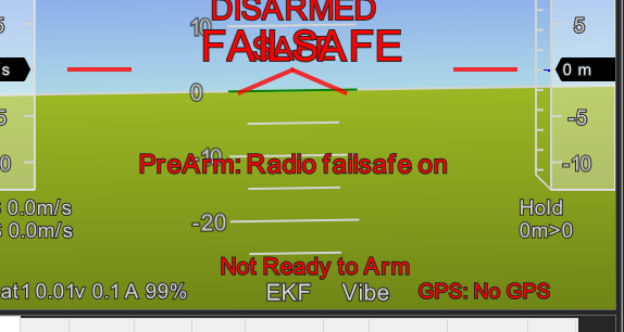

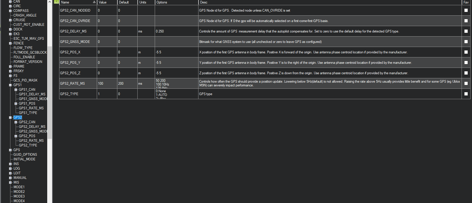

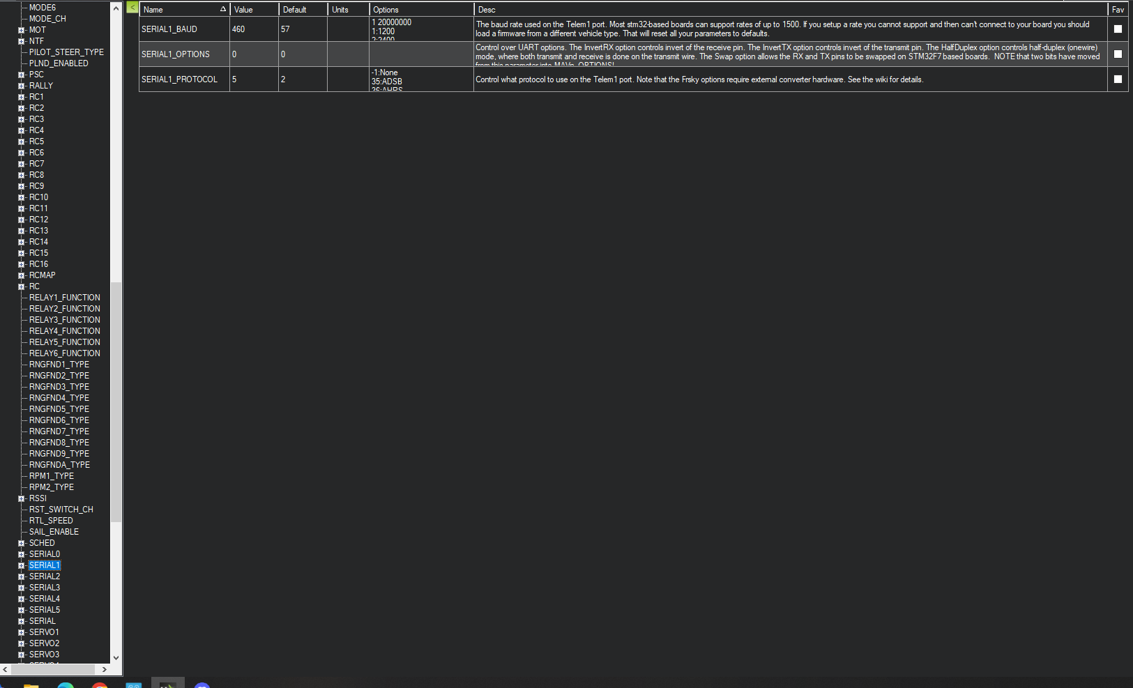

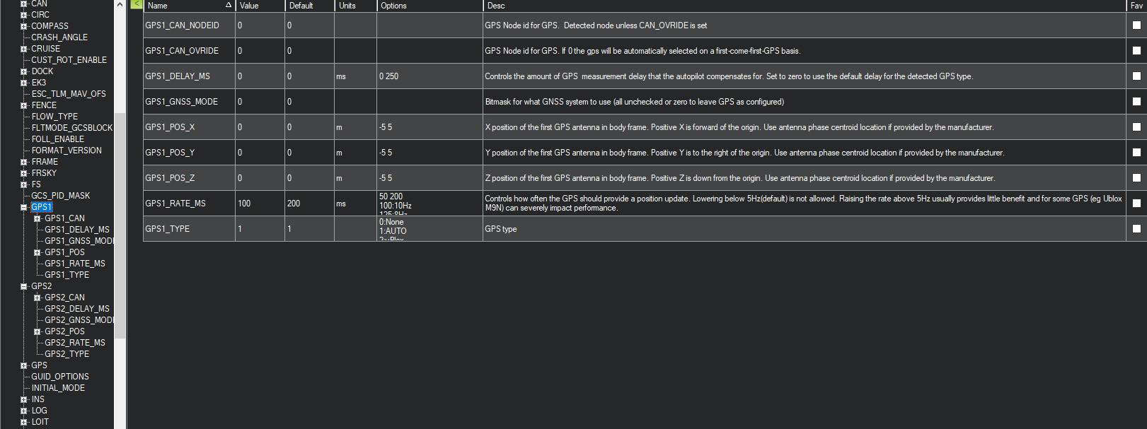

Hi Guys ,I feel I am late to the party but can someone please point out what I am doing wrong (GPS:No GPS)
All I want to see is some gps come in to mission planner at the point . what is the command on QGNSS to see my module is 1hz or 10Hz . Any help will be highly appreciate
