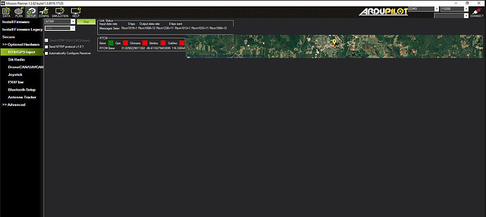

I am Just getting my ArduPilot Mower out for this season, and I am running into issues getting the corrections working from my NTRIP caster. I am using the Alabama CORS NTRIP connection which I used last year with no problems. The string I am using to connect is → HTTP://C*****M:S******2@205.172.52.26:10099/ALGR_RTCM3. The connection looks like it is made, and valid messages are seen but very intermittently. The graphics for the connected satellites never show up →

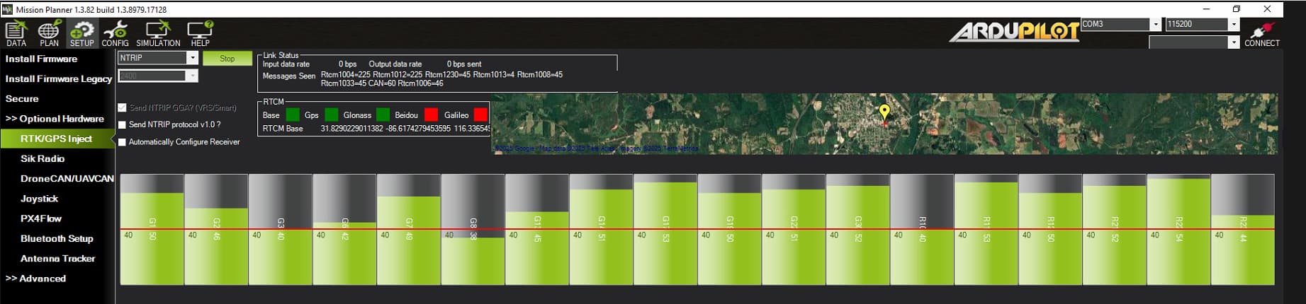

If I test with a RTK2go connection it looks like what was getting with the Alabama CORS connection before. Connection with RTK2go →

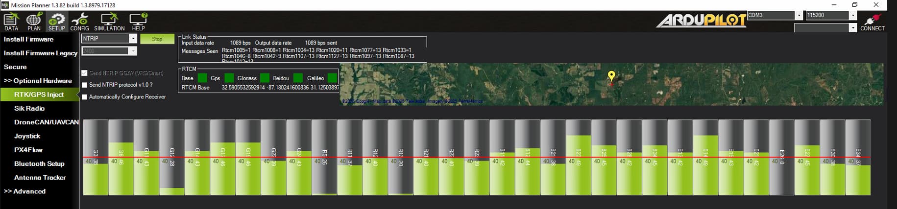

After I ordered a new simpleRTK2B Budget board (ZED-F9P) and u-blox GNSS Multiband antenna ANN-MB-00 to setup as my own RTK base today, I decided to test one more time with the Alabama CORS NTRIP connection. To my surprise it is back up and working.
