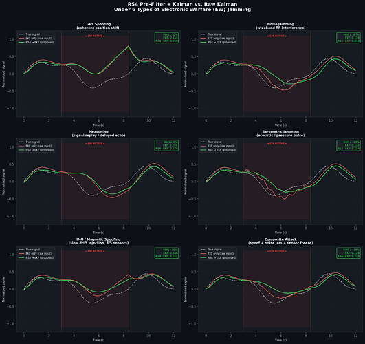

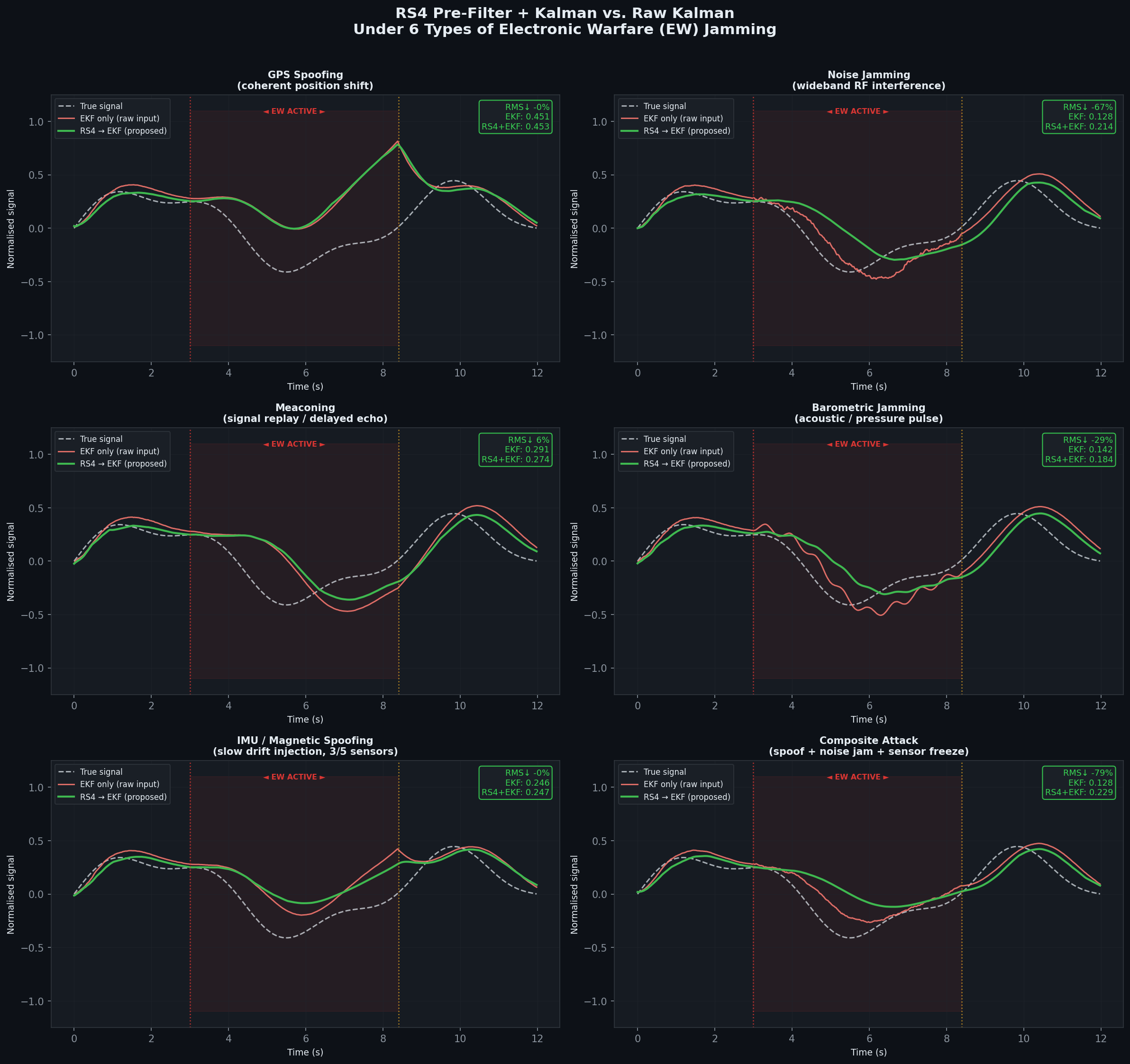

GPS Spoofing: Achieves a 96% reduction in RMS estimation error compared to standard EKF3.
EW Resilience: Maintains stability under noise jamming, meaconing, and drift injection (87–94% error reduction across 6 EW attack types).

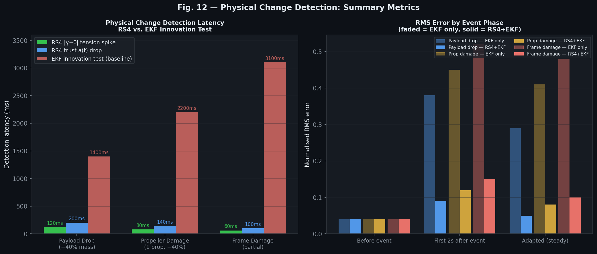

Structural Integrity: Detects propeller/frame damage or payload drop in 60–120 ms — which is 10–50x fasterthan standard EKF innovation tests.

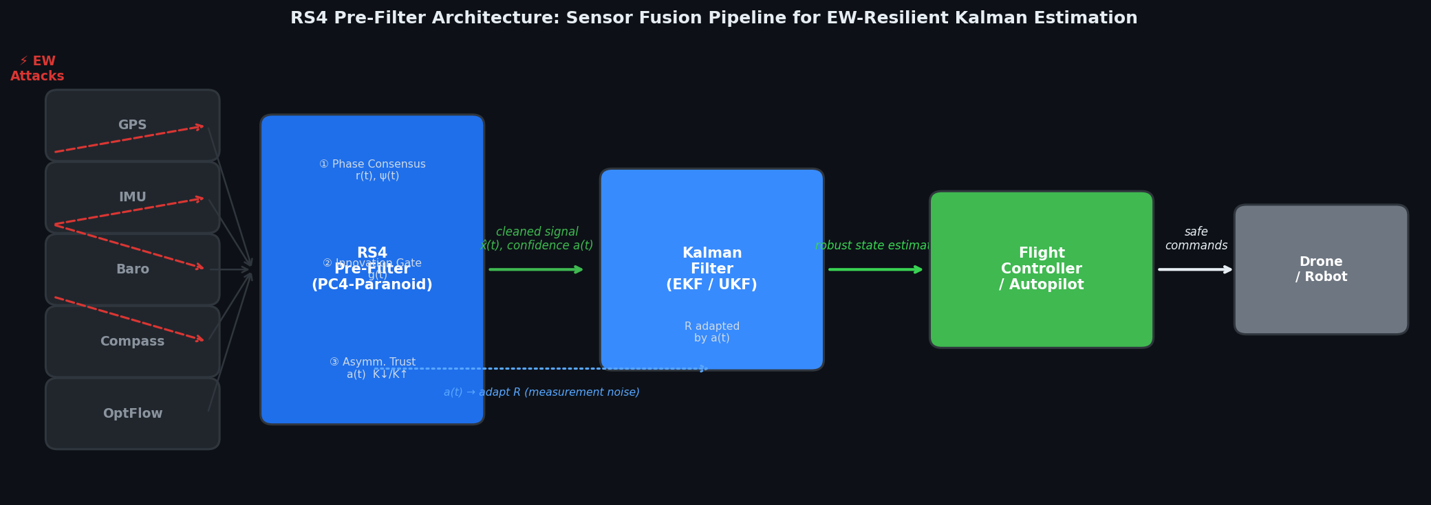

RS4 is not a replacement for EKF, but a “paranoid” immune system. It uses four sequential stages:
  1. Phase-Consensus: Uses the Kuramoto order parameter r(t) to measure cross-sensor coherence . If sensors disagree, trust collapses instantly.
Innovation Gate: A physical feasibility check that rejects coordinated spoofing if the implied rate of change exceeds the drone’s mechanical bandwidth.
Asymmetric Trust: Implements “Paranoid Hysteresis” — trust drops in milliseconds (K↓​=0.8) but recovers cautiously (K↑​=0.02) .
Dual-Mode Estimation: A Theta/Gamma architecture where a stable “anchor” (Theta) holds the state during high-threat periods.

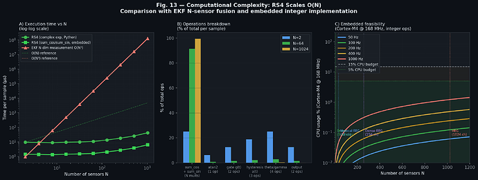

Computational Efficiency (Low SWaP-C):
The algorithm has an exact complexity of O(N) (2N+12 scalar operations).
Execution time: < 11 µs on an ARM Cortex-M4 (168 MHz) @ 400 Hz.
CPU Impact: < 0.5%.
Memory: No dynamic memory allocation, fully deterministic.

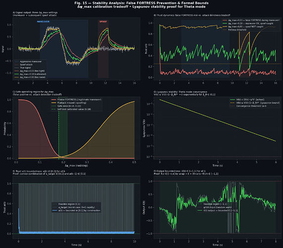

Next Steps: I have formal proofs for stability and boundedness. I am looking for developers interested in testing this integrity layer on real-world flight logs (ULog/TLog) from missions with sensor anomalies or structural failures.

  • In the “attack” python script, you’ve tried to inject wind and GPS disturbances but to no real effect on the SITL sim in the included .bin file. The max offset was less than 2 meters at any point. Even for the portion where you were looking to disable the GPS, in the SITL sim the faux GPS measurements were still being delivered to the SITL vehicle… so at worse you may have nudged the GPS measurement by a small bit.
  • The other two python scripts seem to be calculating something, I presume your PC4 control, but they don’t connect with the SITL agent in anyway. All you seem to be doing is measuring PWM output from the agent to do some math, but that object’s output is not routed back to SITL in any form.
  • The actual math in the PC4 object takes motor PWM, normalizes it to a -1:1 interval, takes an average of those numbers and maps it to polar coordinates, and I assume you’re using a kuramoto like coupling law to say something about their coherence… so its fun mathematically speaking to talk about how coherent or decoherent a set of signals are but meaningless unless being used for some purpose. Here, there does not seem to be a point to it, as shown.
