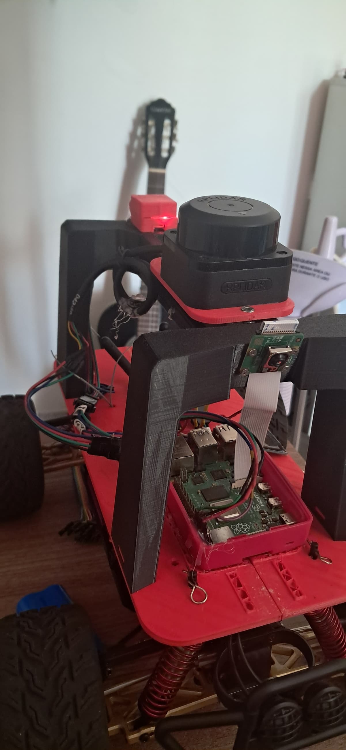

I’m currently experiencing issues integrating the RPLIDAR C1 from SLAMTEC with my ArduRover setup.
Hardware & Firmware:
  • Flight Controller: Matek H743 Slim V1.5
  • Firmware: ArduRover V4.6.0
  • LIDAR: RPLIDAR C1
Configuration Parameters:
  • SERIAL6_PROTOCOL = 11 (Lidar360)
  • SERIAL6_BAUD = 460800
  • PRX1_TYPE = 5 (RPLIDAR)
  • PRX1_ORIENT = 0
Issue Description:
When connected to the flight controller, the RPLIDAR C1 exhibits erratic behavior. In the Mission Planner’s proximity view, the data appears random and inconsistent. However, when I connect the same LIDAR unit to a PC via USB and use SLAMTEC’s RoboStudio, it functions perfectly, displaying accurate and stable scans.

  • Photo of the rover setup with the RPLIDAR C1 installed.

The reason is because the lidar puts out WAY more data than the flight controller can handle.
I messed with this for way too long and discovered that to be the cause. I went as far as building a custom firmware to debug it. The serial read buffers quickly overflow.
It might be possible with a separate coprocessor like ESP32 or something to handle the gobs of data from the lidar and send a simple obstacle signal to the flight controller.
Here a RP2040 communicates with the lidar and does the conversion to MAVLink towards the FC. I think data rates used were 1.5Mbps.
Note that the yellow radar reflects the surroundings of the rooms, but MP crashes easily with it.
