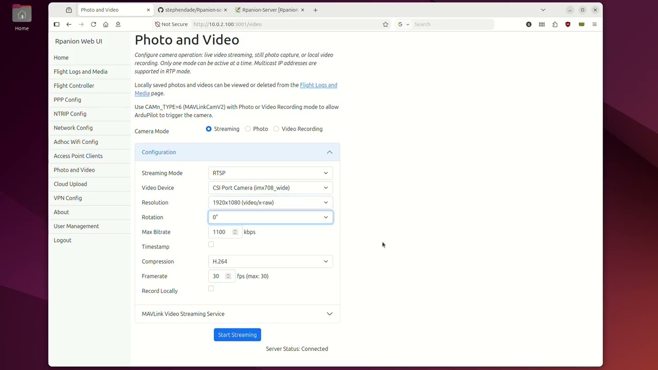

  • Add local video and stills recording
  • Support added for Jetson Orin (Jetpack 7.2)
  • Support ArduPilot MAVLinkCamera, to allow ArduPilot to trigger still or video capture

  • Updated detection of cameras
  • Cloud: Upload photos and video. Allow for upload-on-disarm

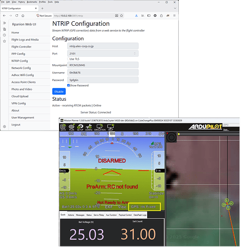

Really great to see this!
I’ve been using RPanion recently on my aerial photography copter because it has good support for camera gimbals connected directly to the RPI.
Today I tested out RPanion’s NTRIP service for the 1st time using Softbank’s Ichimili service (which litterally means “1mm service”) and it works a-ok. RTK Fixed and a very solid position on the map.
One thing I’ve struggled with when using NTRIP services is they often don’t tell you the “Mountpoint” for some reason. When used with the CubePilot Here4 GPS I found that “RTCM32M4S” was the best MountPoint to use with Softbank’s service.
