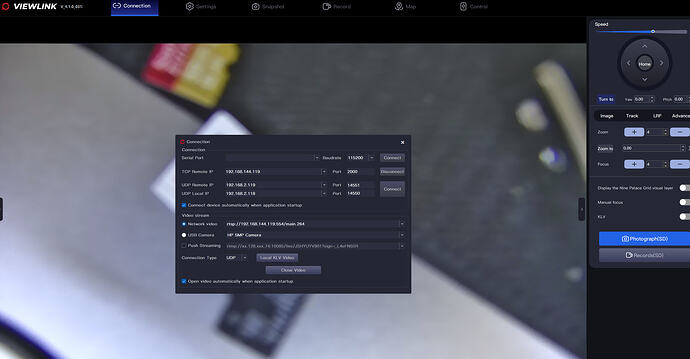

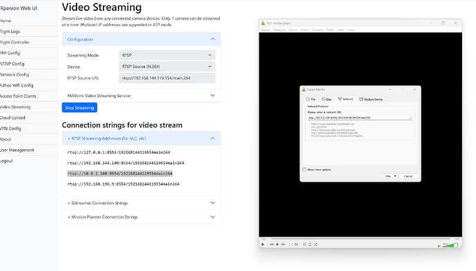

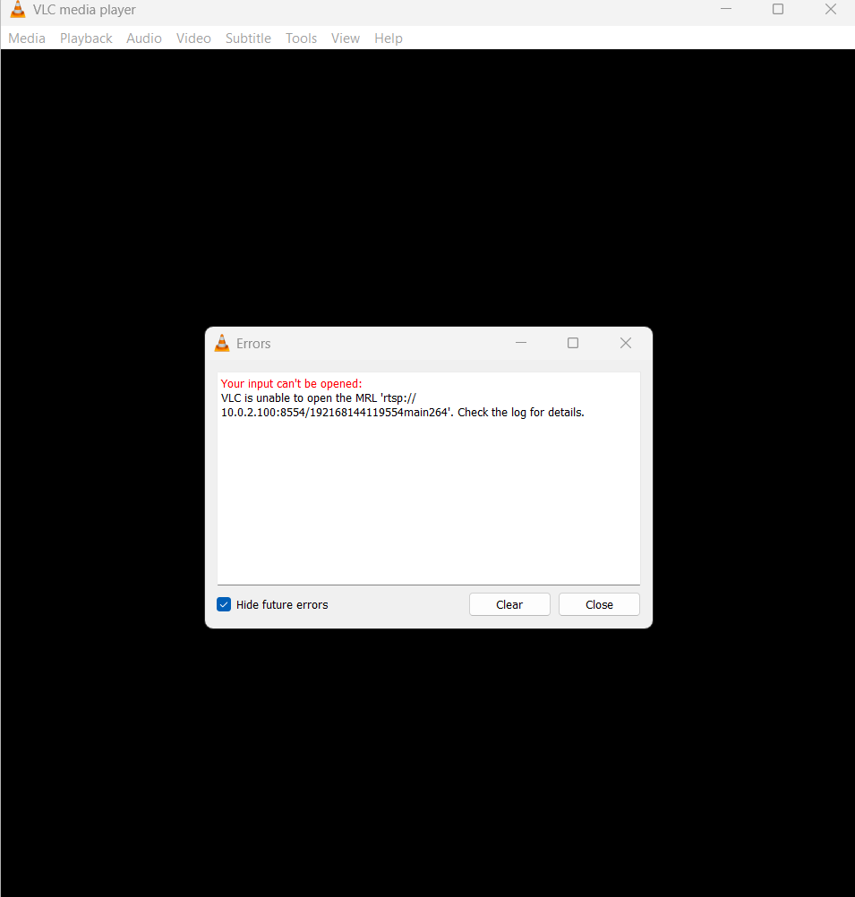

Currently, I have a Viewpro gimbal connected to a Raspberry Pi 5 via Ethernet.
 Viewpro gimbal IP: 192.168.144.119
 Raspberry Pi 5 Ethernet IP: 192.168.144.100
My laptop is connected to the Raspberry Pi 5 via Wi-Fi.
With Viewlink, video can be viewed normally (the GUI software provided by Viewpro for viewing video from the gimbal) at rtsp://192.168.144.119:554/main.264

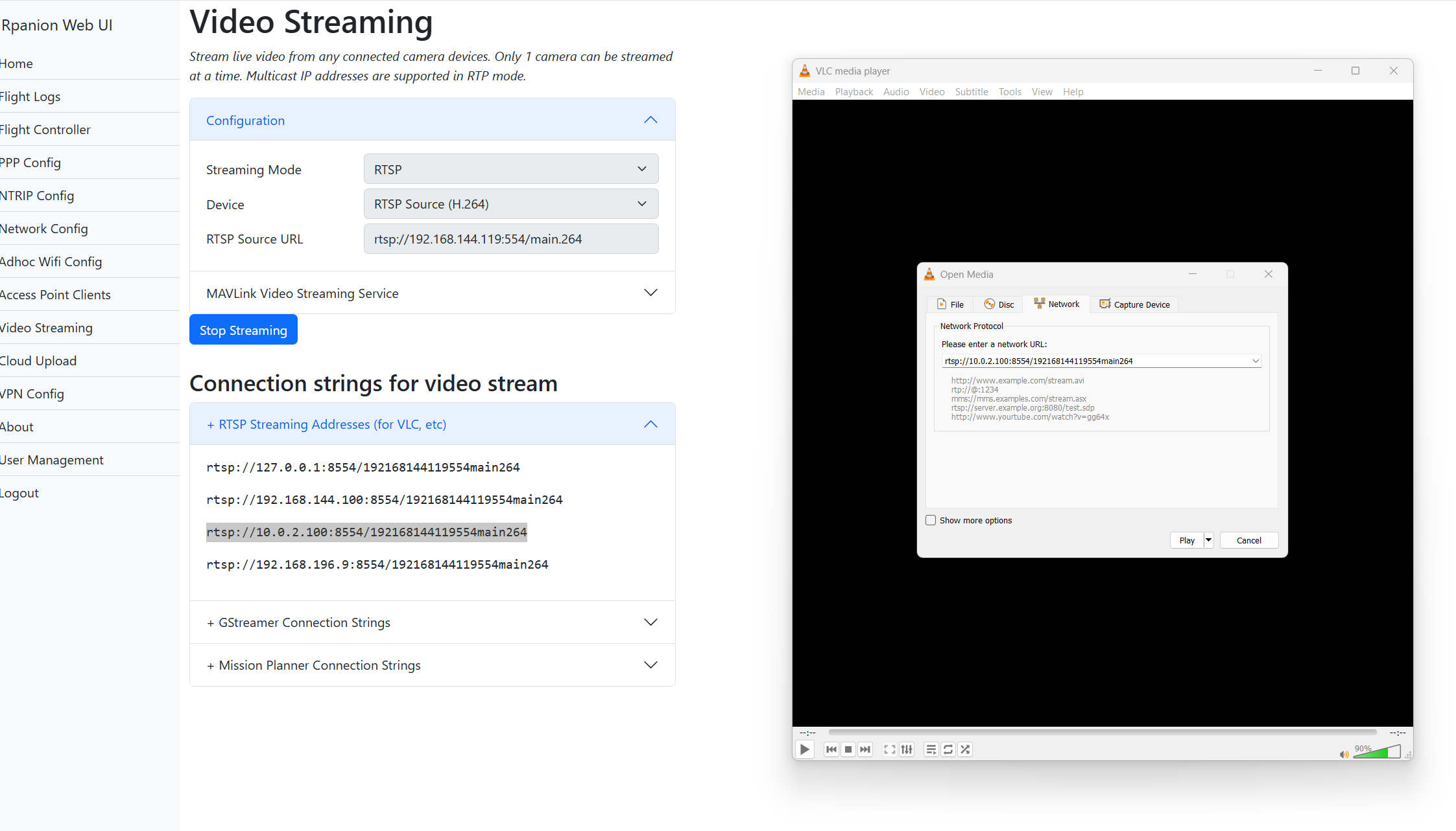

With Rpanion-server, I have also entered this RTSP URL into the Video Streaming tab (as shown in the images below), but the video does not open or display in VLC.
Could you please review the setup based on the screenshots and let me know if I am missing any steps or if there is something configured incorrectly?
Thank you in advance for your support.
That all looks about correct. Could you send me a logfile? It’s on the “about” page of Rpanion-server.

Thanks. Looking at the logfile, it appears to be a missing gstreamer package. I’ll investigate and fix in the next few days.
I’ve had a look through, and it looks like some sort of incompatibility between Gstreamer and Viewpro.

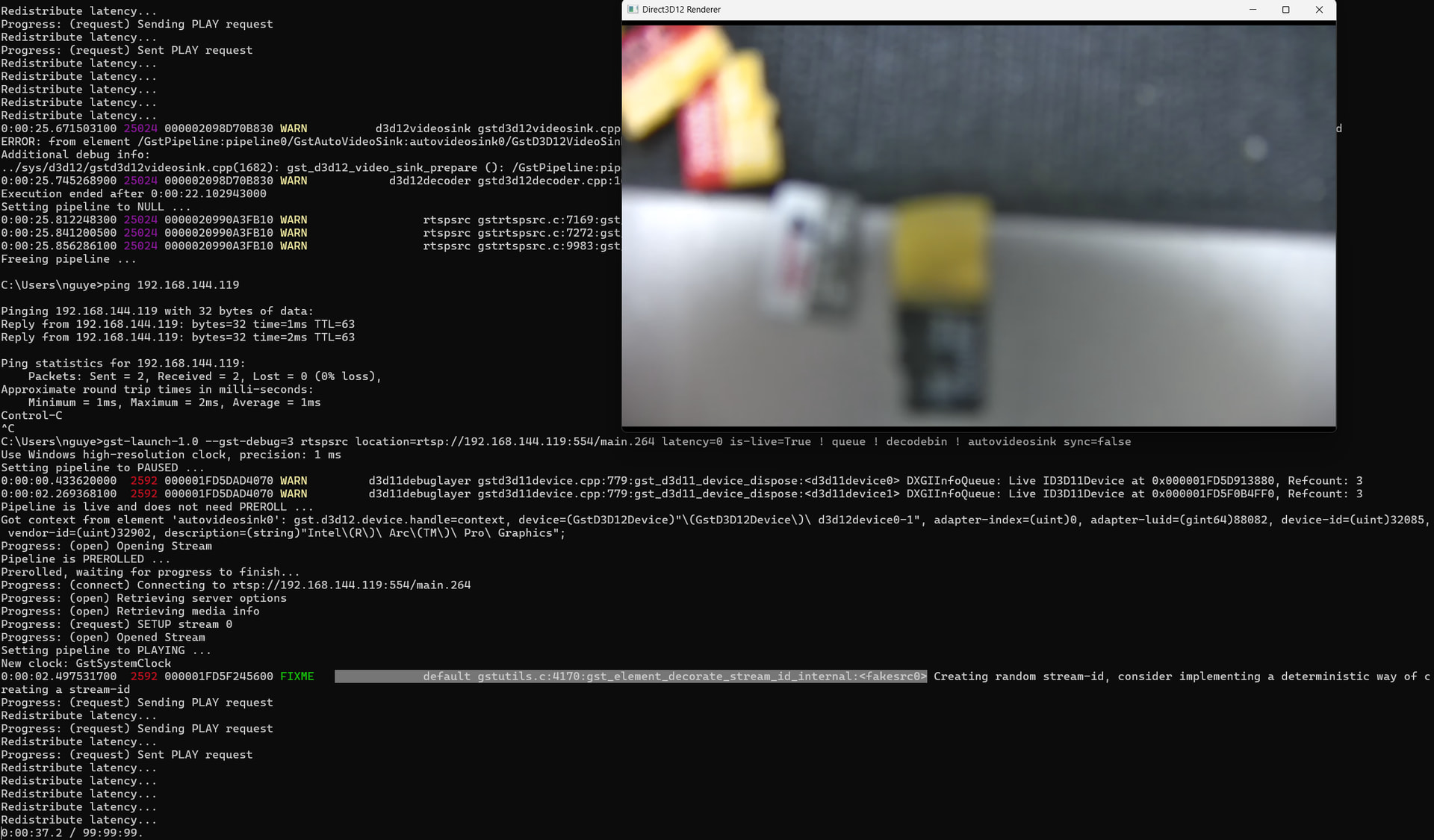

On your laptop, could you run the following to see if Gstreamer will open the Viewpro stream directly:
gst-launch-1.0 --gst-debug=3 rtspsrc location=rtsp://192.168.144.119:554/main.264 latency=0 is-live=True ! queue ! decodebin ! autovideosink sync=false
Post any error messages you get too.

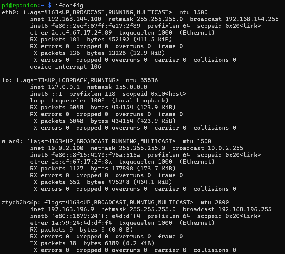

When I connect via wifi: rpanion, I am able to ping 192.168.144.119 successfully and receive the video stream using gstreamer
However, when I do not use the wifi connection and instead connect via ZeroTier, I can no longer ping 192.168.144.119.
I am not very familiar with IP networking, so I am having some difficulty setting up the IP configuration correctly.These are the IP settings of the raspberry pi 5 that I am currently using.
Ok, great. Now try this one, so see if the h264 parsing is working correctly:
gst-launch-1.0 rtspsrc is-live=True latency=0 location="rtsp://192.168.144.119:554/main.264" ! rtph264depay ! queue ! h264parse ! avdec_h264 ! autovideosink
C:\Users\nguye>gst-launch-1.0 rtspsrc is-live=True latency=0 location=“rtsp://192.168.144.119:554/main.264” ! rtph264depay ! queue ! h264parse ! avdec_h264 ! autovideosink
WARNING: erroneous pipeline: no element “avdec_h264”

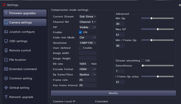

Viewpro camera setting - Encode Format H264, as shown in following photo:
That’s fine. Windows-specific issue.
I’m suspect there’s some issue with the Viewpro stream not being compatible with gstreamer on the RasPi. I’ve tested with a generic IP camera and it works fine.
Unfortunately I’ve not got a Viewpro camera for testing. I suspect there’s a setting somewhere in the Viewpro for a more compatible network stream … just may take some trial-and-error to figure it out.

Hi @stephendade .Based on your suggestion about Rasp boards, today I tested Jetson Orin with a Viewpro gimbal using Rpanion Server v0.12, and everything worked smoothly without any issues.
Thank you for the helpful advice
