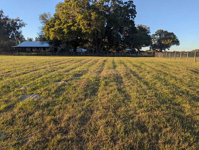

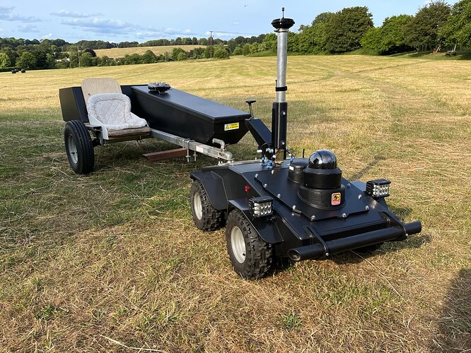

To All,
Just dropping everyone a line to say thank you for all the help you have given me over the last two years. In particular I would like to thank @Yuri_Rage who always seemed to pick up my questions and offer superb helpful advice.
I can now mow my paddocks with superb repeatability!
Please see short video below.
Cheers,
Martin

Was there a build thread for this?

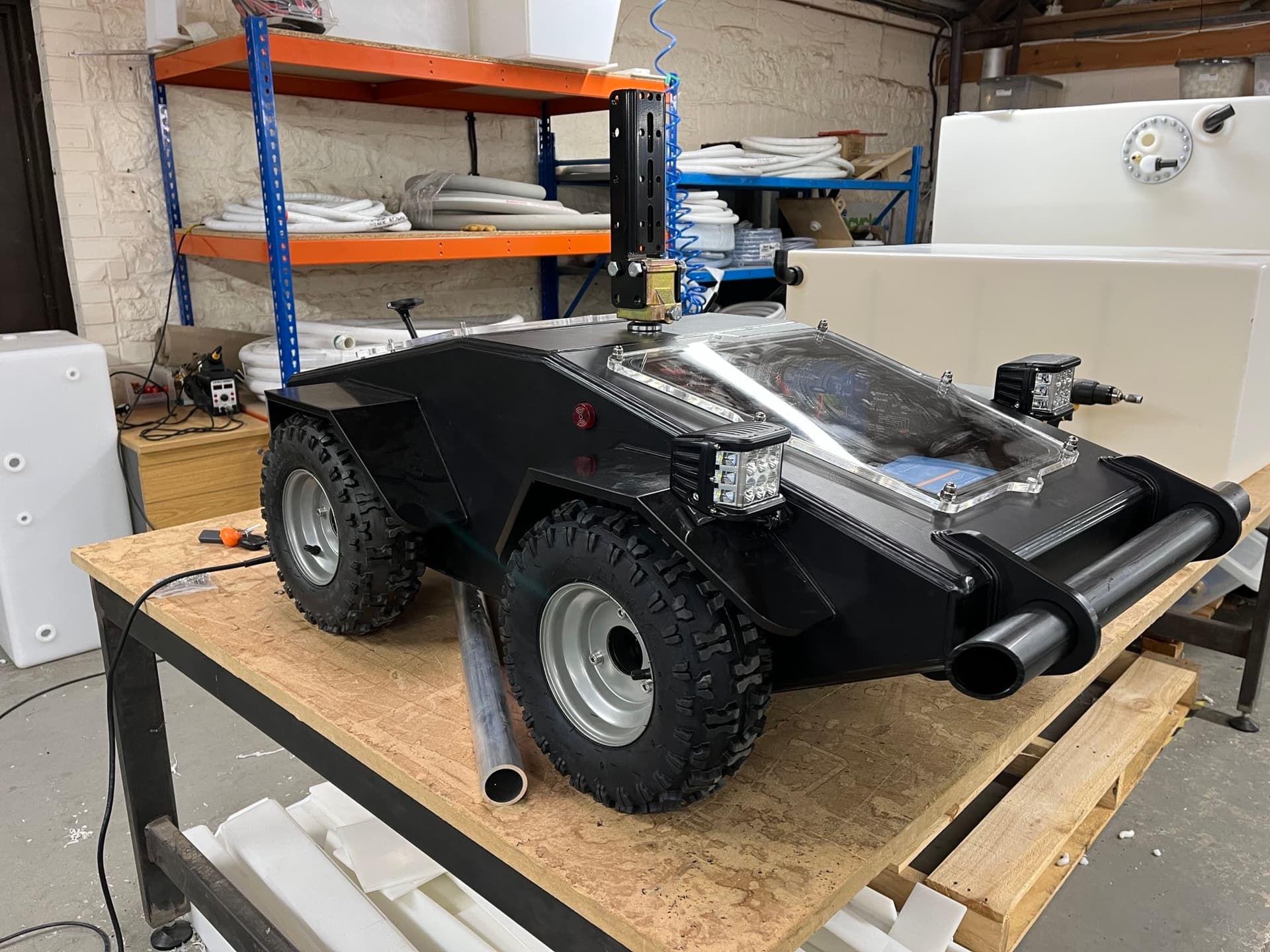

What vehicle is that???

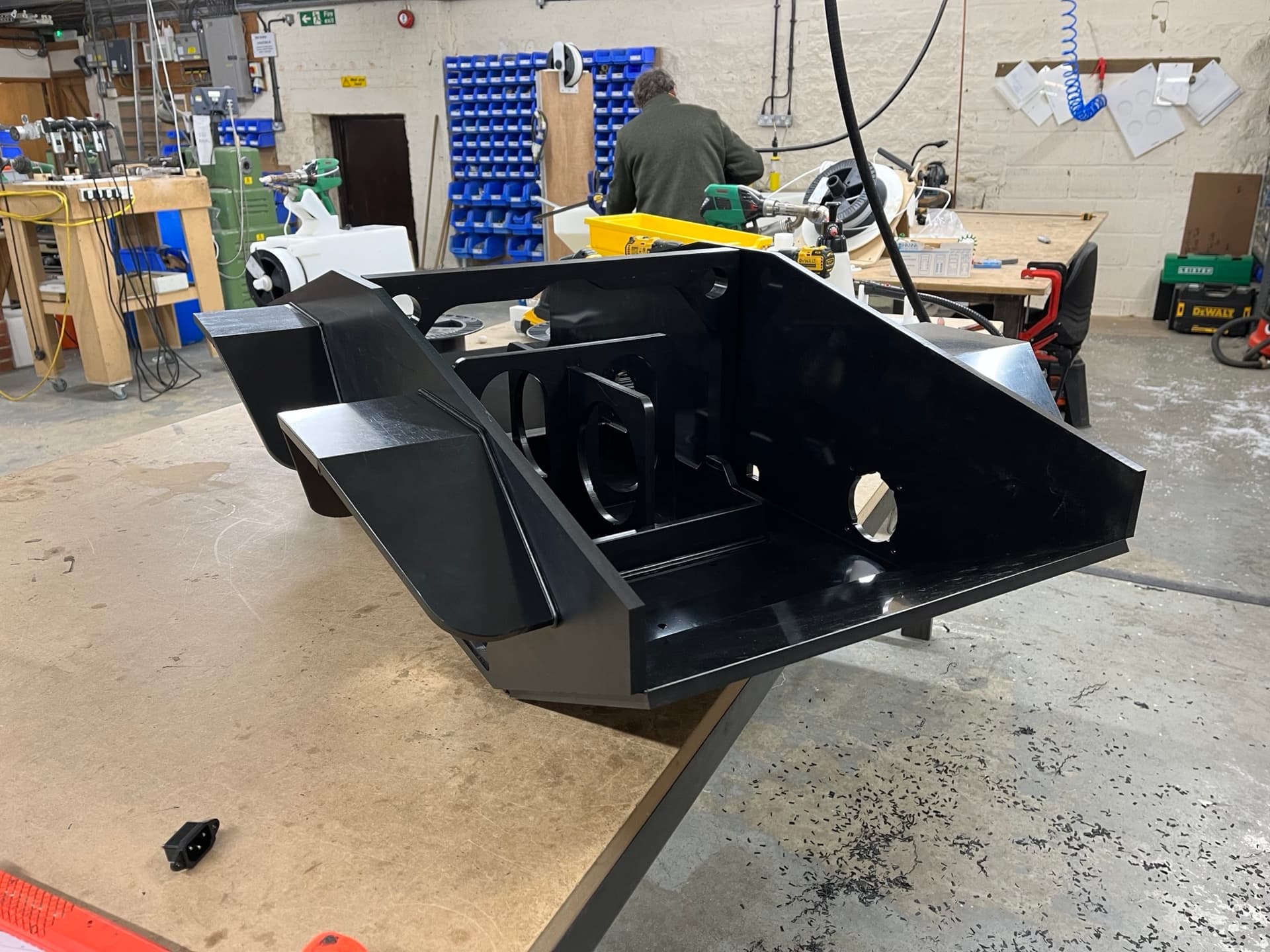

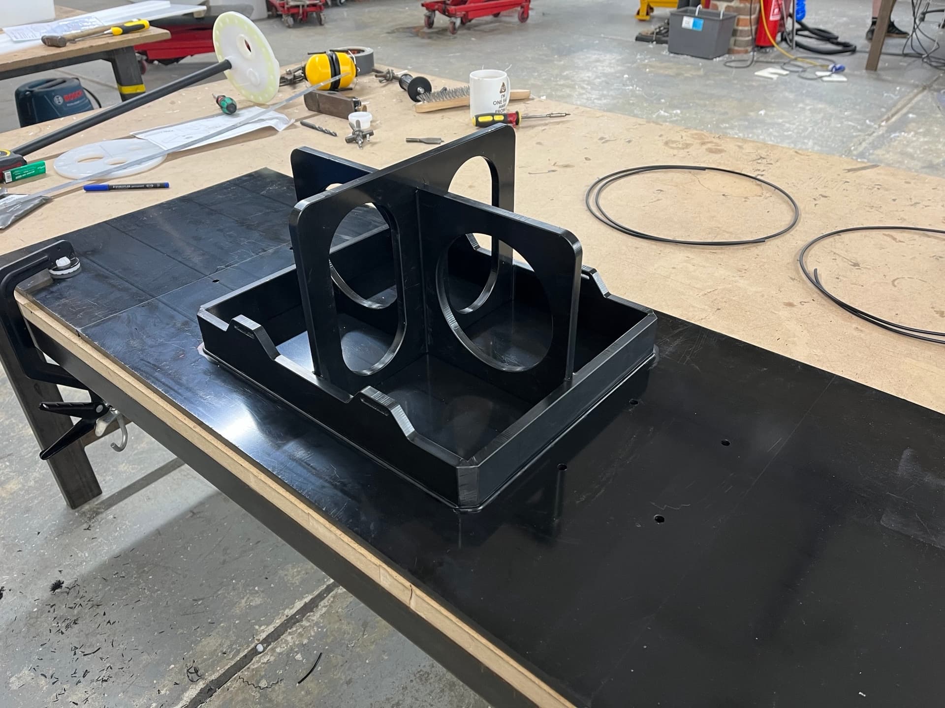

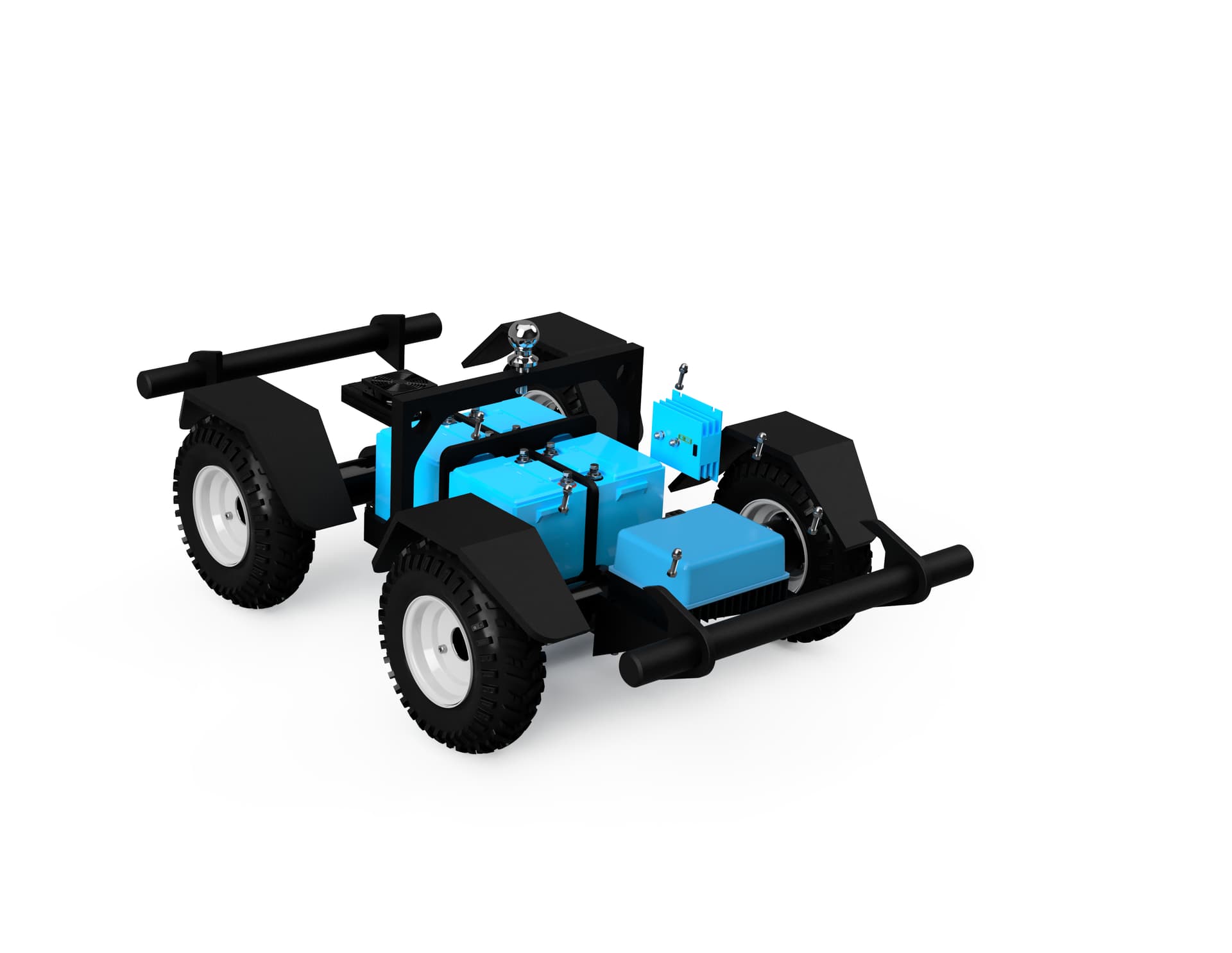

Very nice!! Love the puller! Need more pics please.

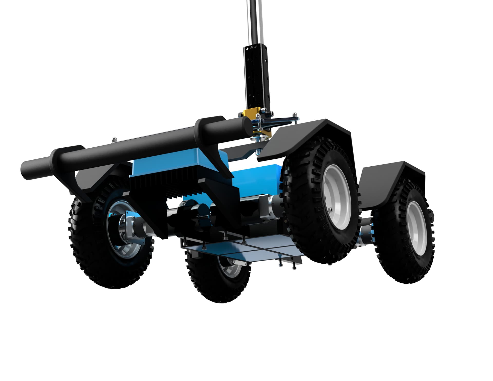

Joshua, Hi,
It is my own design from fabricated HDPE 12mm sheet.

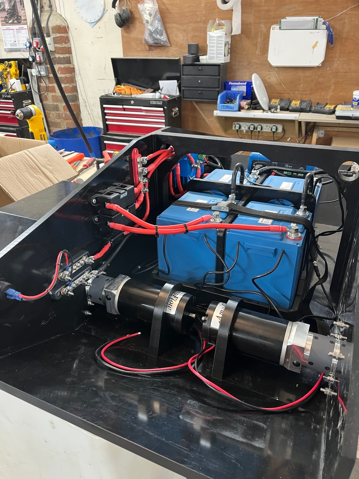

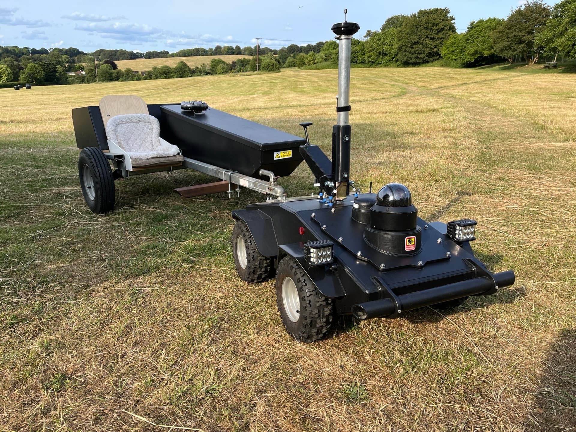

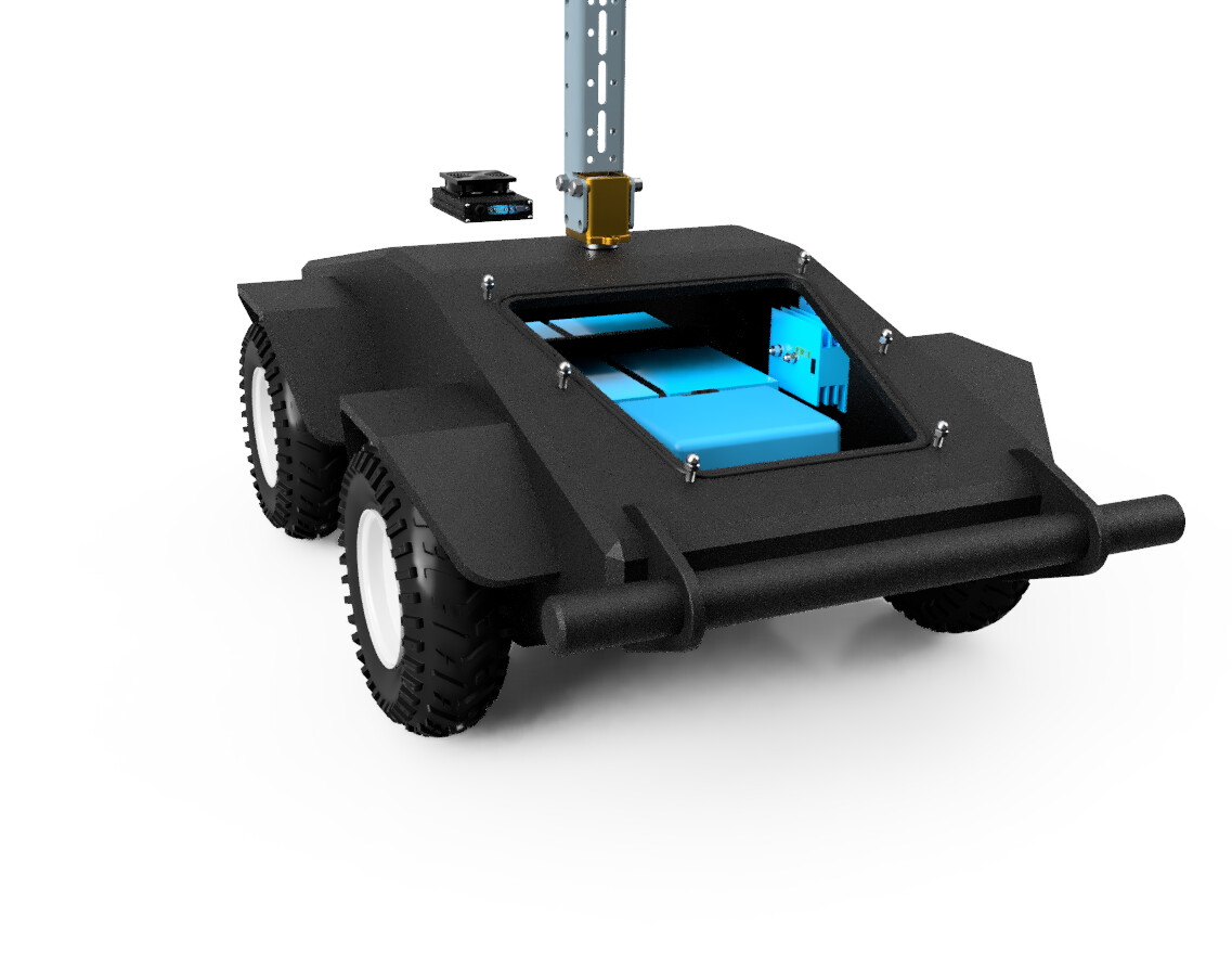

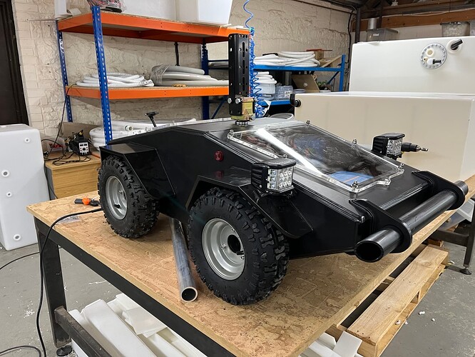

Here are some pictures of the design and build.
Wow! Very nicely done!
Nice! Thanks for the detail pics-
You can tell you work with plastics as a day job!

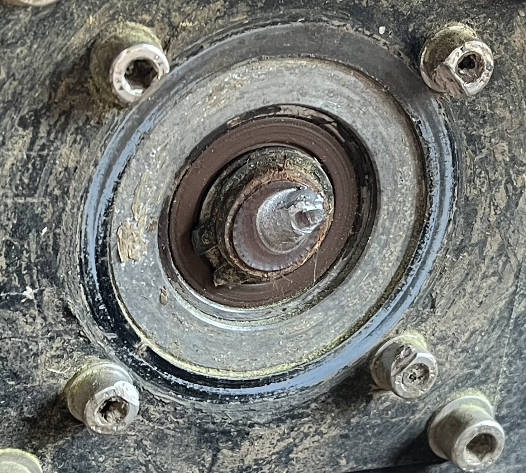

How do you like the ampflow motors (what size)? Are those planetary reductions (ratio)?
its very tidy, it looks like a retail product.
@binfordw I have been building water, waste and fuel tanks for the marine industry for 30 years so have a good understanding of what you can do with PE.

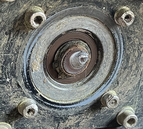

The Ampflow motors have been excellent other than two snapped shafts on the gearboxes. These have both been on the rear right when towing from the rear tow ball. The stepped shoulder has been machined with no radius hence it fractures with a lot of weight on it. I will be changing/trying their larger diameter shaft motors with chain driven reduction on the next version. The gearbox is the 1:32 version with the part number E30-400-24-PR32.
