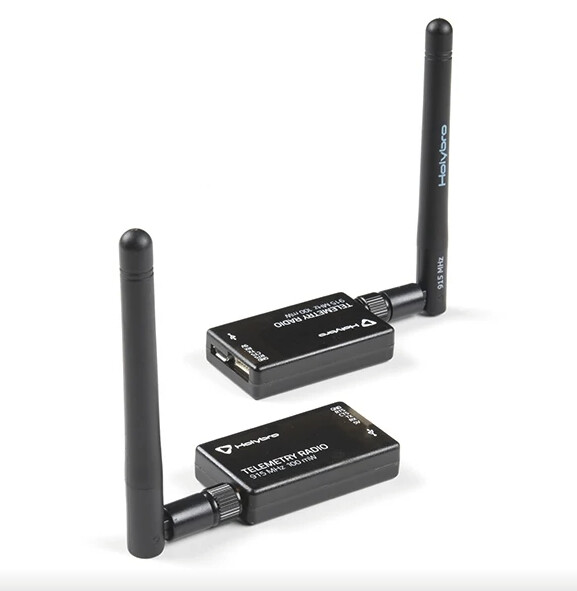

  1. I don’t currently have a radio telemetry setup. I don’t fully understand this part. If I run Mission planner on PC, what method is used to connect PC to rover without the need for USB? Can one of the common telemetry radios run off of PC? I used Wifi- and later, 4G for my previous setup, but that was with a RPI on the rover.

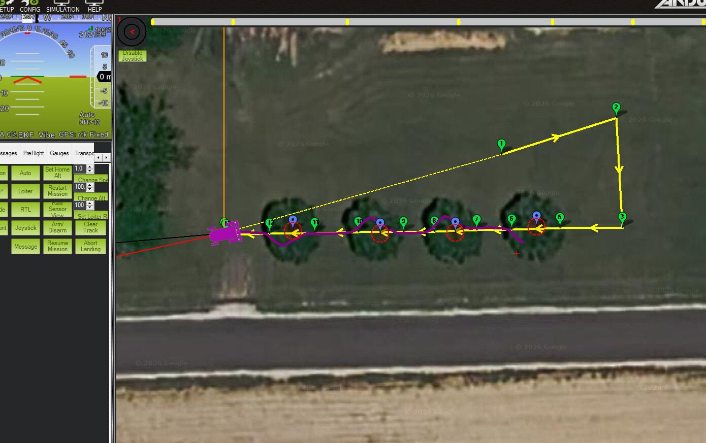

Trying to figure out how I would plan the mowing paths- and how to deal with obstacles.
I’m trying exclusion fencing- and seem to have a fairly decent result going. I’ve tweaked Fence_Margin, OA_Margin_Max, and OA_Type in all different ways, trying to see what effects it had. I don’t seem to have good control of how far away it stays from the fence circle. I have had to place waypoints at close proximity to the fence to get the results I am aiming for. Without the extra waypoints, the rover veers off way wide, and stays wide until it has sight of the next WP, and stays more or less a straight course to that WP.
Any tips here to improve this? Any Param’s I should be looking at?
In this pic, its pretty much what I would expect possible, but Ive had to add WP’s to get it to work. Is this the best method?
Most telemetry radios (such as SiK-based ones) will have a USB connector at the “ground” side for connection to the PC. It then appears as a standard serial port.

A quick search shows what you mention with the USB. (Also documentation explaining this on Ardupilot in detail was found :slight_smile: ) I was picturing Telemetry radios that Ive seen that clip into the RC transmitters. I guess my next Q would be- How do people get Telemetry to the RC transmitter AND a GCS at the same time?

The image was from Sim. I assumed Sim rover was “properly calibrated.” I am just looking to get desired pathing and understand it in sim, before I attempt to do the same with my real rover. Are there limitations to sim I should be aware of?

Typically, the telemetry and RC are separate systems/protocols. There are some systems (such as Herelink RC/HD Video Transmission System — Copter documentation) that do both.

The sim should be decently calibrated. If you can post the waypoints and params you used, I can take a look.

I’ll recreate the OA setup I was trying and post the files shortly. I’ve tried quite a few setups both on my pc here and at home, just looking to learn what the changes effect.
