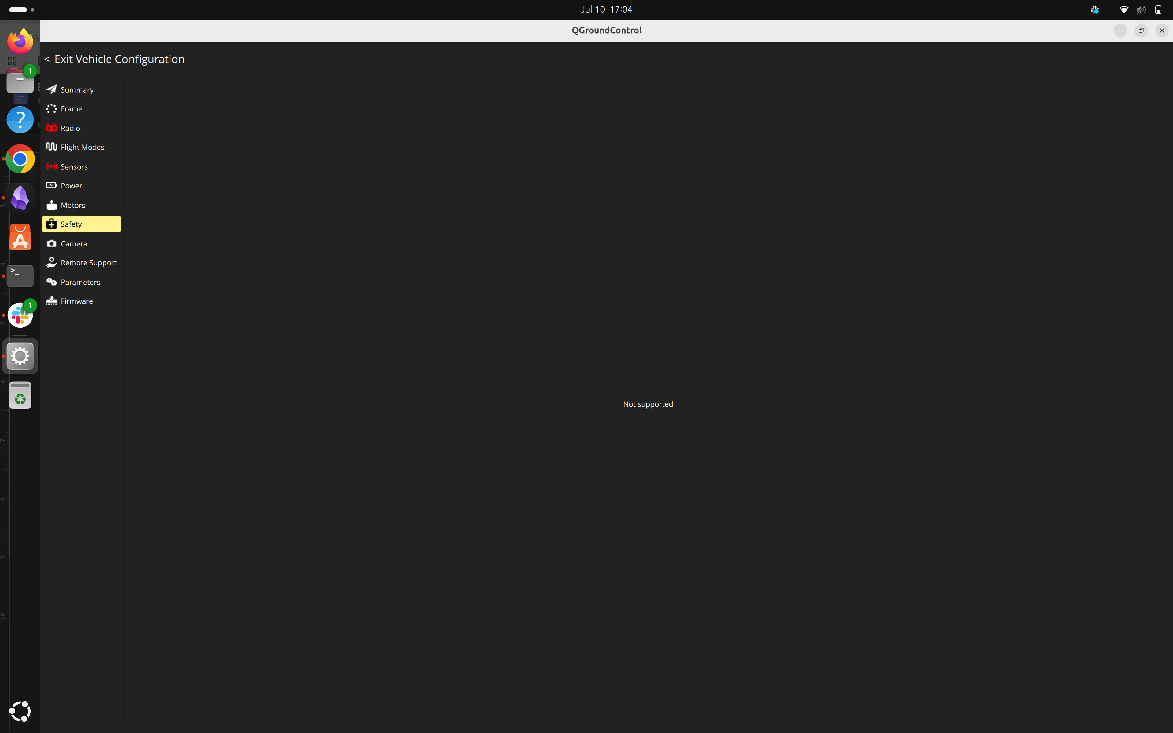

I’m controlling a Pixhawk (with a Jetson companion computer) using QGC. If that connection breaks, I want the Ground Control Station Fail Safe to occur.
I set the appropriate params:
FS_ACTION 5
FS_GCS_ENABLE 1
FS_GCS_TIMEOUT 5.000000000000000000
SYSID_MYGCS 255
But the Pixhawk fails to disarm after I quit QGC. I think the main issue is that the safety page shows “not supported”.
Any idea what’s causing it to not load?
Test it with mission planner. That is a QGControl issue, not an ArduRover firmware issue.
You’re right. Rover has a safety page in QGC, but not boat. Nonetheless, when I connected the Pixhawk to Mission Planner, and then quit Mission Planner, the GCS FS also didn’t execute. I used the exact same FS params with Arducopter, and it disarmed. Is this a bug with Rover? @rmackay9 @gmorph
Copter and Rover are not equivalent. FS_ACTION,5 should disarm. Do you have another MavLink stream active?
This likely has nothing to do with QGC.
See:
I had no RC but enabledFS_THR_ENABLE. So as soon as the flight controller booted, a FS_THR occurred which prevented FS_GCS _ENABLE from functioning properly. DisablingFS_THR_ENABLEfixed everything.
