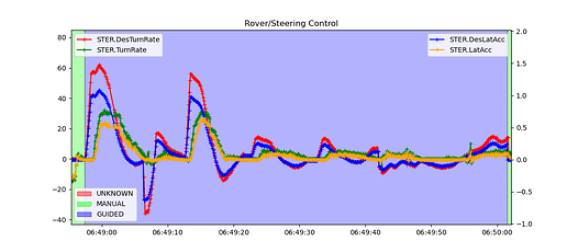

Your steering tuning appears to be pretty bad:
The difference between the red (desired) and green (actual) turn rates show that a) There’s a lot of lag in the steering system and b) The maximum turn rate of the vehicle is around 30 degrees/sec, which is far less than the 120 degrees/sec you specified in ATC_STR_RAT_MAX.

Trying to recreate that chart - can you give me some tips? Where do I start - Data Logs, web tools? Thx in advance…hoping some “canned” charts make their way into the arduniverse…

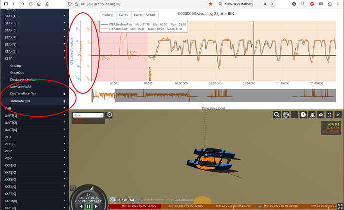

That was from the binlog. You can use plot.ardupilot.org and plot the STER.TurnRate and STER.DesTurnRate fields to plot the actual vs desired turn rate:
(I used MAVExplorer Using MAVExplorer for log analysis — Dev documentation, but the plot website is a little easier to use).

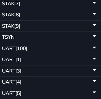

Spoke too soon - STER not showing. Wondering if I need to turn on some additional logging…hmmm
It is if you actually look in the .bin log Steering is logged by default.
Dave - apologies as I haven’t worked with many of the analytical tools - load the .bin into what? MP? One of the web tools? Struggling…cd
Ah OK, didn’t mean to sound like a jerk :slight_smile: @stephendade is using UAV Log Viewer and I am using Mission Planner
Look at the LOG_BITMASK parameter and check the “Steering” is selected (Complete Parameter List — Rover documentation)
Twas it. Just in time for some lightning in my area…sigh. Will test tomorrow, but the bitmask didn’t have STER selected. Have a great weekend…
