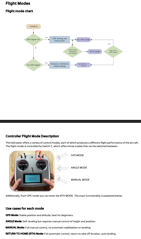

I have a group on FB about Roban RTF GPS Helicopters and very often someone asks if there is a way to start the motor and take off without GPS lock. That’s because sometimes pilots keep on waiting for several minutes for a GPS lock, sometimes no lock at all and it is frustrating. I don’t know if just eliminating the GPS mode under flight modes on Ardupilot will do the trick, I am guessing that would be a Firmware problem? Be able to take off on ATTi or Angle modes without GPS lock would be awesome.

However looking in the manual for these roban helicopters I found this
It seems to both directly answer your question and have some more details on what each setting on the flight mode switch does. There is even more info about flight modes on page 29 of your manual if I’m looking at the right manual.

I appreciated the info I got via email, I have studied the Roban manual, unfortunately their manual information is wrong, they have 4 helicopter Models and all with X2 or 407 flight controllers, they all have the same mechanics etc and TX programmed the same, so the models are basically the same. What they got wrong in the manual is, you will not be able to arm the motor without GPS lock, either in Angle or Manual modes. Thank you for your assistance!
the Chart showing that one can start without GPS is bogus, FC will be bilking blue waiting for GPS lock, and if not locked none of the flight modes will arm. They also got all the LED colors chart wrong in their manual.
