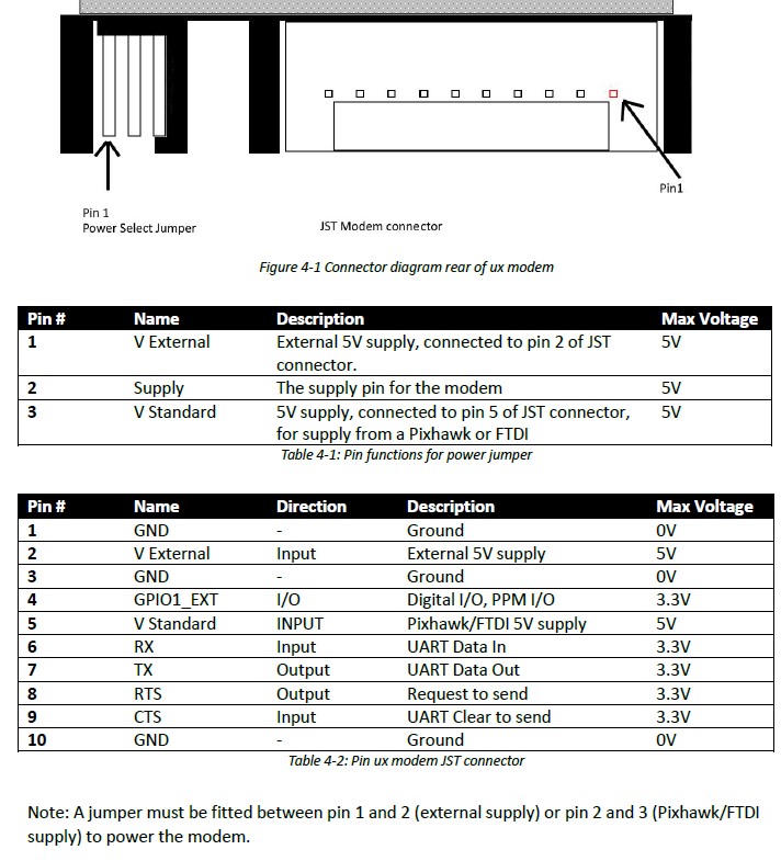

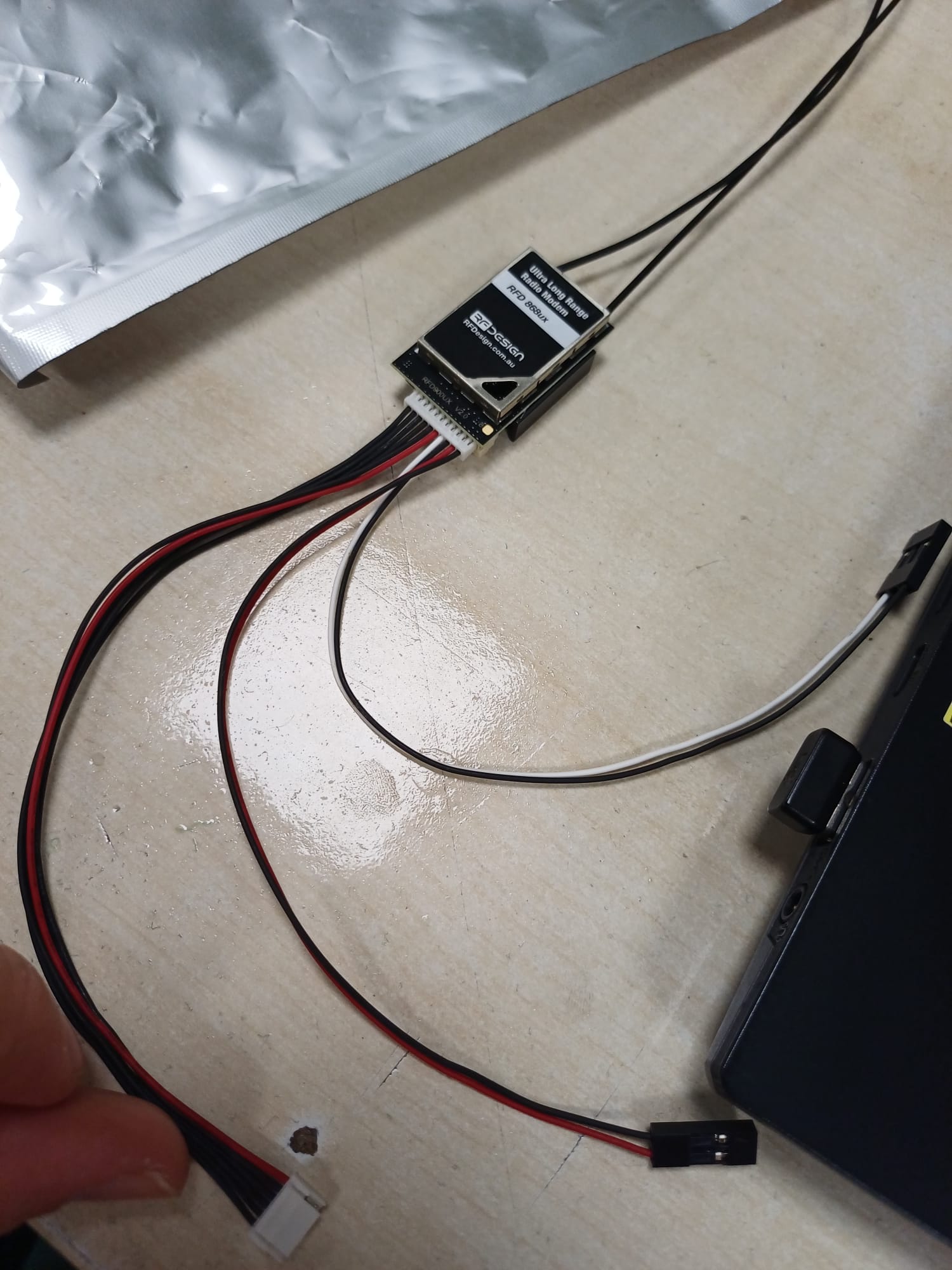

Apparently, I have to provide 5V from both the telemetry 5V pin and the power supply cable. I’m actually a bit confused about this part.I did a flight today without cutting the 5V wire of the telemetry cable. I drew 5V from both the telemetry port and supplied 5V from an external power supply via the power cable. Everything went fine during the flight, but would it be better if I supplied 5V to both the telemetry port VCC wire and the power cable?

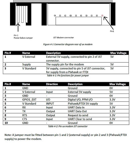

I think you are referring to pin 2, which is the 5V external supply going to the 2-pin connector (lower right corner of your picture), and pin 5, which is the 5V supply wire on the 6-pin connector (lower left in your pic).
The tiny jumper on the modem allows you to choose which of the two pins are used for power.
For your application, you should have only the external power supply connected to a BEC on pin 2 and the jumper connecting pins 1 and 2 of the jumper pins.
With the 6-pin connector plugged into the telemetry port, pin 5 will have power from your Cubepilot Orange, but that 5V won’t go into the modem with the jumper configured as above.
In other words, you won’t have to cut any wires or unpin any connectors.
You never want to connect more than one source of power together without adequate protections (e.g., diodes).
ETA to add pic…
You likely already had the jumper in the right spot, but you should verify this.
You don’t want your Cubepilot to be the power source for the modem.
